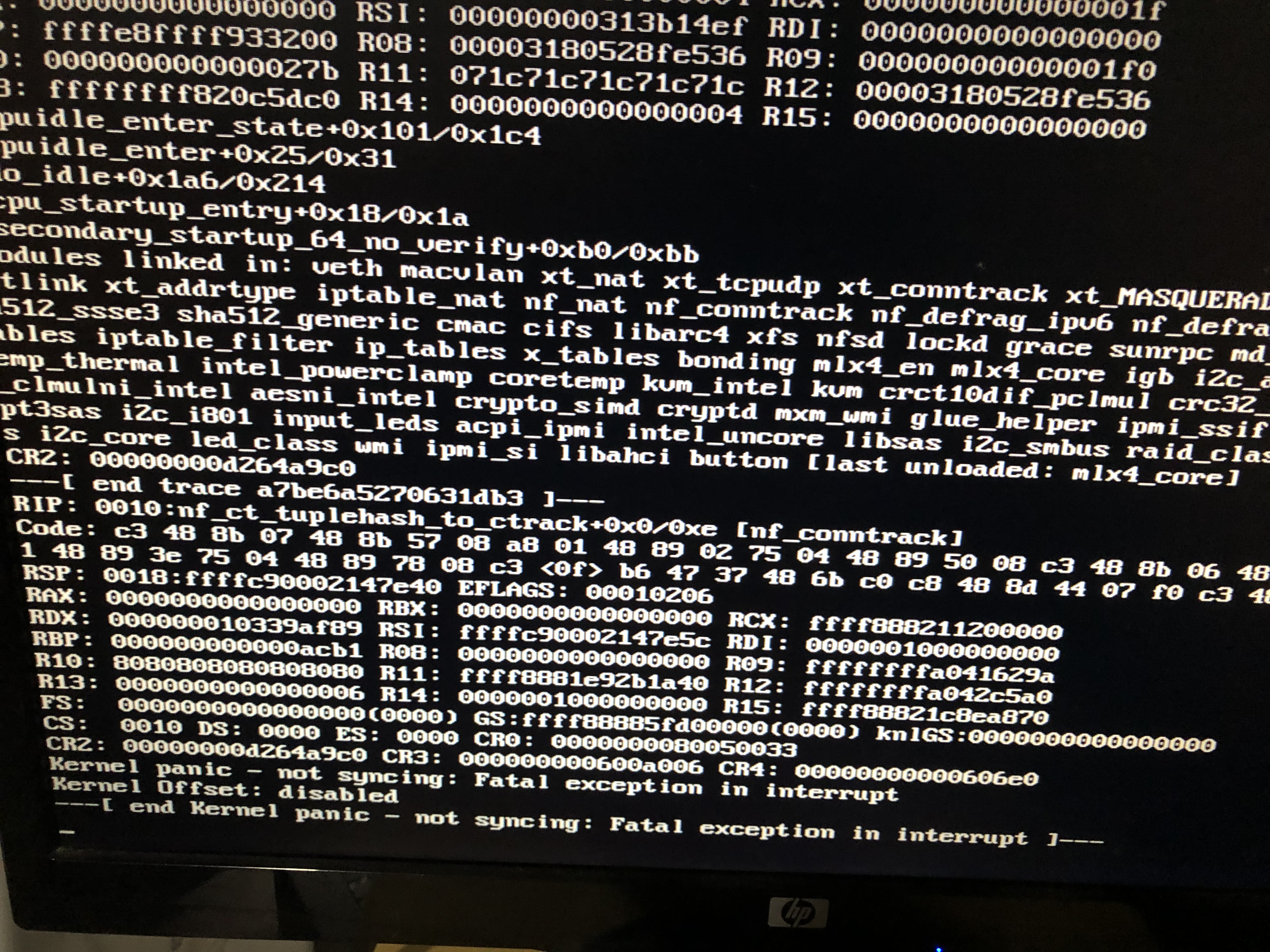

Server Crashed around 3:00:00 AM
Error Message from console
Kernel panic – not syncing: Fatal exception in interrupt
Kernel Offset: disabled
---{ end Kernel panic – not syncing: Fatal exception in interrupt ]---

I have attached a screen shot of the terminal below.
I rebooted the server and stopped the parity check. Deleted Docker image and switched to directory. Recreated needed dockers but only the ones using bridge for network. Disabled docker and rebooted the server. Server came up this time saying parity is valid. Rebooted the server again in an attempt to go full cycle and insure I had a clean prior shutdown. Server came up normal. I then manually run the mover. Once done, I started a parity check.
