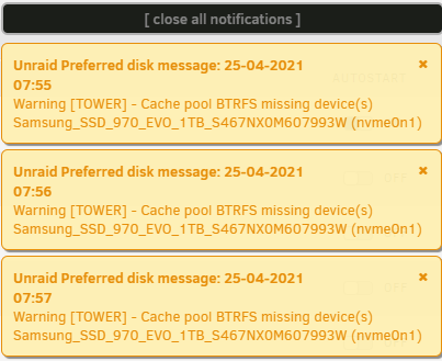

Then started some dockers - OK, started some VMS and then I had the error again - repeating every minute, just in case I missed it the first time:
Not sure what do do now. Can't check cables as there are none - the nvme's are in the motherboard.

Your getting device missing error s because now the other NVMe device (nvme1n1) dropped offline, look for a board BIOS update, this sometimes also helps:
Some NVMe devices have issues with power states on Linux, try this, on the main GUI page click on flash, scroll down to "Syslinux Configuration", make sure it's set to "menu view" (on the top right) and add this to your default boot option, after "append" and before "initrd=/bzroot"
nvme_core.default_ps_max_latency_us=0
Reboot and see if it makes a difference.
