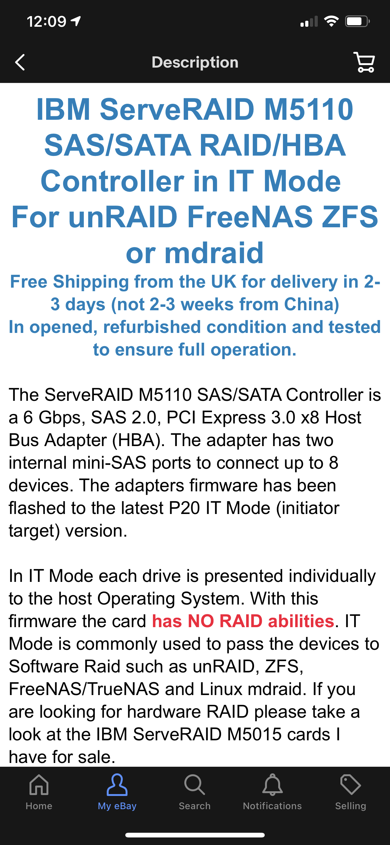

Am I correct then in saying that posts doesn’t recommend the M5110 flashed with the p20 IT firmware (which I bought from eBay saying it was good for unraid)?  The M5110 is pcie3.0  x8 as a minimal and gives me 2x miniSAS or 8x SATA
That's a very good option, and it doesn't require a PCIe 3.0 slot, it will work on a 2.0 slot, that controller uses the LSI 2308 chip, it's one of the recommended ones in the link above.
Great as the eBay person did seem very knowledgable and really really helpful.  But it does say it needs pcie 3.0.  But it sounds like you also know your stuff.
