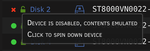

One of my disks are disabled and I need help to fix it.
A year ago I had UDMA CRC errors which I concluded where caused by a bent SFF-8087 cable, which I thought I fixed.
I couple of weeks ago I got the same error, and after a couple of days the drive was disabled. Now I have changed the SFF-8087 cable with a new cable, but the drive is still disabled. The SMART test I passed, and I don't understand the results of the xfs_repair status.
I am not sure how to proceed. Any help on how to fix the issue?

The only way to clear the ‘Disabled’’ staus is to rebuild the drive as described here in the online documentation available via the Manual link at the bottom of the unRaid GUI.
If you think the drive is fine you can use the option to rebuild onto itself.

Screenshot doesn't show whether the emulated disk2 is mounted though. That information would appear to the far right which you have clipped out. It would show "unmountable" with no size information in any columns if it were not mountable.
And your diagnostics do indeed show that emulated disk2 is mounted. You should be able to access its files as if the disk were actually being accessed, but it would really get the data from the parity calculation by reading all other disks.
