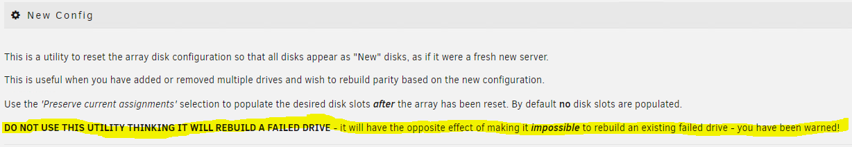

New config is not used to rebuild disks:
Also, parity can't help with a formatted disk, since it's updated in real time, and trying to rebuild a disk after a format will just rebuild the formatted disk, you'll need to try UFS explorer or a similar data recovery program.
