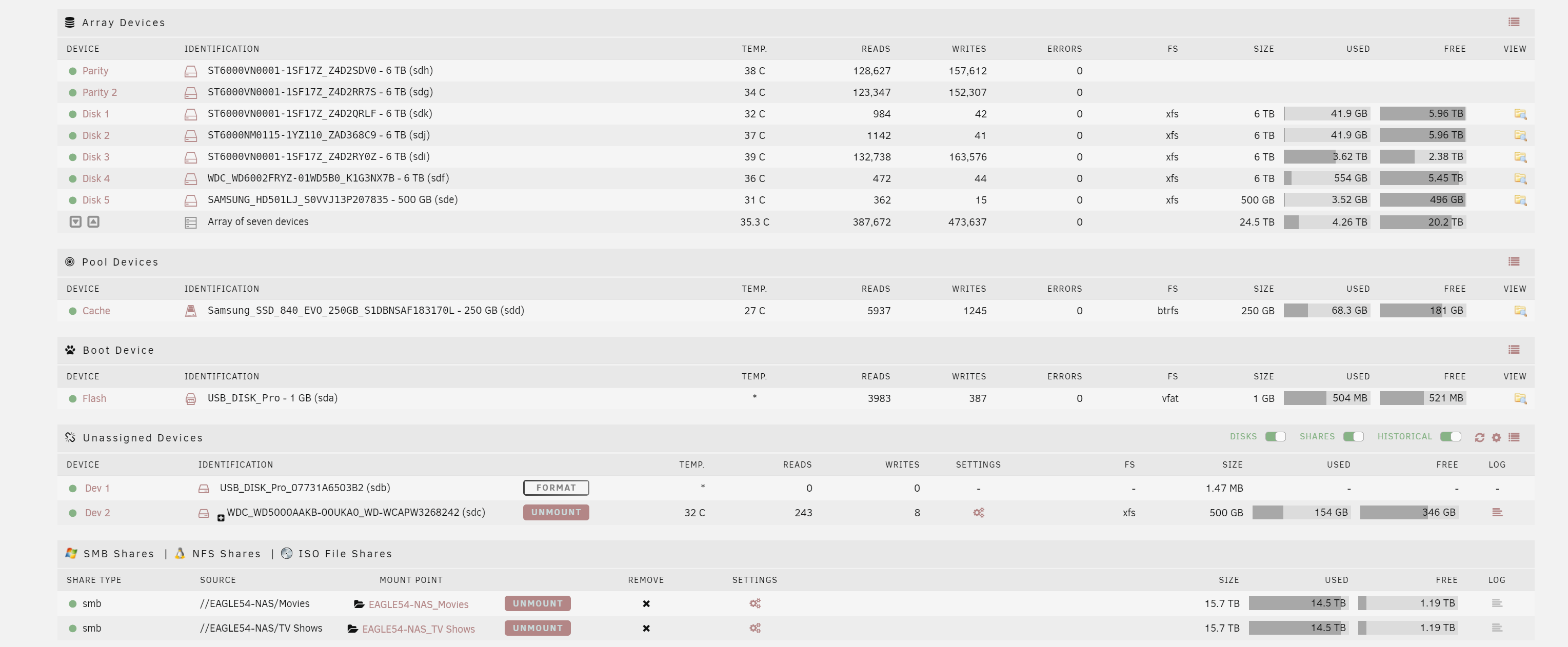

Hello, on drive 3 - I have 2.5TB free on a 6TB xfs hdd.

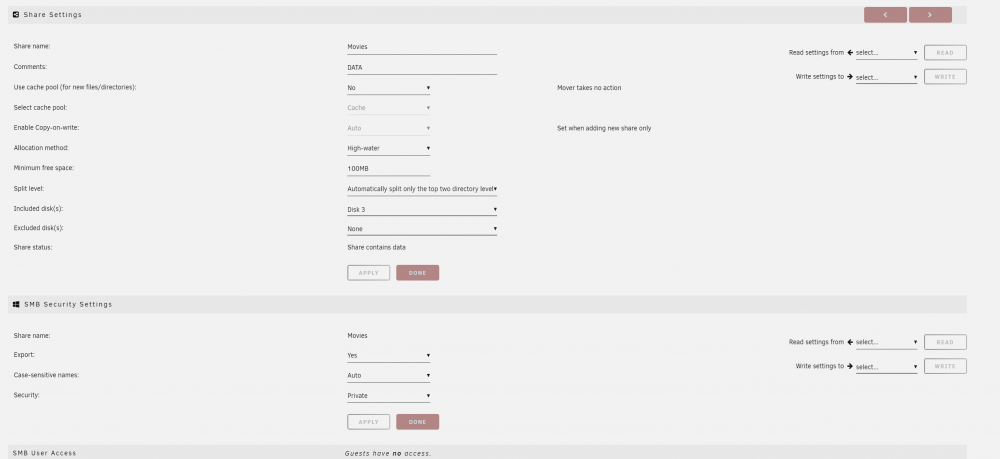

I have a share called "Movies" it only includes disk 3 and as a minimum set at 100MB (changed from 0kB)

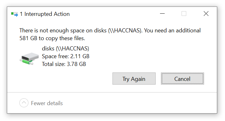

I am trying to copy files from SMB (513GB and it is not able due to not enough free space).

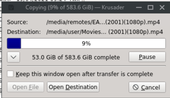

There is a post which says using Krusader may somehow double account storage.  Whilst backing up my QNAP - I decided to use Krusdar with a QNAP smb mount point, into the drive.  I am currently unsure if I went direct to disk3 or to the user folder > Movies.

The frustrating this is Krusader allows me to still copy the 513GB to the hdd through User > Movies from my QNAP SMB share).

I used unbalance to move to disk 2; I then erased and formatted disk 3.  I shared disk 2 and 3 and now have 1.81TB free on disk 2m and 3.14TB on disk 3.

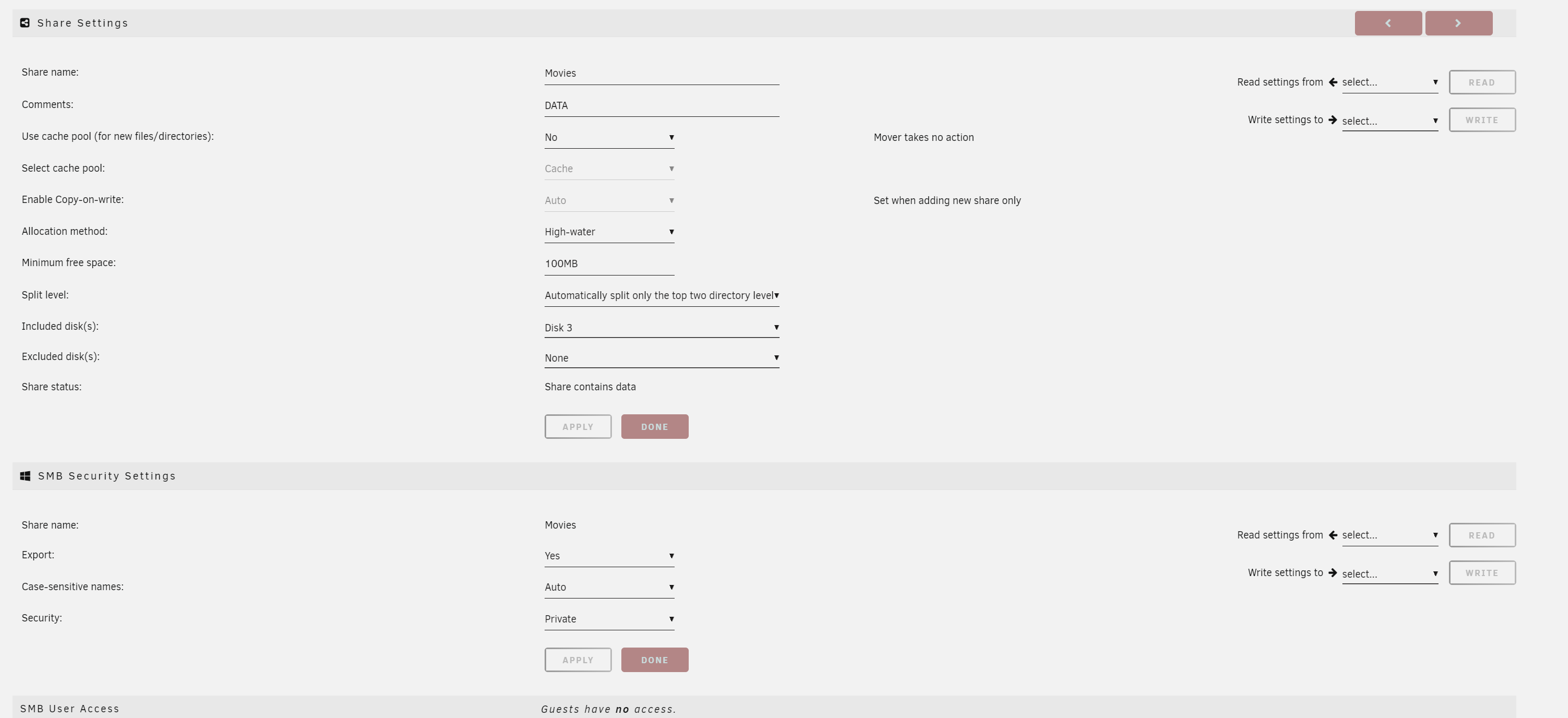

The only change from my share above is that it now includes DISK 2 and DISK 3.
*** UPDATE *** when i map the share directly it works, i was using one called rootshare which was made in my SQL.
Could this make a difference? I tried it a couple of times and get the same error through that share.
