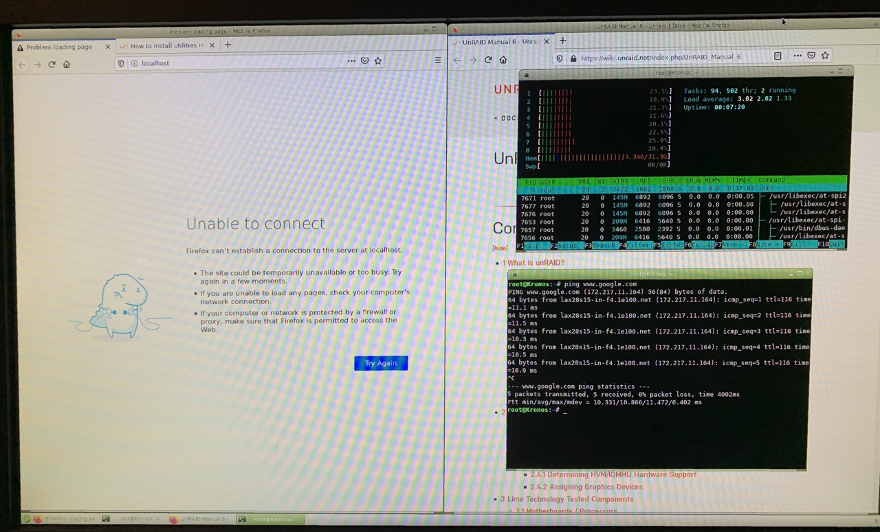

Here's a screenshot of the built in GUI on the tower itself. It can't access localhost at all, but it can access anything else on the internet.
Could the issue possibly be caused a rouge docker container? The server had been up about 30 days before this restart and issue took place. I did install a few containers in that time frame.
