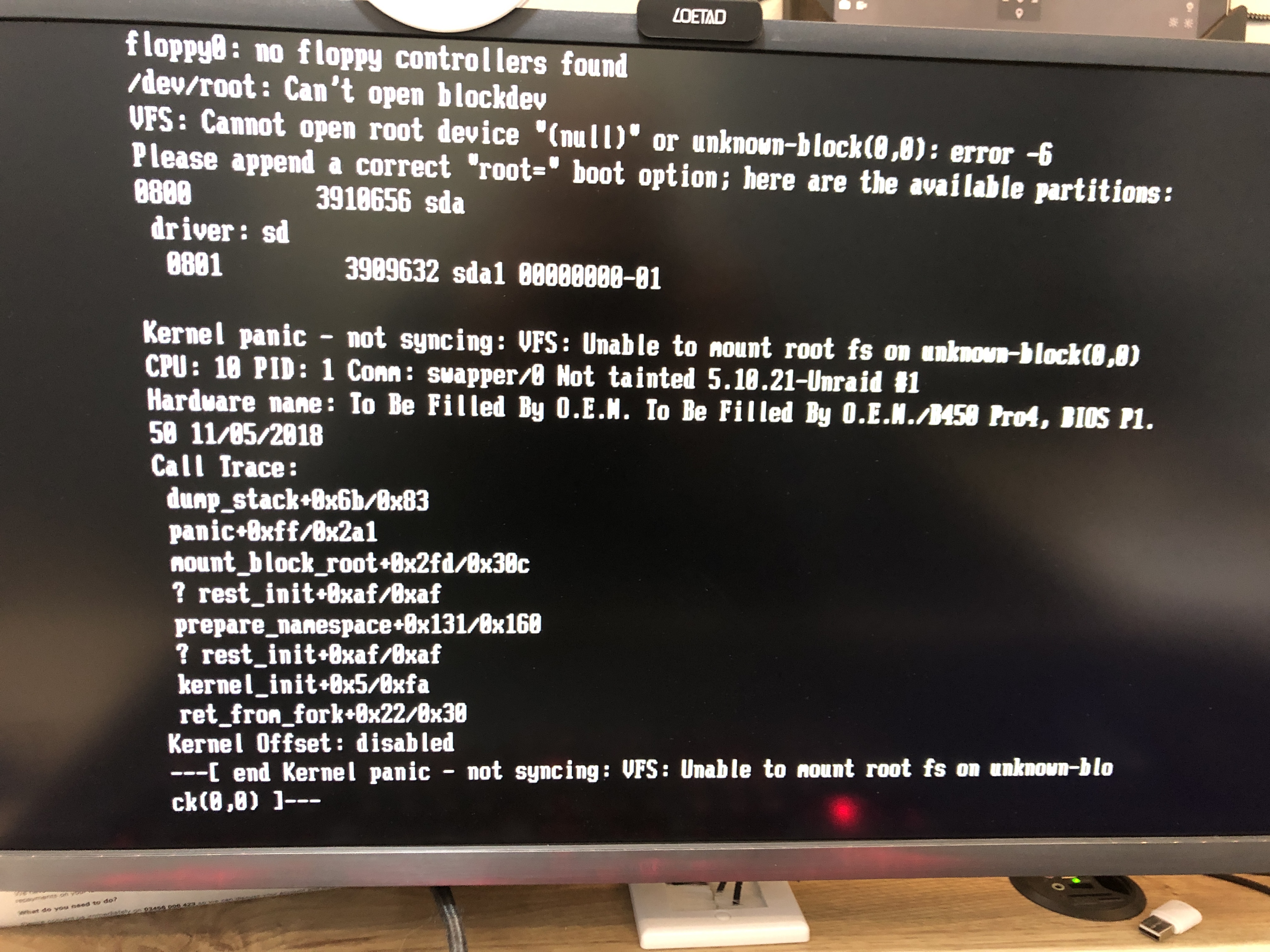

I rebooted my system this morning as i needed to move the tower over on my desk and didn't want to disturb the drives etc.
On reboot I have been greeted by the below. It has been working faultlessly for over a year before this.
Any ideas?
Probably means there is a problem reading from the USB drive.
it might be worth backing it up and then rewriting its contents.
Welcome to the club :(
Had the same problem a month ago and couldn't find a solution. I tried erasing the USB drive an restoring the content. I even tried a complete new USB drive, nothing worked.
I reseted the BIOS settings and checked the Memory with memtest86 without any issus.
Because the mainboard I used was pretty new, I returned it and ordered a new one, pluged in the USB drive and everything was back to normal. I not quite sure, that the mainboard was the problem and avoided a reboot since then for 2 month.
If you can find a solution, I am very curious about it. Good luck!
BTW: No Ryzen system here, i3-10100, so no AMD issue
