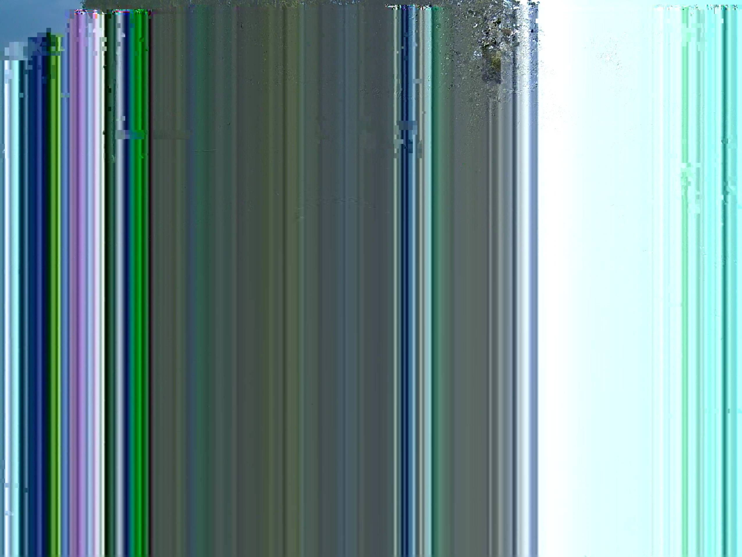

I've been trying several CCTV docker containers (Shinobi, MotionEye, Zone Alarm and Frigate) and I have the same issue with all of them.
Randomly, my video stream seem scrambled and messy (see attached) and when I have a look in the logs, I get the following errors:
[h264 @ 0x562cc0734d00] left block unavailable for requested intra mode
[h264 @ 0x562cc0734d00] error while decoding MB 0 4, bytestream 954579
[h264 @ 0x562cc0734d00] error while decoding MB 0 114, bytestream 16535
[h264 @ 0x55fa44f00d00] error while decoding MB 158 17, bytestream -31
[h264 @ 0x55fa44f00d00] cabac decode of qscale diff failed at 109 2
[h264 @ 0x55fa44f00d00] error while decoding MB 109 2, bytestream 1134689
[h264 @ 0x55fa44f00d00] error while decoding MB 104 5, bytestream -9
[h264 @ 0x559eba2b6d00] error while decoding MB 115 13, bytestream -20
[h264 @ 0x559eba2b6d00] cabac decode of qscale diff failed at 19 66
[h264 @ 0x559eba2b6d00] error while decoding MB 19 66, bytestream 27113
[h264 @ 0x55dc86788d00] error while decoding MB 144 2, bytestream -31
[h264 @ 0x55dc86788d00] cabac decode of qscale diff failed at 55 50
[h264 @ 0x55dc86788d00] error while decoding MB 55 50, bytestream 40441
[h264 @ 0x556c09134d00] error while decoding MB 54 17, bytestream -21
I figured out that the only thing those containers have in common is that they use FFMPEG to decode the RTSP stream.
I also googled those erros and they seem related to FFMPEG as well.
So is FFMPEG part of the Unraid core and is there any way to fix/update FFMPEG?
If no, how could I fix that?
Thanks!
No.  It's in the container(s)
Thanks for the feeback
After some further investigations, I found out that it's related to the Reolink Cameras I use.
It's recommended to use a RTMP stream instead of an RTSP.
For those who may have the same issue, here is the link format for RTMP streams on reolink cameras:
rtmp://IPADRESS/bcs/channel0_main.bcs?channel=0&stream=0&user=USER&password=PASSWORD
