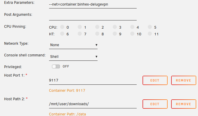

I have followed Spaceinvader One's video describing how to route the network traffic of one container through another on my Unraid 6.9.1 installation. Specifically, I have routed my binhex-jackett container traffic through my binhex-delugevpn network. To do so I first edited the jackett setup
  1. Network type from "Bridge" to "None"
  2. Added Extra Parameters: '--net:container:binhex-deluge'
Then edited the delugevpn setup

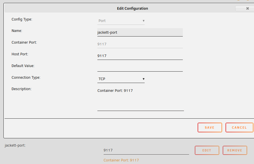

  1. Added new port utilizing jacket's (9117, 9117, TCP)

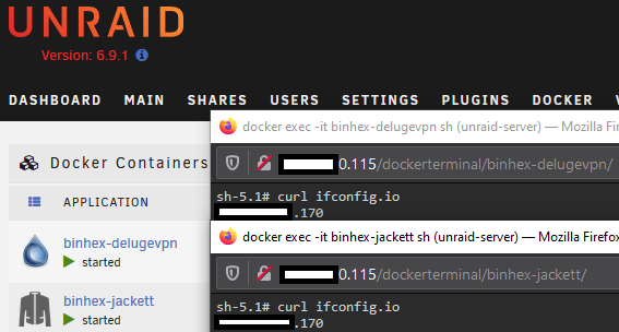

Utilizing Spaceinvader One's trick to view the container's IP with `curl ifconfig.io` I can confirm that both containers share the same IP address. I can also view the logs of each container and both are running normally (based on what I have viewed in the log outputs before).

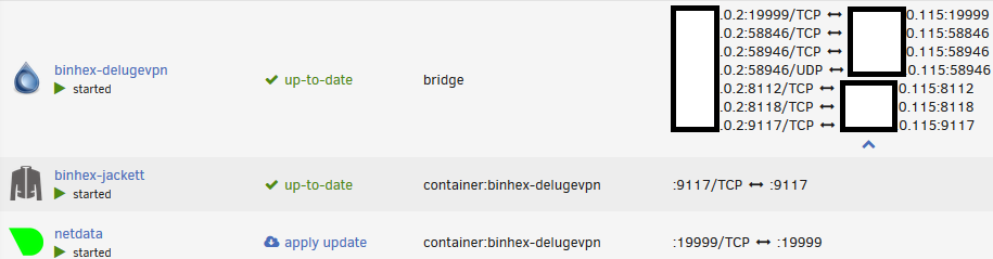

I have also performed the same steps to route another container's, netdata, traffic through the delugevpn container to see if it is just an issue with jackett. I can also confirm that it shares the same IP address and the logs "look fine". Though for either container if I navigate to my server's IP address with the specific port for a given routed container, the WebUI still does not load.

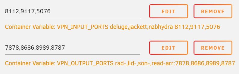

I have been going the same route and had some problems. Did you configure these ports in the binhex-delugevpn container config?
I missed this and was struggling until I had read and fully understood Q24-27 in binhex exelent guide:
https://github.com/binhex/documentation/blob/master/docker/faq/vpn.md
I did not have these parameters set, only the "extra" Port variables. After setting these it seems to be working better..
Though, what is the difference between adding the ports to VPN_INPUT_PORTS versus VPN_OUTPUT_PORTS. I see that you have 9117 (Jackett WebUI) as an input port but not output, but you also have 8686 (lidarr WebUI) as an output but not input. Why the difference for a WebUI port?
The distinction between VPN_INPUT and OUTPUT wasn't clear to me either, and I'm still not sure I understand this correctly :-$
But, what I empirically understood was that, at first when I only had jackett routed through delugevpn, I only needed to define input ports so that I could reach the jacket GUI. At that point I didn't need any defined output ports.
Then, when I added nzbhydra to the mix, I kinda worked also with only adding the the vpn input port. But, for nzbhydra to work as intended nzbhydra also need access to the arrs (and not only the other way around) and that did not work until I added the arrs' ports to VPN_OUTPUT_PORTS.
That made sens to me, and is how I now understand it. The VPN part of the variable name is actually confusing. It has nothing to do with the vpn function of the container. As I understand it the INPUT ports are where you define access to the containers on the binhex-delugevpn "net". The OUTPUT variable is where you define the ports that containers on the binhex-delugevpn "net" needs access to.
I hope that helped.
