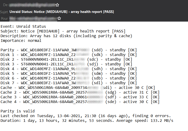

Do you have a recent array health report ?
Your disk assignement is included :

Considering that you had disabled drives, your diagnostics might help to guide you from there, please attach the zip to your next post. (Tools / Diagnostics)

Thank goodness, How do I access the health report?
It is a notification (Settings / Notification Settings) that informs you on a schedule of the status of the Array and the Pools.
I am not sure what is the default setting for that, if you don't know what it is, I suppose you don't have it activated.
