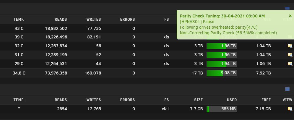

[Solved] V6.9.2 - Parity being paused because drive is overheating.

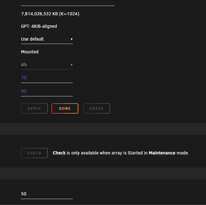

This seems to be something new to 6.9.2? - Cannot remember this happening before. They are shucked 8tb and do run hot. Have set the warning disk temp to 50c.
Anyone else seen this?

This is not an unRaid 6.9.2 feature but is a feature of the Parity Check Tuning plugin (as indicated by the notification).   It would give the same behaviour on a 6.8.3 system.
Note that the pause threshold is a setting relative to the Warning level set in unRaid so pausing at 47C if you have the temperature warning threshold set to 50C at the unRaid level suggests you have the plugin settings set to pause at 3C below that.
Ah, OK. I just never saw it before but bet I updated the Parity Tuning plugin at some time.
