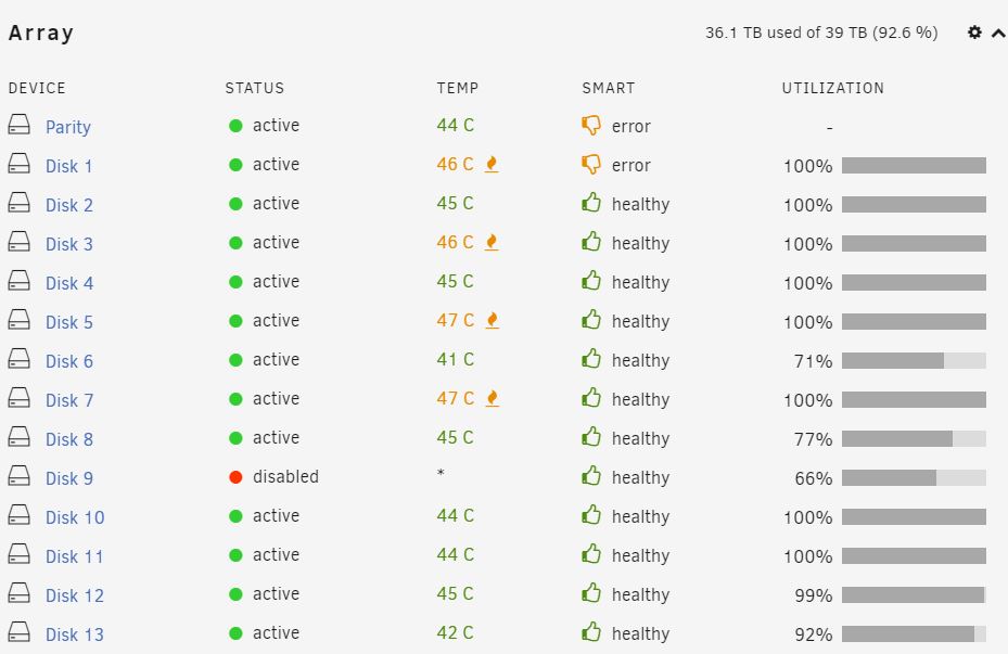

Sorry, this is a bit of a long post. The short version is:
(1) one of my data drives is currently disabled (since yesterday)
(2) my parity drive is showing a SMART error in the dashboard (but has a green ball on Main screen)
(3) one of my data drives is showing a SMART error in the dashboard (but has a green ball on Main screen)
I would really appreciate input/advice on the following:
(a) Are my parity and data drive that are showing SMART errors on the dashboard “okay”? If so then I can proceed to (b)
(b) What happened to my data drive (why did it become disabled)?
(c) What is the best way to rebuild my disabled data drive?
(d) MOST IMPORTANTLY – Am I at imminent risk of losing any (all?) of the data in my array?
I’m attaching the following:
(i) a screenshot of my dashboard showing the SMART error on the parity and disk 1 devices.
(ii) my syslog
(iii) log files for parity and disk 1
(iv) A file showing the PCI devices (not sure if this is useful)
This server was built for me by Greenleaf and has been running with no problems for at least a decade. I really appreciate any input/advice from the experts here. Thanks for any help you can provide.
The long story (with some more details):
This morning I noticed a disabled icon next to one of the drives on my dashboard. I recalled that when moving some items over to that particular drive yesterday I had some sort of communication blip (“network location not available”) – I skipped over the file and everything else finished copying. Then I went back and moved the last file over. That must’ve been when the drive became disabled. I say that because I was looking at the dashboard yesterday to see which drives had the most space. I’m sure I would’ve noticed the little x next to the drive in question showing it as disabled.
I made a rookie mistake of rebooting my server without first taking a syslog so I don’t have anything to show what went wrong (but the syslog I attached has data from yesterday so maybe it’s okay). My primary concern is ensuring no data loss (outside of what I’m willing to lose). The drive in question is a 3TB drive with a little over 2TB of data on it. There’s content on there that I was planning to get rid of at some point, but that’s the only data on the 30+TB array that I’m “willing” to lose. There’s a little less than 1TB of data on that drive that I actually need.
I would appreciate some advice on next steps. My inclination is to copy the data I want to keep onto either dropbox or the new HTPC I’m setting up. Copying that much data over may take a while, but it’s kind of a “set it and forget it” task. I can leave the copy task running and get on with my life.
Once I have all the data that I need copied over from that drive, my intention is to rebuild that drive onto itself. If it works then great, I can run a parity check and, if it’s successful, be happy with the server. If it fails then I can buy a new 3TB drive, preclear it, and rebuild the data drive on that.
I’m also thinking that, if there is some sort of issue with the drive and/or controller then the copy task will identify the issue (i.e. there will be some communication glitch and the syslog will help identify what’s going on).
I also found on the dashboard that two of my drives (parity and disk 1) have a SMART error showing. They both have green icons on the Main screen and are currently enabled. I’m wondering whether I should be concerned about this? Are these drives at risk of failing and, in combination with the disabled drive, taking out my whole array?
Thanks for taking the time to read (if you made it this far). Any and all advice/input on next steps would be appreciated. Thanks in advance.
syslog.txt ST3000DM001-9YN166_W1F07ZZC-20210501-1212 parity (sdo).txt WDC_WD30EZRX-00MMMB0_WD-WCAWZ2214731-20210501-1212 disk1 (sdc).txt System Devices - PCI Devices.txt
Definitely seeing a lot of reports for sas controller errors, drive errors, and so forth. Another thing I'm noticing is that system is awful hot. You've got warning indicators on your drives in the webUI and the temperatures I'm seeing logged in SMART are universally warmer than I feel is safe.
In fact, the WDC drive shows one uncorrectable error logged, and the Seagate shows eight, a marked failure for overheating, etc.. You have a serious airflow problem that may be causing overheating, and could easily be partly responsible for the failure now if it's been running like that for long.
I feel like RAM/CPU aren't quite as likely. Could also be power supply, but my money is on thermals.
AFTER you fix those temperatures (baking it while trying to fix it can't possibly help) the short end of it is, your disks are compromised. I can't tell if the WD is parity or the Seagate, but neither of them is 100% trustworthy from here.
My vote; Copy the important data off the drive that still lives, if possible, then hit it with a hammer if it's not under warranty. Then hit the other one with a hammer if it's not under warranty, since it was just your Parity drive and it absolutely cannot be trusted to do its job (if anything it's more likely to corrupt the data going onto a rebuilt disk if it's ever relied upon, if it's failing) and you should be okay.
Honestly I'd also be interested in a diagnostics.zip -- you can find that under Tools/Diagnostics, Download. That groups syslog, smart data, configuration info, and a bunch of other stuff for us so you don't have to attach individual items.
Hope that helps.
Next time please post the complete diags, they would include a SMART report for disk9, though it most likely dropped offline, in that case it should come back up after a power cycle (not just a reboot).
You're using a SASLP controller and those are known to drop disks without a reason, so disk9 could be OK, parity looks mostly fine, disk3 is showing a pending sector, but WD disks are known to show false positives, an extended SMART test will confirm if disk is good or not.

As expected there's no SMART report for disk9, like mentioned above the disk should come back up after a power cycle, also run an extended SMART test on disk3, then post new diags.
Thanks JorgeB. I power cycled and the SMART report for disk9 is now in the diagnostics. I'm attaching it for reference.
My next step is to run one or more extended SMART tests. I was planning to run on disk1 and disk9. You've also suggested I run another on disk3 - did you see something in the logs that looks concerning? Should I also run an extended SMART scan on the parity drive as well?
Am I able to run multiple extended SMART scans concurrently?

No extended tests were run on either, there are short tests, extended test should take around 8H on those disks.
Thanks JorgeB. Any idea why they would start running the self-test and not complete? Any idea why I keep getting a 404 Not Found error when I don't usually receive those? I'll try kicking off another extended self-test on disk9 and see how it goes.
Possibly the self-test stopped because I had a spin down delay of 1 hour. I set to 'Never' for now so hopefully the self-test will complete now.
According to the SMART reports they never started, or they should be logged as complete or interrupted.

You can find them in the SMART report, this section:
SMART Extended Self-test Log Version: 1 (1 sectors)
Num  Test_Description    Status                  Remaining  LifeTime(hours)  LBA_of_first_error
# 1  Short offline       Completed without error       00%      3966         -
That one passed, a failed test usually appears as "Completed: read failure" and an interrupted one as "Interrupted: host reset", also make sure disk spin down is disable, depending on the Unraid version it may interrupt the test.
I'm not sure what's going on. I'm on another computer and looking at the GUI it doesn't look like the self-test is running on disk1 after all so I'm not sure why the browser in my main pc is showing the self-test as 90% complete. Maybe I need to clear the browser cache? Perhaps I should just reboot the server and start the self test again. Is there any way to kick off the self test through telnet instead?
smartctl -t long /dev/sdX
To check the selftest status and/or log manually;
smartctl -l selftest /dev/sdX
If it's not obvious, smartctl is the Linux SMART swiss army knife.
