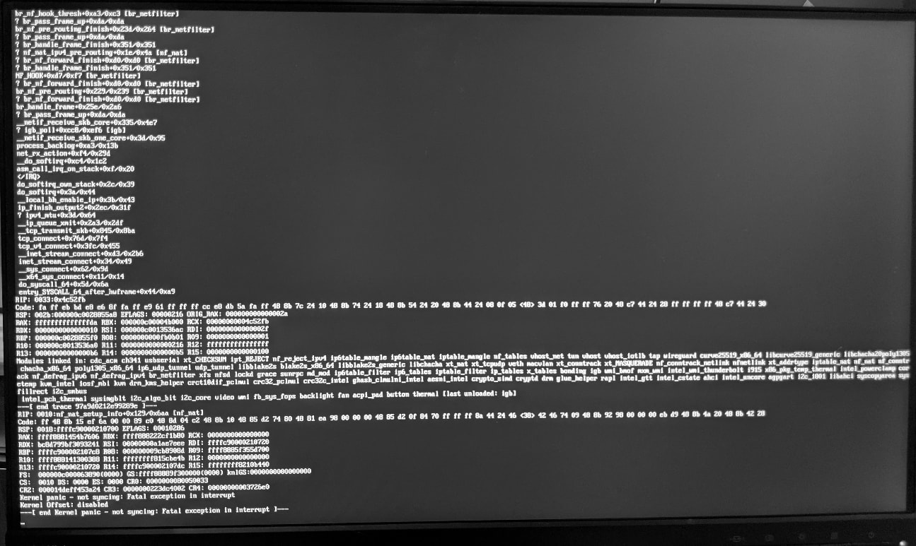

I keep getting kernel panics on my 6.9.2 server. I read about the docker macvlan solution, and I think I've done the suggested solution, if I understand it correctly. None of my docker containers got static IPs and my vlans (not br0) are also configured with dynamic IP.
I guess the kernel panic is sometime between May  4 03:40:51 and 07:16:31. It seems to be the pattern as I usually see the mover running at 3:40 before needing to reset the server in the morning.
Any clue on what's going on?

Thank you for the suggestion.
I disabled Host access to custom networks -setting. Hope it solves the problem.
