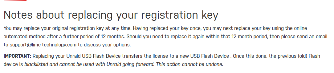

Have you read this:
      https://wiki.unraid.net/Manual/Changing_The_Flash_Device
Read through this section of the Manual/WIKI and pay attention to this section:
Note that doing a replacement of the .key file a second (or more) time(s) within a twelve month period is not that big a deal.  I have never heard of a reasonable request being denied.  It can take a few hours to a day depending on when your request is made.
EDIT:   One more thing.  Always make a complete backup of all your Unraid flash drives before you do any modifications to any Unraid flash drives.  (Murphy's Law:  You will never need any backup of data that you made in caution of something going wrong!)

While i can appreciate this, is there a simple way of just copying the contents of the Eval flash drive (which i assume contains all of the settings and configs for dockers etc) to the original flash drive with the license?
I know it does not seem like much but i'd rather not blacklist my usb drive for the sake of simplicity. im looking more at this as an exercise. but really want to get a clean install.
