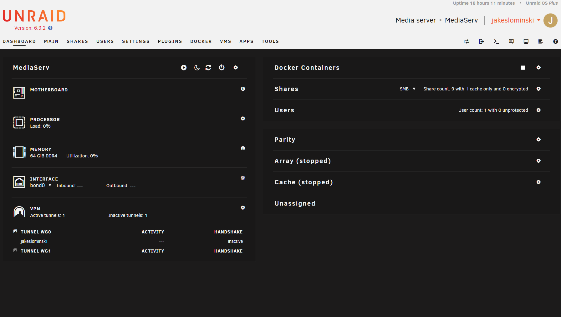

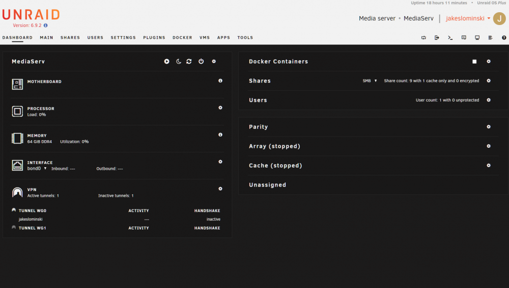

Not sure what I've changed ( haven't updated/installed anything in about 3 days ) but all of a sudden I'm having immense difficulties accessing the Unraid UI. No issues loading Main, Shares, Users, Settings, Plugins (feels a bit slower than normal and cannot update plugins, script wont run when I hit the button), Apps, and Tools. The Dashboard won't load completely (screenshot below), VM (sometimes loads, sometimes won't) and Docker tabs (will not load anything below the navigation bar at all) are all causing me a major headache. If there are any other logs (sys log below) or diagnostics I can generate, please let me know. I have tried a server restart to no avail. Just want to get back to my data hording at this point!!

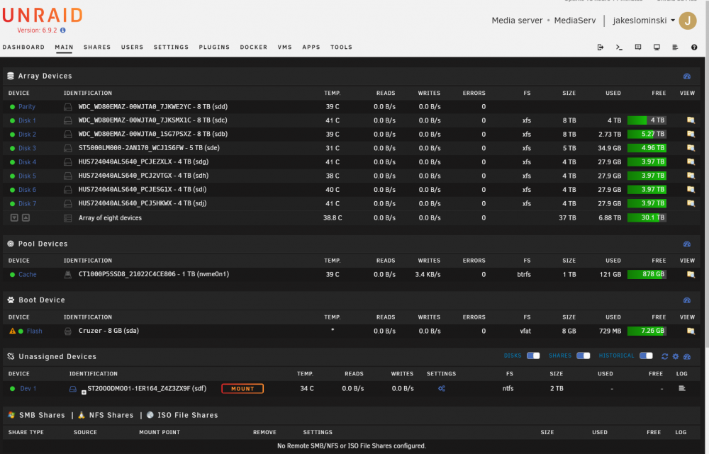

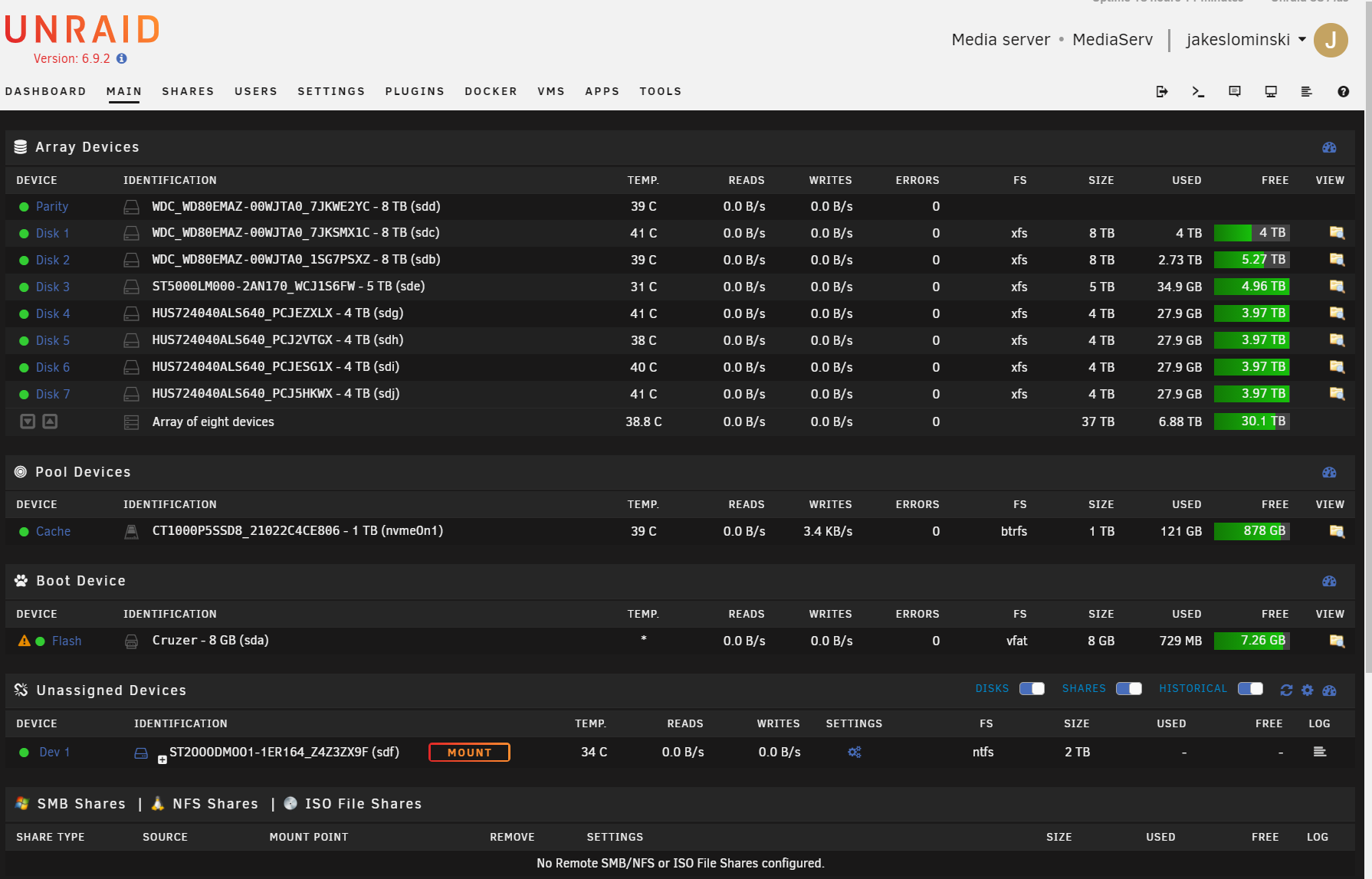

UPDATE: So wasn't able to run memtest last night because I didn't realize it needed BIOS and not UEFI, so that will be run tonight I guess. Left it sitting running a parity check since this server has gone through alot in the last couple days and wanted to be safe. Its at 0 errors for 1.5TB right now so I'm not sure if this is related to parity or something else, but I am seeing alot of BTRFS errors in my log this morning. They came in right after log in and was going to check share sizes just out of curiosity. Logs below because incase it has any more meaning. Looks like the cache drive if I'm not mistaken.
