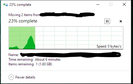

I have been having an issue with my server that I have had for a while now.
The issue stared a while back but recently has gotten worse.
It seems that ONLY one drive LOCATION has been having this issue.
When transferring data to of from that disk location it will seem alright for a 30 seconds to a minute, but then will drop to 5mb/s and even 0mb/s and sit there till it feels like going back to 5mb/s for a bit then back to 0mb/s.
I say one drive location and not the drive itself because I have replaced the drive in the location several times. each has had this issue.
The just removed a drive from the location last week because it started to get UDMA CRC error counts.
Over 4k in a week.
I've tested the drive and it passes smart tests from WD.
The drive I replaced it with luckily has not had any UDMA counts.. yet.
The drive is my most used drive as it is where I have my P2P files located.
I have tried swapping the sas cables and cards..
I even shut down my P2P Docker to test if it was cause by the dockers read/write to the drive.
Still the same speed issues...
if anyone has any suggestions that would be greatly appreciated.
Chassis: SuperMicro 4U CSE-846 24 Bay
Backplane: BPN-SAS2-846EL1
Mobo: X9DRi-F/2x
CPUs: E5-2620 x2
RAM: 32GB
Controller: SAS2308 x2 (one controller both lanes from BP)

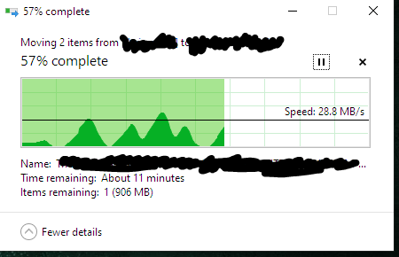

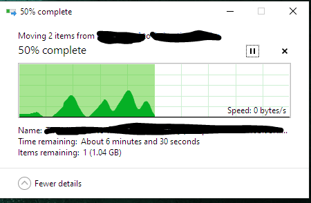

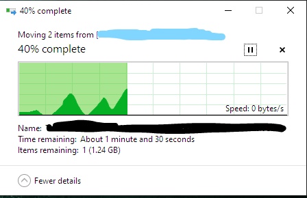

I tried to transfer a 1.6GB file.
Below are snap shots I took while it was 'working' on it.
Its been almost 20 minutes now and still not finished.
Only about 3/4 done.
