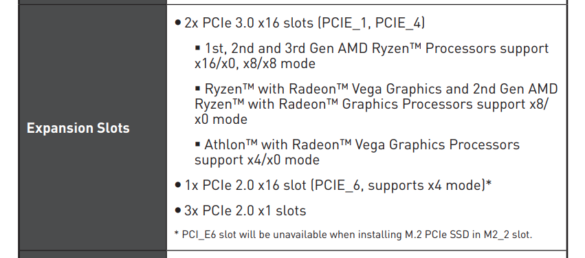

First - Your motherboard does not have the bandwidth to run two GPUs at PCIe 3.0 x16 link speed so you may not see ideal performance, and depending on your configuration, it may be running as low as x4 bandwidth. At best, with that board, you will get PCI3 3.0 x8 link speed but only if you connect your GPUs to physical slots marked PCIE_1 and PCIE_4 AND you're not using a "with Vega Radeon Graphics" or "with Radeon Graphics" variant CPU. Any other ports will run PCIe 2.0 x4 bandwidth or lower regardless of their physical size. If you ARE running a "with xx Graphics" variant CPU, you will only get one PCIE slot to work, as in this case the onboard lane swithc will run x8/x0 (or x4/x0) on PCIE_1/PCIE_4 respectively.
Second - Check for BIOS updates, as this may improve compatibility slightly. The above CPU/link width restrictions will still apply, however, as this is the result of using a relatively low-end gaming motherboard with insufficient PCIE lane capacity.

@John_M  I reviewed specification of their motherboard before I made the post. Its contents are factual for this exact context. Depending on which CPU they're using it either gets x8/x8, x8/x0 or x4/x0 depending on what CPU they have installed. If their CPU allows it, simply loading the board should have allowed it to function if it was going to. No configuration should be required within the UEFI setup.
Also I didn't mention it but on this board PCIE_6 is a PCIE 2.0 x4 interface despite having an x16 physical connector, I wouldn't suggest using it for your GPU regardless of how much space there is.

It's a 3600, according to the diagnostics, so 24 PCIe ver. 4 lanes, though the motherboard is only qualified for ver. 3. 4 lanes to the X470, 4 to the NVMe, 8 to the primary slot, 8 via a switch chip which can feed either the secondary slot or the remainder of the primary slot.
@xnerdist Since you want to pass through the RX 580, you could try putting it in the primary GPU slot and if the P2000 won't work in the secondary slot (physically x16, electrically x8), where it should ideally go, you could put it in the bottom long slot, which is physically x16 but wired for four PCIe ver. 2 lanes, but loses some if you populate the lower x1 slots. That will work if the BIOS allows you to select that one as the primary GPU. It isn't ideal but should be quite usable as your main purpose for it is not to generate complex graphics but to transcode video, where a much lower PCIe bandwidth is required. Nevertheless, it ought to work properly as you had it and I'm still of the belief that it's a motherboard/BIOS problem. Consumer and gaming motherboards are only tested with Windows and each one works around the bugs in the other so "it works with Windows" is no guarantee that it will work with any other operating system.
@John_M That may be factually accurate, but specifically I was quoting the breakdown the motherboard manual indicates actually reaches the PCIe slots, not hypothetically edu-guessing based on what lanes should/can be available to a chipset vendor. Implementation-derived specs are always better than application-derived specs because while any vendor can use an X470 chipset, some vendors might choose to implement PCIe lane distribution, weighting, switching, and layout in very different manners, due to differing choices in included/supported peripherals, as well as how widely they wish to implement the ability for the user to map PCIe lanes onto physical slots IE how many different "bank switch sets" can be accomplished per board.
I'm not saying you're wrong, I'm only saying that you're making judgements based upon what CAN be done, rather than what the actual manufacturer who implemented/built/sells the finished product based around the application says WAS done.
This is the Word Of GOD on what this specific model of motherboard can do, barring solely A) improper documentation or B) updates via UEFI image/etc which changes the capabilities of the board;
Other boards USING an X470 can and will have drastically different layouts and implementations within the constraints of what the CPU/APU itself provides, but every X470 does not have the same layout and pretending it does only adds confusion.
I'm not trying to argue, I'm telling you for a fact, of the PCIe x16 connectors physically available, this board has only two which can achieve at best x8, one which will never exceed x4 and is also disabled when using PCIe based M.2 storage, and that is it. Your clarification on which CPU is in use is appreciated and seems to preclude the presence of a graphics processor, but I don't have generation-to-model-shorthand memorized so I'd actually have to spend more time to look it up and frankly it's not worth it. The information has been covered.
