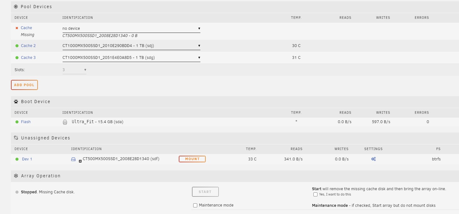

I set the (first) cache drive to "no" but then I cannot start the array (see my attachment)
Any ideas? I have no clue also thought a swap in the cache pool is quite easy

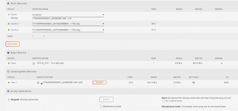

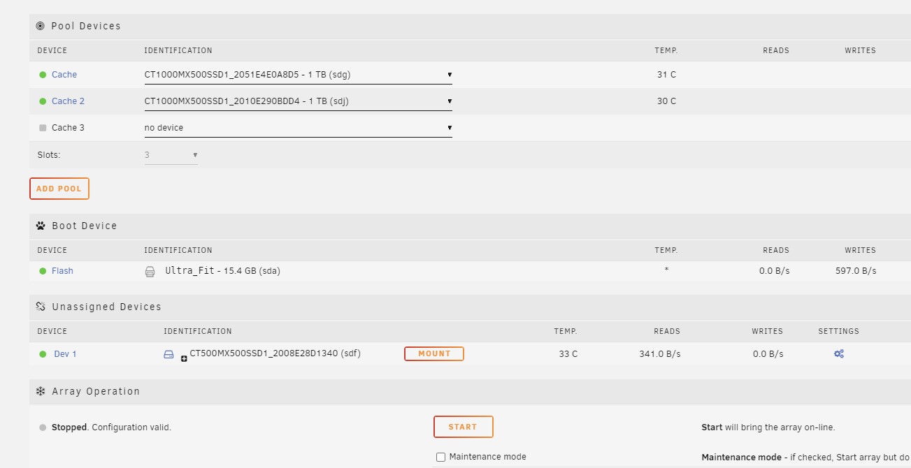

When I swap Cache and Cache 3 I can start the array but again with the unmountable error. Start the array anyway and run the diagnostics. Again see the attachments
Thanks a lot
Just need to check that assuming the pool is redundant, can't see since diags were taken with the pool not mounted.
Thanks a lot Jorge.
Checked the mark and the array started without any problem. When I tried I think I just oversee that mark 😅

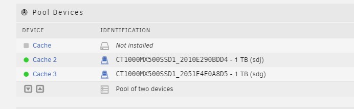

One last question: Is it possible to swap / set / change the 2 remaning disk to Cache and Cache 2 and get rid of "Cache "not installed""?
Thanks again
Yes.
Just unassigned Cache 3 and added the drive to Cache, worked without any problems👍
