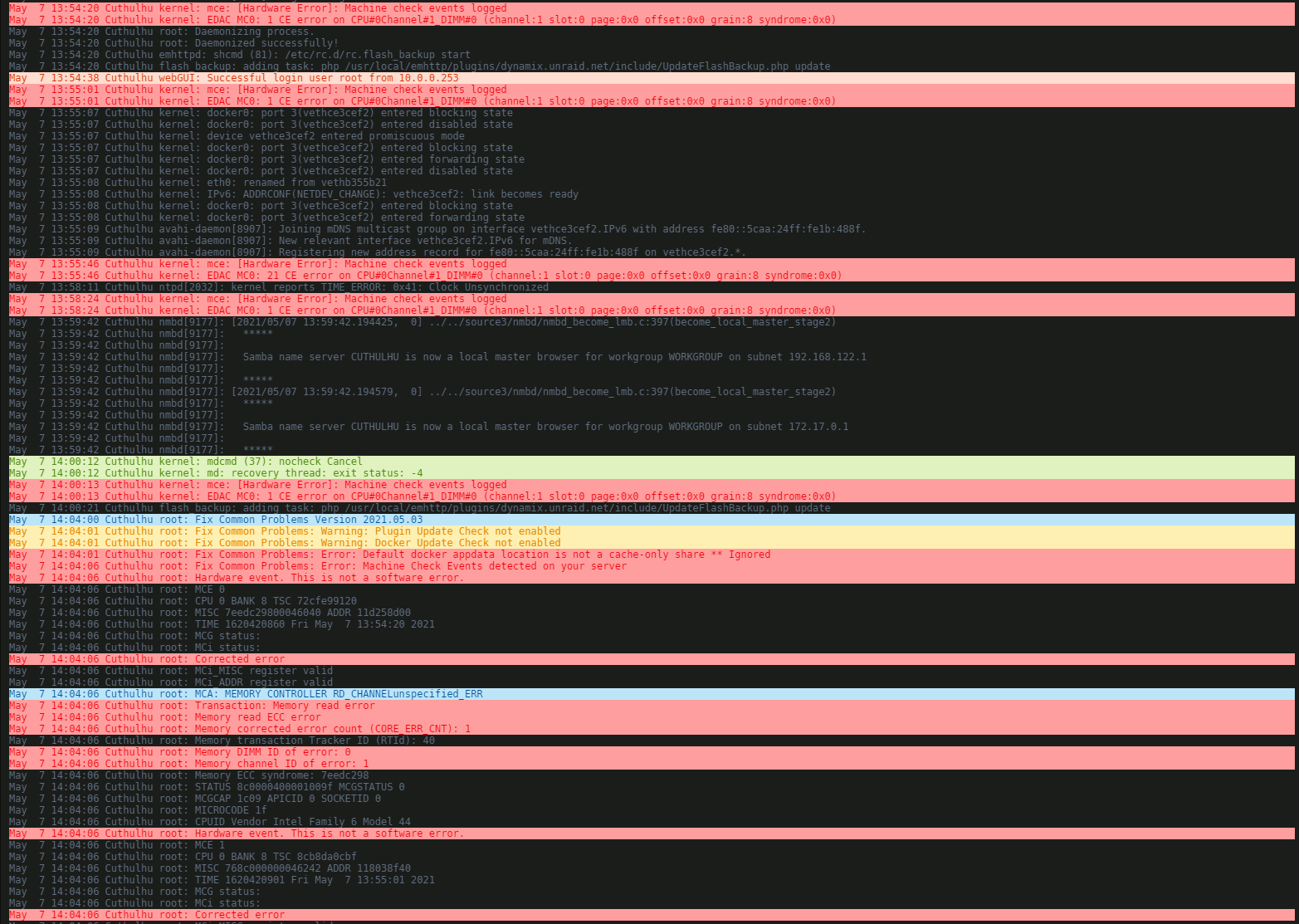

Hi everyone, as the title says I just built my first unraid device this week and have managed to get it semi stable, but it crashes every once in a while (between 1-4 times a day) and I cant figure out why. Sometimes its when its under load, sometimes when its just idling.
I'm using it as a plex server right now and hope to use it as a mini google drive later on. (also I'm sorry if this isn't the right place to put it. I think it might be a CPU problem, but I'm not sure)

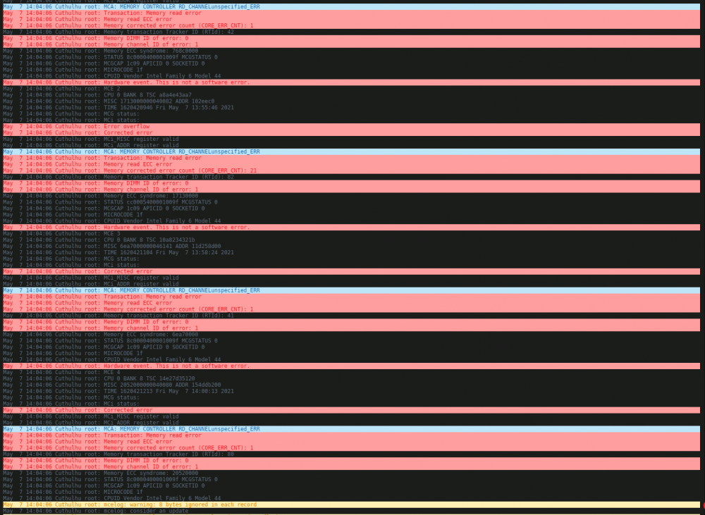

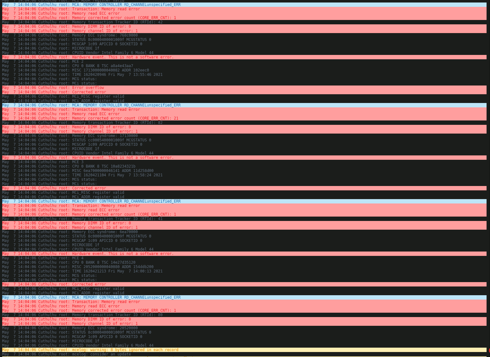

I downloaded the fix common problems plugin as forums recommended along with the mcelog. I have attached the syslog files as well as 2 photos where it shows the red stuff colour coded.

Instead of syslog, we prefer diagnostics, which includes syslog since last reboot and many other things that give a more complete understanding of your system, configuration, and situation.
Go to Tools - Diagnostics and attach the complete Diagnostics ZIP file to your NEXT post in this thread.
That syslog you already gave us suggests ECC is detecting memory errors.
