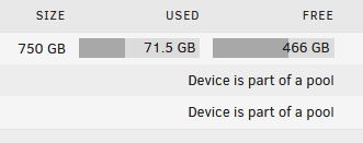

the first issue is cache size. I have 750Gb (3x500Gb SSD) total and used + free space NEVER adds up to total.
