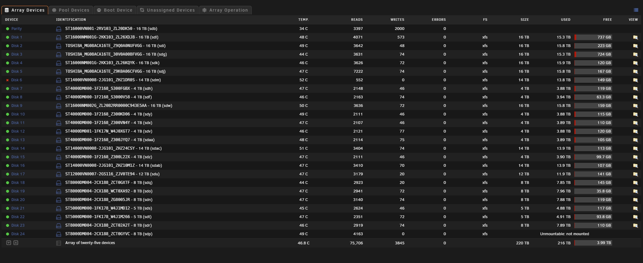

Issue
Disk 6 disk has a Red X
Disk 24 is showing as unmountable
How it happened
Disk 6 came up with an error.
I did the SMART tests and rebooted and all seemed fine.
Did a further re-boot and now Disk 6 is now showing the Red X
And Disk 24, out of nowhere is showing as unmountable.
Help please.

Just started the array (normal) and Disk 24 is up
Disk 6 SMART is stuck on 10%
I think it's gone bye bye
Ordered a new one and will swap it for the new one once it is in.
Needed more space anyway :)
Nevertheless, thank you SO MUCH for all your help.
You are a superstar!!!
