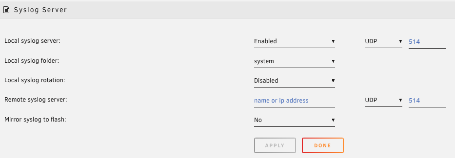

On 5/16/2021 at 2:21 AM, JorgeB said:
Log server is not working correctly, check configuration.
The configuration is the one I posted above:
Is there anything I should change?
Thanks!
I never used it, compare with the configuration in the link.
Enabling the Mirror to Flash option is the easiest way to get it to work. The other options are for exporting the llocal log to an external server or for receiving logs from other servers.
Thank you for the response! I enabled mirror to flash. So I assume once this happens again, I can grab the log file from the flash and post it here.
Yes, exactly.
