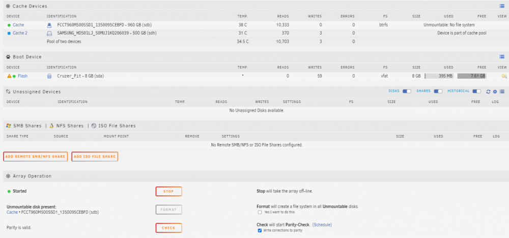

I had an I/O error on transmission.  I tried to restart that docker and then the whole Docker now fails.  I'm guessing I probably need to replace my SSDs?  I just thought even thought they were showing bad SMART stats, I didn't think I could wear the SSD out before filling up 100TB.  Usually they can do like 200TB right?
Just want to confirm before I place the order, I had already been looking to replace them just in case.
tower-diagnostics-20210510-2057.zip
Syslog is showing a problem with cache2, looks more like a connection problem, replace cables and post new diags after array start.

I restarted, it's asking me to wipe the drive?  That doesn't sound good.
I'm almost positive I haven't written more than 200TB across both drives.  They've been definitely used hard, so if it really is broken, no problem.  I've probably written 1.5-1.8x my current size since I replace data and it has to go through the SSD. So maximum, I think I've written 130-150TB since I only have 80TB of data.

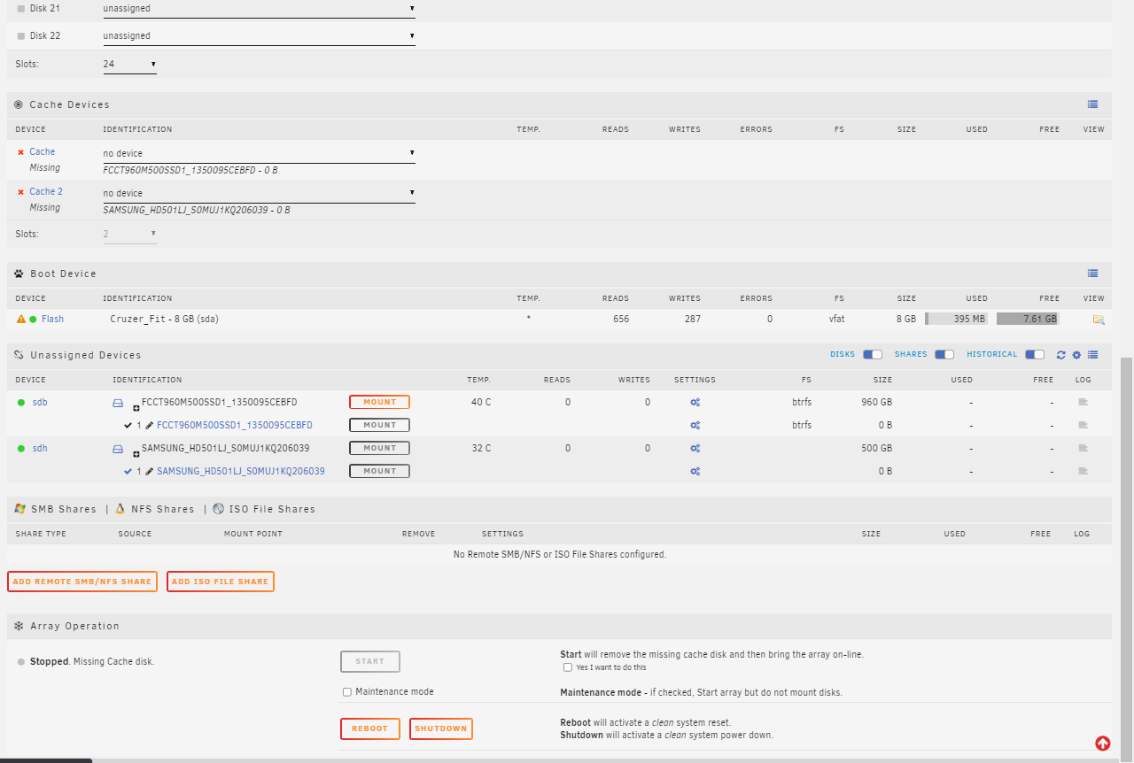

tower-diagnostics-20210512-1731.zip
Edited by tential

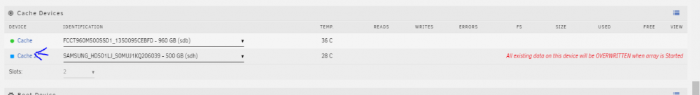

Try this, if Docker/VM services are using the cache pool disable them, unassign all cache devices, start array to make Unraid "forget" current cache config, stop array, reassign all cache devices (there can't be an "All existing data on this device will be OVERWRITTEN when array is Started" warning for any cache device), re-enable Docker/VMs if needed, start array, post new diags after array start.

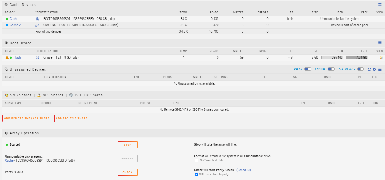

I tried as suggested, it's showing it's still unmountable without a format?  It says no file system on first drive too?
tower-diagnostics-20210513-0732.zip
Pool is in a very bad state, there are some recovery options here you can try, but also make sure to see this for better pool monitoring for the future.

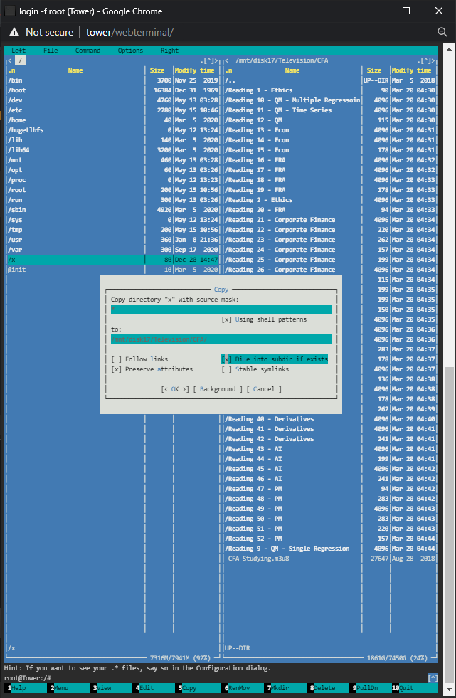

I see, so I gave it a shot and I think I got it? I'm just not sure exactly how to start the copy and what settings to use.
I got the /x directory mounted and I want to move it to my study materials folder on Disk 17, the only disk with enough space + extra.
I selected the Alt+5 to copy and hit the Dive into sub dirs check list.
Now do I just hit OK?  Or did I choose a bad copy place (copy to a mount vs array).  I wasn't able to find array places, only these mounts?
Also, I have no shares anymore?  Should I be worried?
Edited by tential
Yes, but you can also browse /x and only copy just what you need.

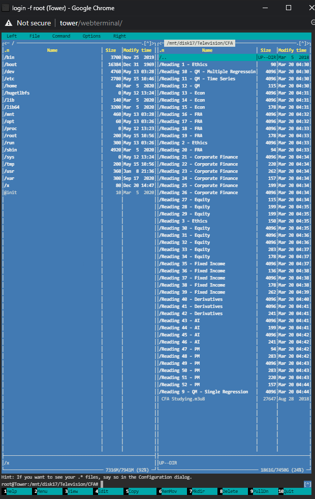

I got a lot of errors doing that, so guessing that's not valid?

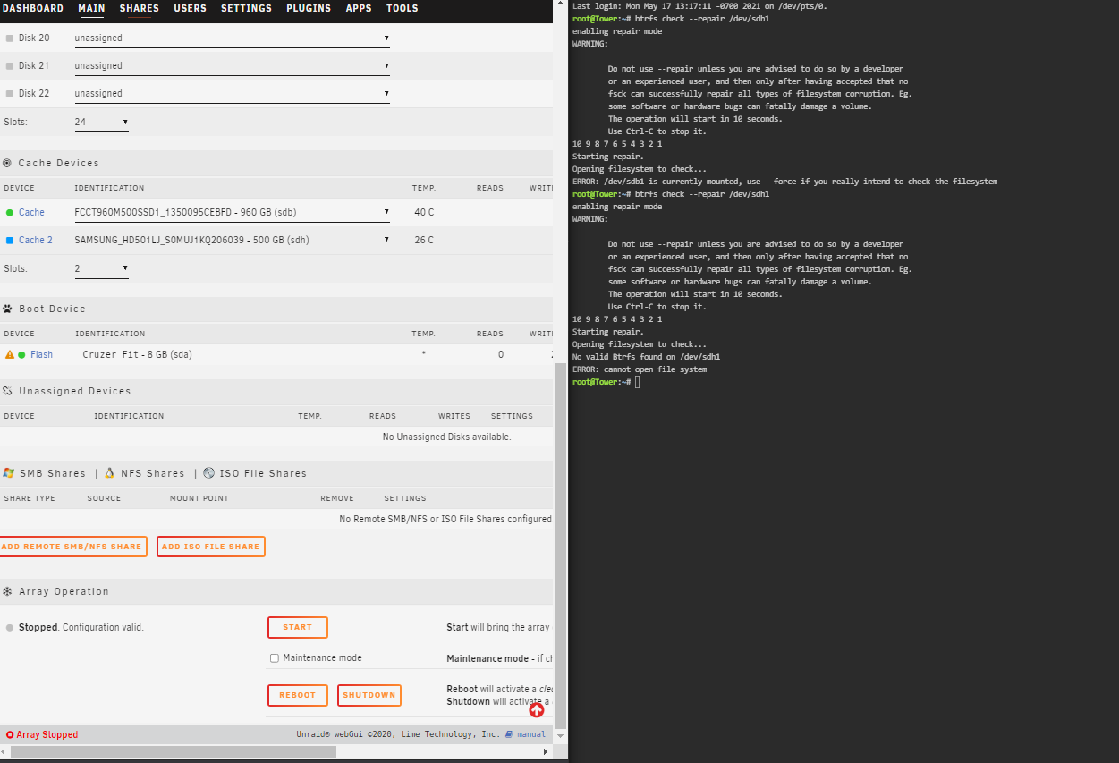

I tried BTRFS repair as a last resort, but it's telling me the cache pool is still mounted, I haven't even started the array yet.
You need to unmount the filesystem first:
umount /x

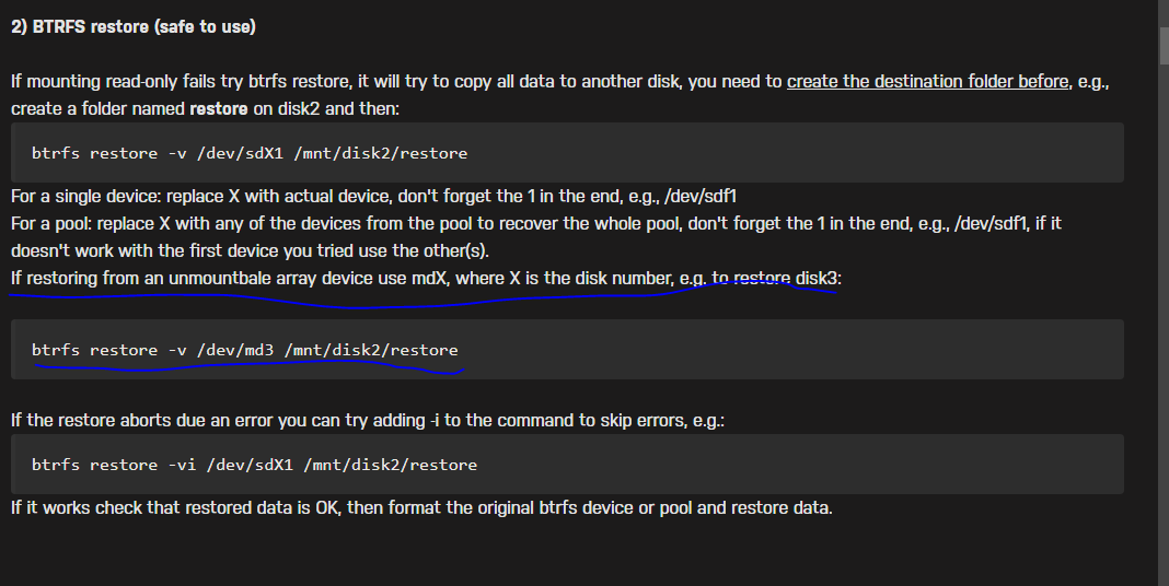

image.thumb.png.961145b79917f77e7ebe8631b501ff1c.pngI don't think I actually did this step correctly, how do I do this step where I use the mdX but it's for a cache pool instead of a disk?  I don't want to use md1 to restore from disk 1 accidently instead of cache pool?
mdX would be to restore from an array disk, to restore from a cache disk you always use sdX.

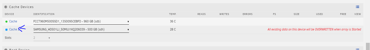

Thanks for the clarification.  I tried, still can't get it to recognize the second disk is part of the pool, oh well.  Guess I need to start from scratch.
What steps do I take to reset it now that it for some reason sees both ssds, and wants me to load them, but it won't work?  So I need to wipe/rebuild the pool.  How should I do that?
Edited by tential

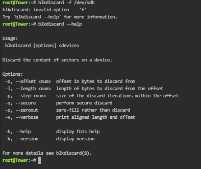

Wipe the SSDs with
blkdiscard -f /dev/sdX
Then add to pool and re-format.
8 hours ago, JorgeB said:
Wipe the SSDs with
It's telling me -f is an invalid option?
Depends on the Unraid version, do it without -f, v6.9.x requires -f
