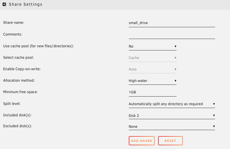

Not partitioning, but you could make a user share called, say, small_drive and include only that one 100 GB disk, like this:
and you'd want to exclude it from other shares. It would have the advantage of being protected by parity, along with the rest of the array disks.
So basically, find a $20 ebay special, set it up so that the share is only using that drive. I like that it would also be parity protected.
I'm a little new to unRaid, does excluding and including drives change the size of the share? I don't think I realized that a share size could be dynamically changed with includes and excludes. I mean, it makes sense that it would.
If the drive fails, the small share would still show up via some redundant processes right?
Edited by h1d3m3
As long as one parity is valid, any single failed drive will be emulated in real time and can be rebuilt to a new drive.
However...
Implies that you don't care about the quality of the drive, when in fact ALL drives in the parity array are needed to emulate and rebuild any failed drive. So, you are trusting the quality of that small drive to rebuild an unexpected failure of one of your large media archive drives in the parity array.
It will work just fine, as long as the drive is healthy. I just wanted to hammer home the point that ALL drives must be perfect, you must not use a drive that isn't 100% trustworthy in the parity array.
Yes, the maximum* capacity of any user share is the sum of the capacities of the included disks. The more you include, the greater the capacity.
*Note: It's the maximum because very often a given disk is included in more than one user share, though you're free to configure that however you wish.
