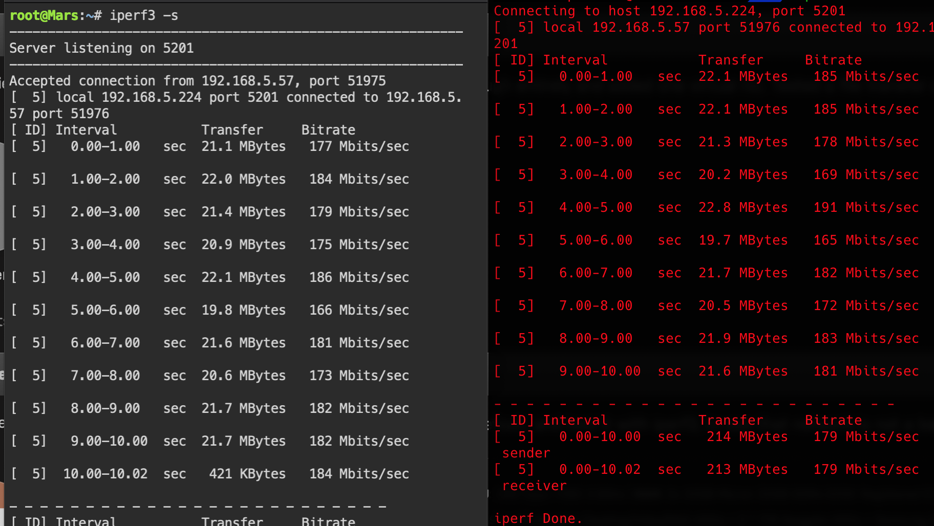

May 20, 20215 yr Author Hey so i set the MTU to default and tested with iPerf3, this test is using only the 1 virtual NIC, previously i did a iperf test with my pass through NIC bonded and i got approx 800 mbps to another hard wired computer which is how i test the file transfers as well. This time i got over 150 mb/s with just 1 virtual NIC so that should not be the bottle neck. Screenshot below.
May 20, 20215 yr @1da are your network 1Gbe? if yes, then ~200Mbit is really crap speed.. when i was on ESXi, and now on proxmox, i'm getting > 9Gbit on 10Gbit network - all default settings with one virtual nic with VMXnet3 Adapter type. so, looks like you need to resolve your network problems first...

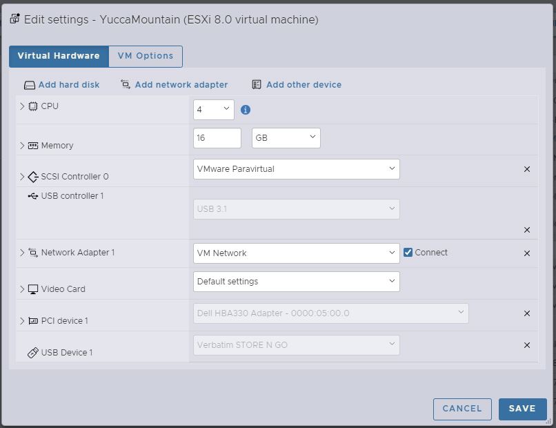

February 19, 20233 yr [EDIT: Turning off secure boot fixed my problem immediately.] Apologies for replying to a dead topic, but figured this would leave the most continuity of the discussion. I am attempting to boot unraid on ESXi 8 and having issues with the usb not being found by vmware efi on boot. Interestingly when I boot into the bios and go to configure boot options -> add a boot option the first entry listed is an Unraid MBR. so obviously it can see the usb stick. What am I missing here? Edited February 19, 20233 yr by Shivaess
November 27, 20232 yr On 2/19/2023 at 11:27 PM, Shivaess said: [EDIT: Turning off secure boot fixed my problem immediately.] Apologies for replying to a dead topic, but figured this would leave the most continuity of the discussion. I am attempting to boot unraid on ESXi 8 and having issues with the usb not being found by vmware efi on boot. Interestingly when I boot into the bios and go to configure boot options -> add a boot option the first entry listed is an Unraid MBR. so obviously it can see the usb stick. What am I missing here? Not sure if you ever fixed this but since you attached a USB 3.1 controller, the USB drive needs to be 3.0/3.1 otherwise it wont boot. I removed the 3.1 controller, added a USB 2.0 controller and booted off of my USB 2.0 thumb drive, no issue.
