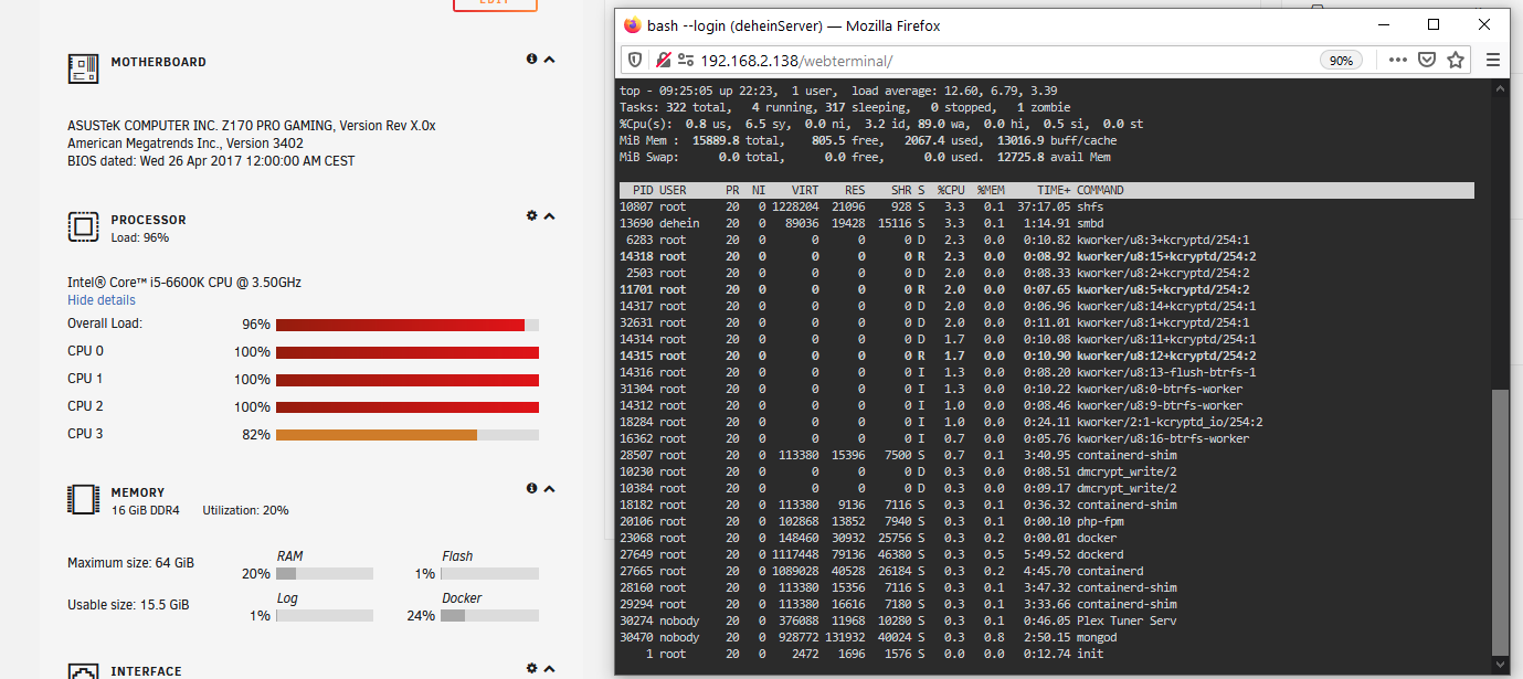

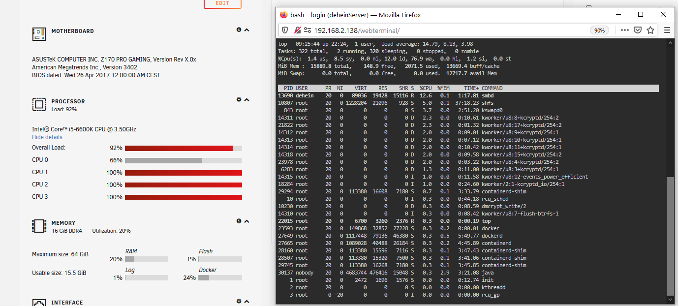

just 2  pictures:
not sure if i interpret top correctly, but the load seems to be lower there. But as the system still is unresponsive i don't think that's right ;)
Edited by dehein2
Top doesn't show i/o load, dashboard does.
