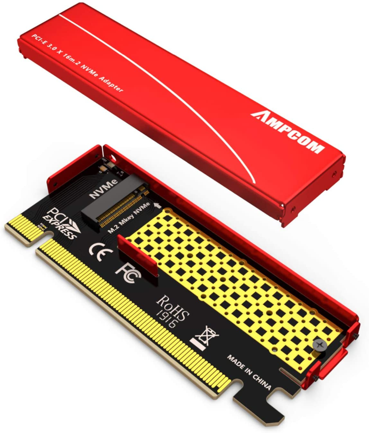

Can the UnRaid OS handle three VMs on a single NVME SSD split as 3 partitions? My plan is to buy a 1TB Samsung 980 NVME SSD which is going to be mounted to a NVME PCI-E adapter card like the one shown in the JPG below. Addtionally, I want to install VMs for the Ubuntu OS, the Windows10 OS and the MacOS on this 1TB NVME SSD.  Will the UnRaid OS support such a setup?

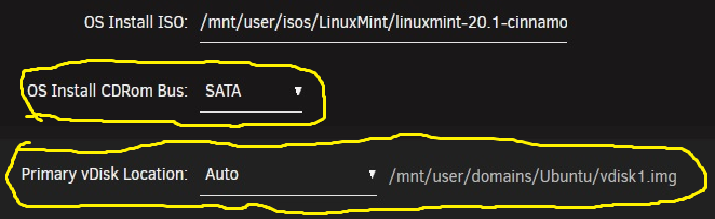

By looking at my VM Setup Form screen capture below, I realize I may have to change the SATA option to NVME.  However, I am not 100% certain how the "Primary vDisk Location" parameter needs to change so it correctly supports such a NVME setup.  Mainly, what does the "AUTO" option need to change to so any one of the three operating systems correctly boots up as a VM?  And what will the OS installation path look like for each one of the three Operating Systems in such a NVME setup? And will all three of my VM Operating Systems run faster by using such a NVME SSD setup?

With this setup you need a virtual controller to attach the partition (disk) to, virtio or sata should be preferred.
What you are highlighting in your picture is the virtual controller to attach the cd-rom, nothing to do with disks.

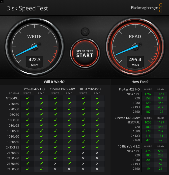

Well, I have to modify my comment about performance..
I run a mac os vm from about 1,5 year and I always used vdisk files on my ssd (crucial).
When using vdisk attached to a virtual sata controller, mac os sees a generic AHCI controller with 1,5 gigabit speed.
Here is the test on the vdisk file:

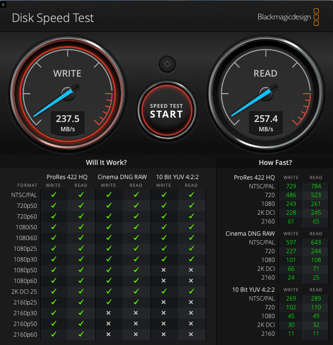

Today I restored my vdisk image directly to the ssd and passed through to mac os the whole controller (Marvell 88SE9230, 6 gigabit), and attached the ssd to one sata port of that controller: well, the performance seems to have increased a lot:
Passing the whole controller seems to be the best option, no data with passing partitions, I think that shouldn't be much difference with vdisks, as controller is always emulated, but I may be wrong (again)...
Here the "issue" is obviously the AHCI virtual controller running at 1,5 gigabit, I don't know if it is detected differently in windows or linux.

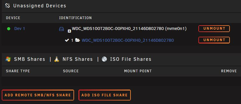

I watched the SpaceInvader One video you posted in your previous post.  The screenshot below shows how my NVME app appears in my Unassigned Devices area after I click on the + button:

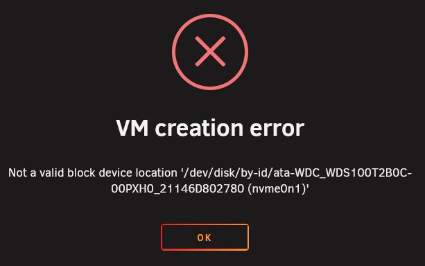

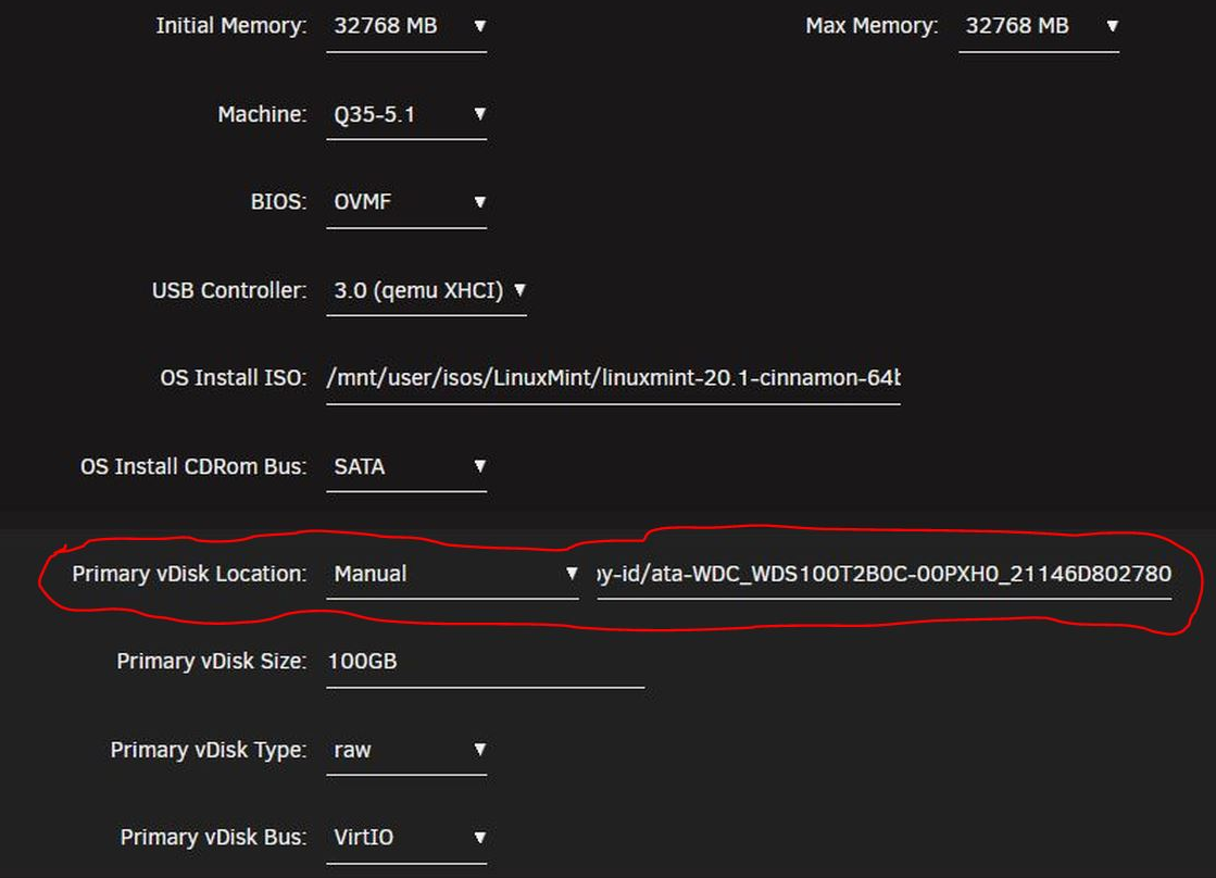

I set my Primary vDisk Location to "Manual" and paste the path shown below which is generates the errors shown below:
/dev/disk/by-id/ata-WDC_WDS100T2B0C-00PXH0_21146D802780 (nvme0n1)
After I hit the "CREATE" vm button I see the error below:

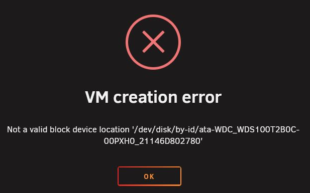

Additionally, removing the "(nvme0n1)" text string located at the end did not help. I still get a path error:
Ghost82, can you or anybody in the community please advise what is the correct Manual vDisk Location path I need to use that the UnRaid OS will not reject?  I ask because the SpaceInvader One video I watched seems to be about passing through a SSD hard drive and not passing through a NVME drive.

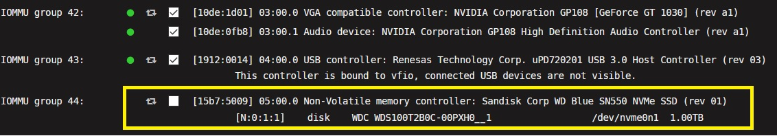

The screen captrues below shows my System Devices for my PCI NVME card. So I don't think the problem has anything to do with hardware incompatibility because the UnRaid OS successfully recognizes this NVMe hardware.
Any opinions will be greatly appreciated because I am stuck in the mud.
Hi, when using vdisk as primary disk location choose a place on your nvme disk to save the vdisk.img file (a path to it to save the file, first mount the drive!). Something like /path/to/nvme/vdisk.img
Edited by ghost82
Ghost82,
Thank you for your post.  Let me break it down.  SpaceInvader One says the beginning of the path needs to look like this:   /dev/disk/by-id/ata-
Then it needs to be followed by my NVME id which is:  WDC_WDS100T2B0C-00PXH0_21146D802780 (nvme0n1)
My Unassigned Devices app confirms the NVMe is MOUNTED as shown in the screen shot above.  However, my Unassigned Devices app does not show me a path where my NVMe is at.  Also my Unassigned Devices app generates a "(nvme0n1)" text string at the end of the ID.  Can somebody please clarify if this text string needs to be included in the path to my NVMe?
Lastly, can anybody in the community please clarify for me how this part of the path:  /dev/disk/by-id/ata-
needs to change so my Unraid OS does not reject it?
58 minutes ago, slipstream said:
Ghost82,
You are not passing through the nvme drive, but you are saving vdisk img files on the nvme drive, so you are following the wrong tutorial.
The path you are writing is totally wrong and doesn't start with /dev...
Once the nvme drive is mounted by unassigned device it should mount the nvme at /mnt/disks/ (please note the final s in diskS).
So look inside that folder, find your nvme mount point folder, eventually create another folder to identify the name of your vm and inside this save the vdisk.img
The path will look something like /mnt/disks/nvmeMountPoint/myVMname/vdisk1.img
If it's mounted it CAN'T be passed through.
