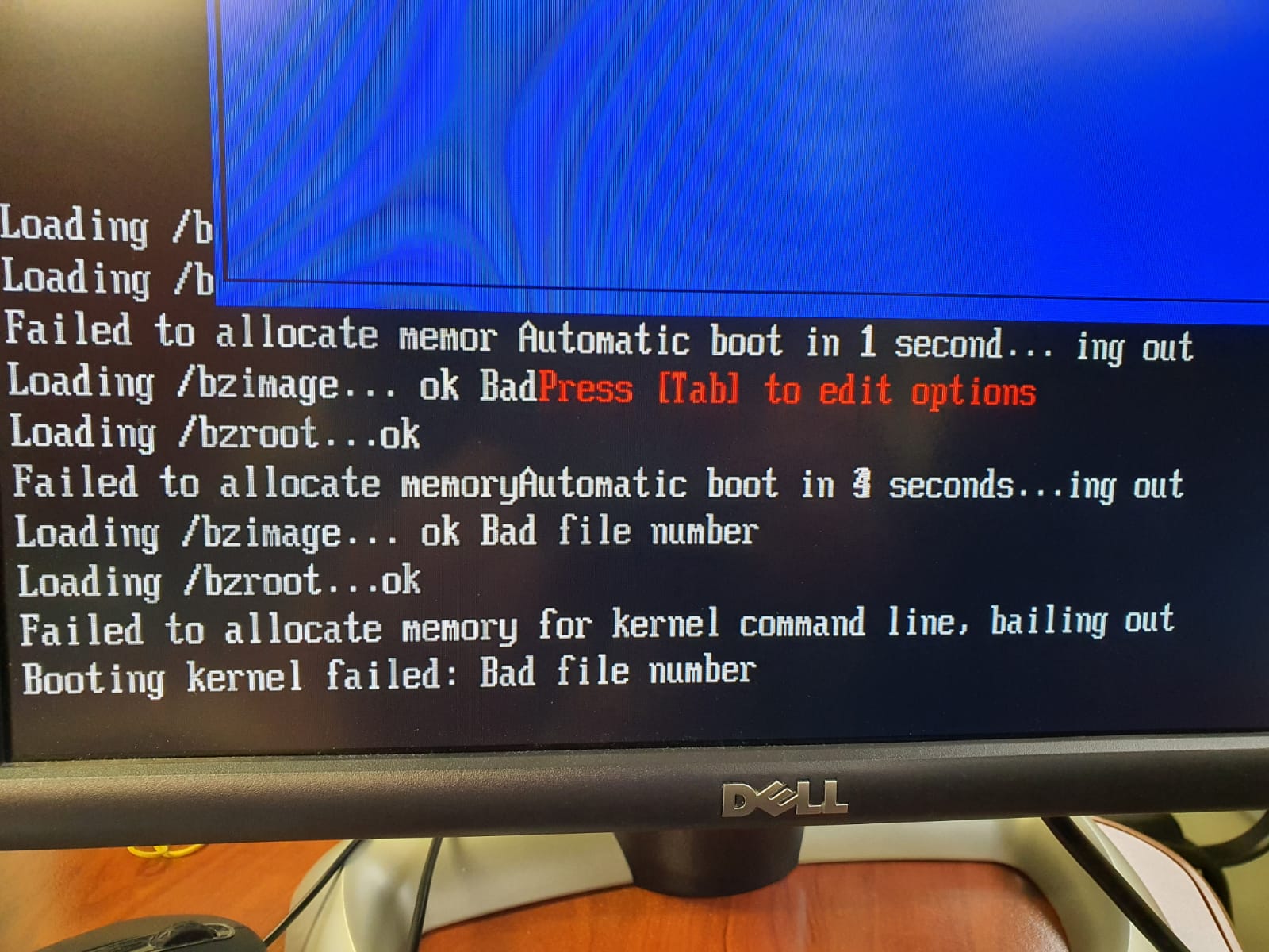

A little update after a few hours spent on retries.
This time server has boot with success, changing boot mode from BIOS to UEFI (why it was booting with the other USB key????), but after a few seconds it displays the following error and keep retrying.....
Known issue with some Dell servers, some workarounds below:
