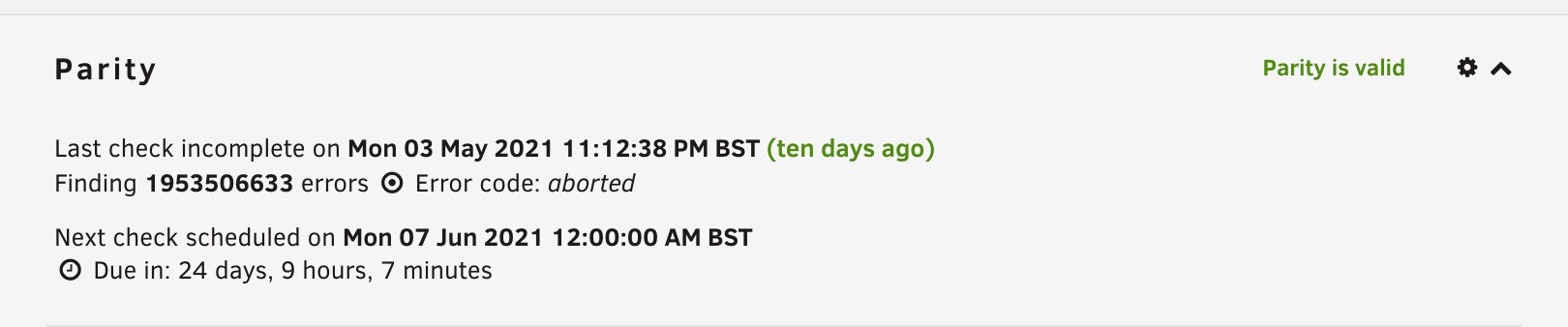

Hmm, after a bit more investigation, the plot thickens.
I actually now recall I had a power cut on 4th May, during a monthly scheduled correcting parity check (it started. I only powered the server back on today (long story due to our internet being down etc etc) to find the two red-balls.
And it looks like it was a pretty weird parity check from the data on the dashboard (see attached, but 1953506633 errors!?).
I now suspect that the backplane may have gone bad during the parity check.
But that means I'm not sure whether to trust the data disks or the parity. But I'm leaning towards the data disks given that if that error count is correct, it could have written bad parity data? If that's the case and I want to trust the data disks, how do I force a parity rebuild with 2 parity disks, 1 of which is currently red-balled?
At this point the system should be "emulating" the disabled data drive using the remaining data drives and the parity1 drive.   Does the content of the emulated drive look correct?  If so this would suggest that parity1 is probably good.
Very hard to tell - it's primarily large media files, so there could be corruption to them. I don't run regular hashes/file integrity checks (maybe I should start!).
But, being paranoid, what would cause so many parity errors/corrections from that last parity check? The server had been mostly idle since last parity check (due to aformentioned internet outage), so I doubt a lot of data was written to disks... makes me suspect that there was something else weird going on, so I wonder if it's worth digging deeper into the errors (no logs, sadly). I suppose I could try to compare the emulated disk 4 with the "real" disk 4 to look for any file hash discrepencies...
I'm going with your suggestion itimpi - thanks! If it turns out I find data corruption I will have the data disk just in case.
