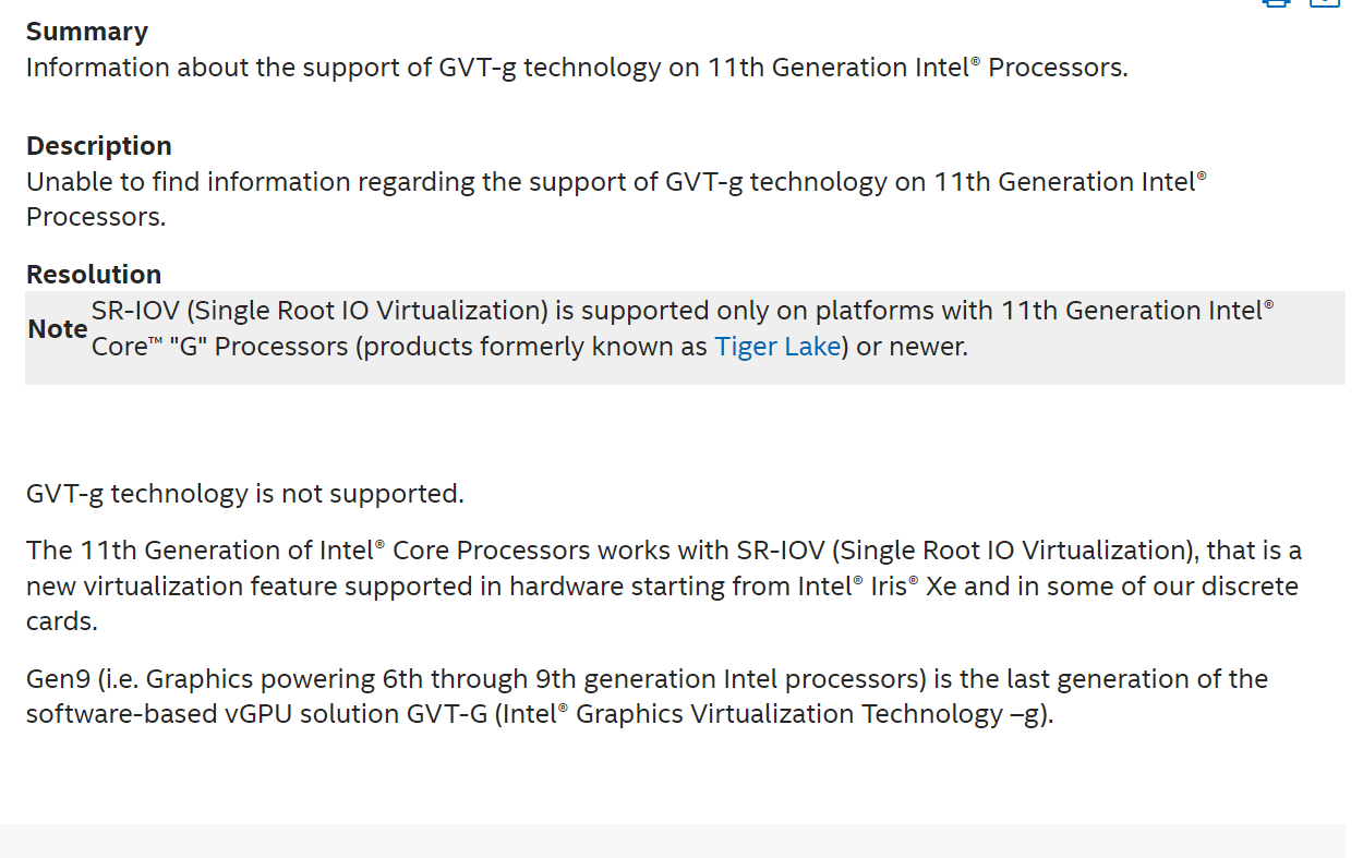

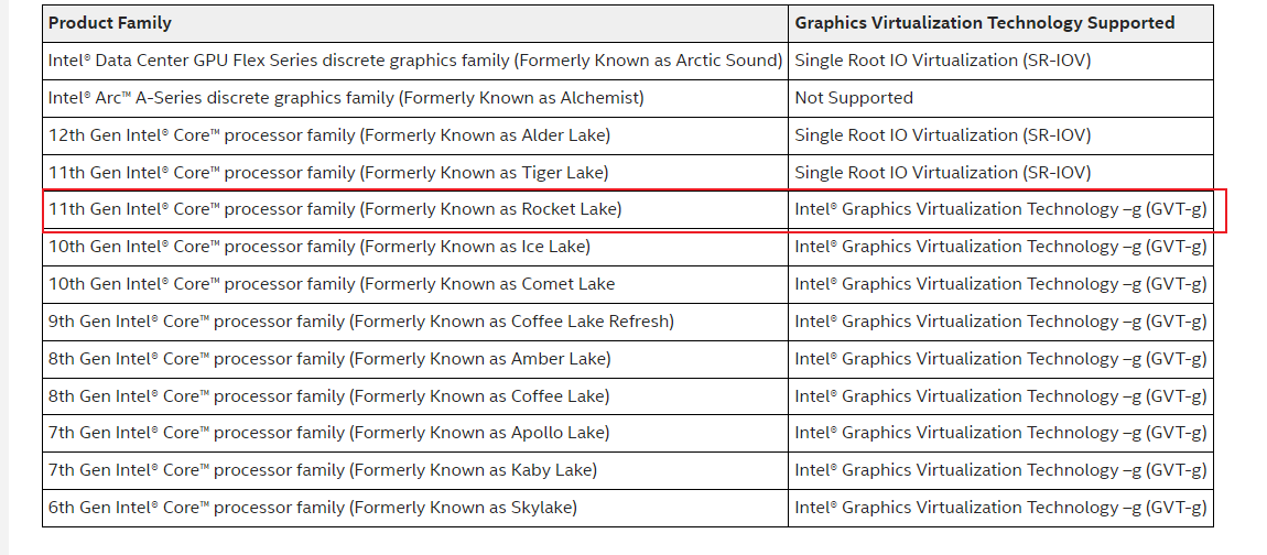

Hello, I would like to ask whether this plug-in supports the 11th Gen Intel® Core™ processor family (Formerly Known as Rocket Lake)? Or does it need to wait? I read on Intel’s official website that it supports GVT-G Intel® Graphics Virtualization Technology -g (GVT-g), because I tried to install the i915 SR-IOV plugin and it didn't work.....
gvt-g is not supported on 11th gen and up, see page 1, why, may ask intel ... sorry but no need to wait for gvt-g.
Please look at the first recommended post on top for more information.
1 hour ago, alturismo said:
第 11 代及更高版本不支持 gvt-g,请参阅第 1 页,为什么,可能会询问英特尔...抱歉,但无需等待 gvt-g。

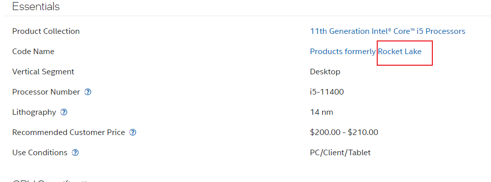

Yes, I know, but my I5-11400 does only support GVT-G because it is Rocket Lake, and the plug-in does not support 11th Gen. I express my regret, anyway, thank you for your reply
Intel seems to have conflicting information. So looks like Rocket Lake is out in the cold with no support for Virtualization
You can always install the plugin and see if it displays anything to choose or it simply tells you that your CPU isn't supported.
Anyways, GVT-g is only supported up to 10th Gen Intel CPUs.
The main issue with this is that Intel uses most of the times different Generations numbers for the iGPUs and I think this causes, even internally at Intel, these conflicting information.
Hello, i have an 11400 that ONLY supports GVT-g cause its a rocket lake chip! NO SR-IOV SUPPORT! pls adjust the plugin so it at least trys to use GVT-g with 11gen Processors!! WE CURRENTLY HAVE NO CHANCE ON VIRTUALISTION!
5 hours ago, ApfelBirneKreis said:
您好,我有一个仅支持 GVT-g 的 11400,因为它是一个 Rocket Lake 芯片!不支持 SR-IOV!请调整插件,使其至少尝试将 GVT-g 与 11gen 处理器一起使用!!我们目前没有机会进行虚拟化!
You have the same as me, but unfortunately, there is no way at present

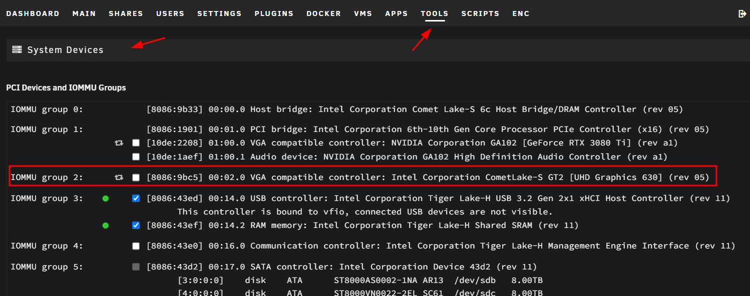

before you look further in gvt-g you have to make sure your igpu is visible in unraid
tools - system devices
then you can look further in gvt-g, 1st approach now would be, after vfio is backported (no vfio binds, reboot and igpu back in devices) you uninstall gvt-g, reboot, install gvt-g, reboot, reassign the vgpu to your VM.

So, I just purchased a system with an Intel Xeon W-1370P processor, which has a P750 iGPU (Rocket Lake), and is also listed as an 11th gen supporting GVT-g, as shown in the picture earlier in the thread.

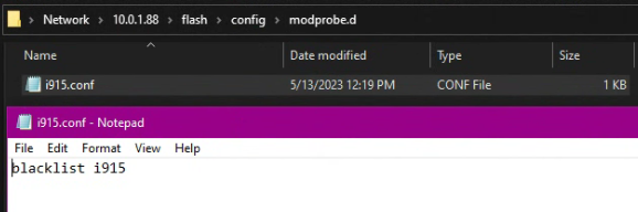

I tried installing the plug-in, and it doesn't say it's not supported, but it's not picking up the i915.conf, which I added the 'blacklist i915' line. SR-IOV flatly tells me not supported.
Is there anything else I could try? I just purchased this system after having issues with my other build constantly freezing from the i915 module, shown in the thread below, and not being able to resolve it, and just want to be able to transcode plex and have the igpu for my VM.
