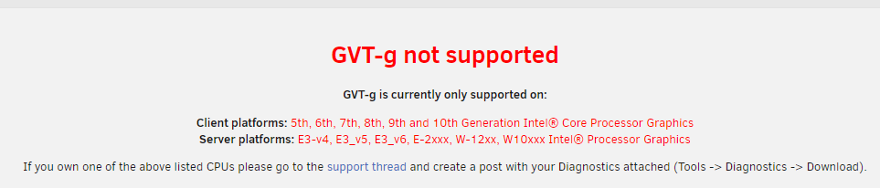

Cpu是i9-9900T,他正常运作了好一段时间。突然不能正常工作了。图片是我在插件里看见的画面。
CPU is i9-9900T, it worked a long time. suddently it doesn't work. the pic is what i see in plugin.image.png.19eb1e183099c0c0bb2216081b2976b7.png
oia-diagnostics-20231020-1028.zip
Did you change anything?

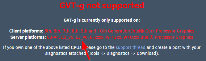

1635424977_2023-10-2214_16_30-Rodzina_intel-gvt-g-main.png.6cf82bc0125e48aea1aa88b900037c19.png
HP Proliant ML30 gen9, CPU Xenon E3-1275 v6 which is mentioned as supported.
I've spent a few hours checking BIOS for any related settings but can't find anything at all.
Any help investigating the problem would be much appreciated
Apparently those boxes have additional ancient `GPU` built in for ILO and this causes the problem.
Googled like crazy but I have not found any solution for this.
Attached diagnostics and hoping that someone can help solve the problem.
Strangely it works just fine on my other HP - Proliant ML10 gen9 with Xenon E3-1225 v5
Disable you ILO and the integrated GPU which is located on the motherboard and try again.

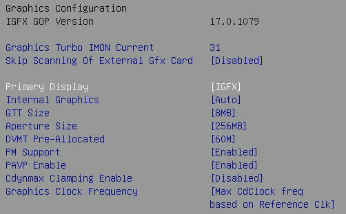

我的主板是华擎J3455-ITX,选择了板载显卡并在DVMT中设置预分配512M的显存,但是开启第二个设备的时候会提示
kernel: gvt: request 128MB avail 64MB max 128MB taken 64MB
明明分配了512MB却只有128MB可用,请问下该怎么解决?

If my Google translate translation is correct then I assume it's a bad implementation in the Firmware from the Motherboard and nothing that I can do about that.
Another question from my side, is GVT-g working on your motherboard? Usually only Core i series chips are supported.

另外我发现,无论我怎么调整BIOS里面显卡预分配的内存,从64M到512M,我通过lspci总是看到Region2中的内存的大小都没有发生改变,我之前看GitHub上面有issue说Region 2应该会有所改变的,不清楚其他的是不是这样。
00:02.0 VGA compatible controller: Intel Corporation HD Graphics 500 (rev 0b) (prog-if 00 [VGA controller])
Subsystem: ASRock Incorporation HD Graphics 500
Control: I/O+ Mem+ BusMaster+ SpecCycle- MemWINV- VGASnoop- ParErr- Stepping- SERR- FastB2B- DisINTx+
Status: Cap+ 66MHz- UDF- FastB2B- ParErr- DEVSEL=fast >TAbort- <TAbort- <MAbort- >SERR- <PERR- INTx-
Latency: 0
Interrupt: pin A routed to IRQ 130
IOMMU group: 1
Region 0: Memory at 90000000 (64-bit, non-prefetchable)
Region 2: Memory at 80000000 (64-bit, prefetchable)
Region 4: I/O ports at f000
在主板BIOS设置界面中,首页的状态页可以看到有多少共享内存预分配给了GPU,同时我用free命令去查看可用内存,这块的数量确实与预分配的显存存在数量差,内存减少的数量对应我增加的预分配的显存的数量。
