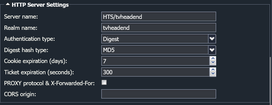

Confirmed that with the last update you can go back to digest auth mode.

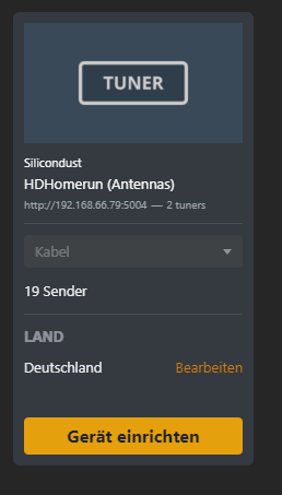

Antennas is running but Plex cannot see it. It can't see it, even with the IP address.
I have the same problem with tvhproxy. It was running fine for months but now it stops working.
So I changed to Antennas. But the same issue. tvheadend ist working fine and in the webgui I can start tv streams.
Did I miss a change in the Plex (1.28.2.6151)updates? Is it still working?
Edited by Schicksal
12 hours ago, Schicksal said:
I got it correct with the config.yml

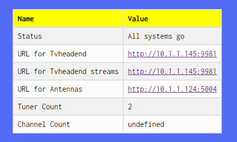

I have set this up with Tvheadend and on the Antennas pannel it doesnt show any channels.
Am I missing something?
Thanks,
Coen

Do you correctly created a user with streaming rights?
I believe so
6 minutes ago, CoBrad said:
I believe so
Can you see the channels from another PC on the same network using that user?

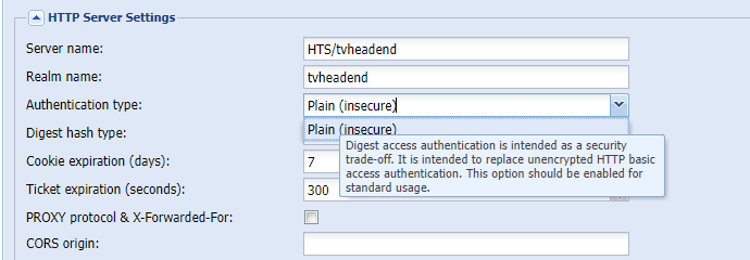

PD: I suspect you have to change the auth type to Basic (under Config > General > Base > HTTP server settings) as there is a compatibility issue of some libraries.
Edited by yayitazale
nope all i get is 403 Forbidden
Try to change the auth type of tvheadend to Basic (under Config > General > Base > HTTP server settings) as there is a compatibility issue of some libraries.
do you mean plain?
Just now, CoBrad said:
do you mean plain?
Not sure, I'm not using this for some time ago.
i am able to login the webpannel with the login but the channel count doesn't change
Restarting the container neither?
Restarted both and still nothing

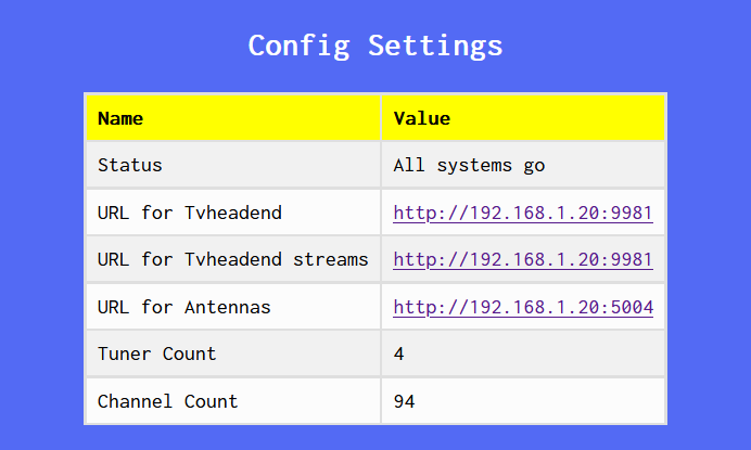

My working config:

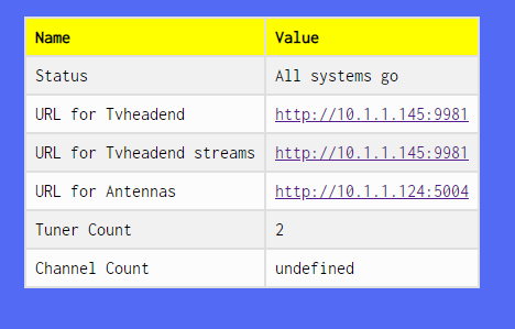

just curious what i may be doing wrong.  for some reason, the gui will show all systems go at one point, then at another point i get an undown error so i go to logs and see 403 error.  the same user and pass, i have also tried the * user with no pass and removed that from the yml.  somtimes it says 0 channels, sometime it says undefined.
can't help you with such little info.
