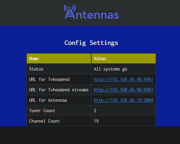

  • You just need to copy the "URL for Antennas" link into plex manual config and then click connect:

Hello,
i am getting only 4 channels out if 19 in plex:
Any ideas? 🙂
1 hour ago, S.P said:
Hello,
Any ideas? 🙂
I got it!
i had to give each channel a number in tvheadend:
Now i am getting all channels in plex 🙂
