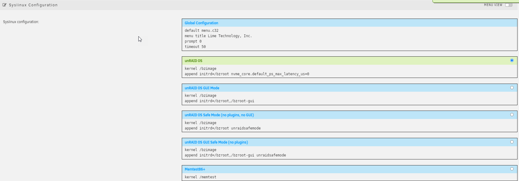

This sometimes helps, some NVMe devices have issues with power states on Linux, try this, on the main GUI page click on flash, scroll down to "Syslinux Configuration", make sure it's set to "menu view" (on the top right) and add this to your default boot option, after "append initrd=/bzroot"
nvme_core.default_ps_max_latency_us=0
e.g.:
append initrd=/bzroot nvme_core.default_ps_max_latency_us=0
Reboot and see if it makes a difference.
e.g.:

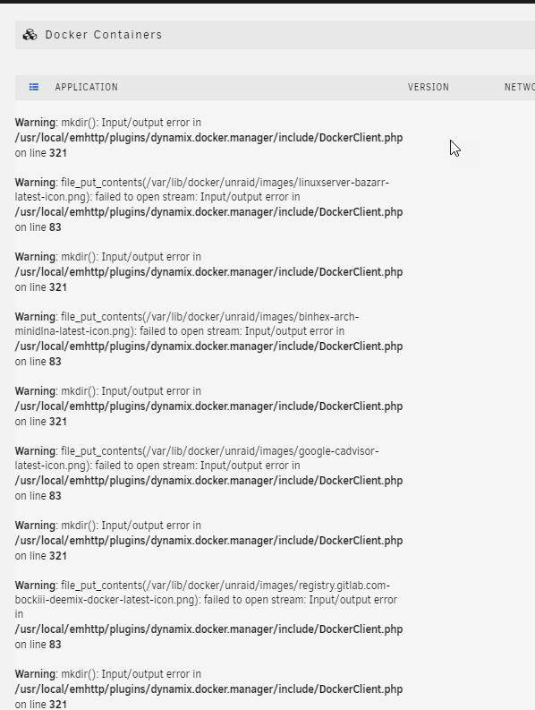

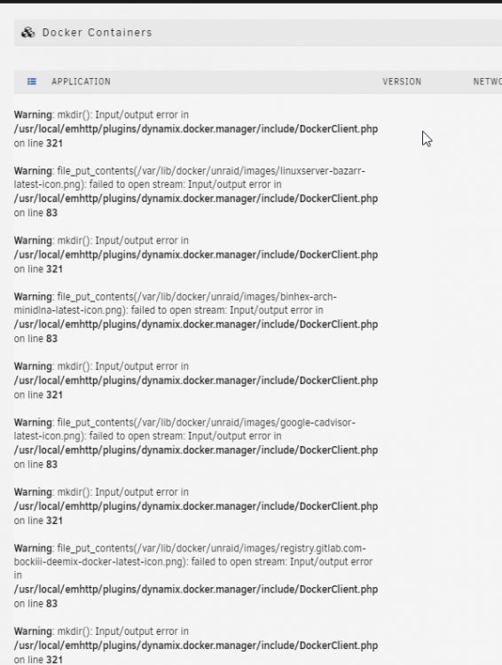

I added that and now my docker isn't starting at all.
Also the APP store has an error and stated to post in the community forums.
https://pastebin.com/LTk294hd
