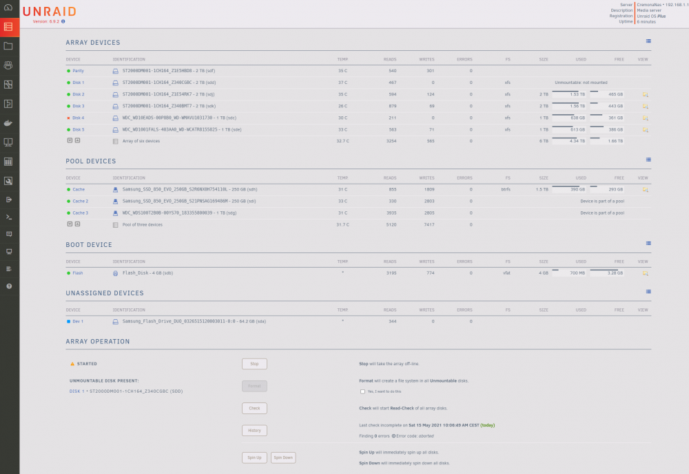

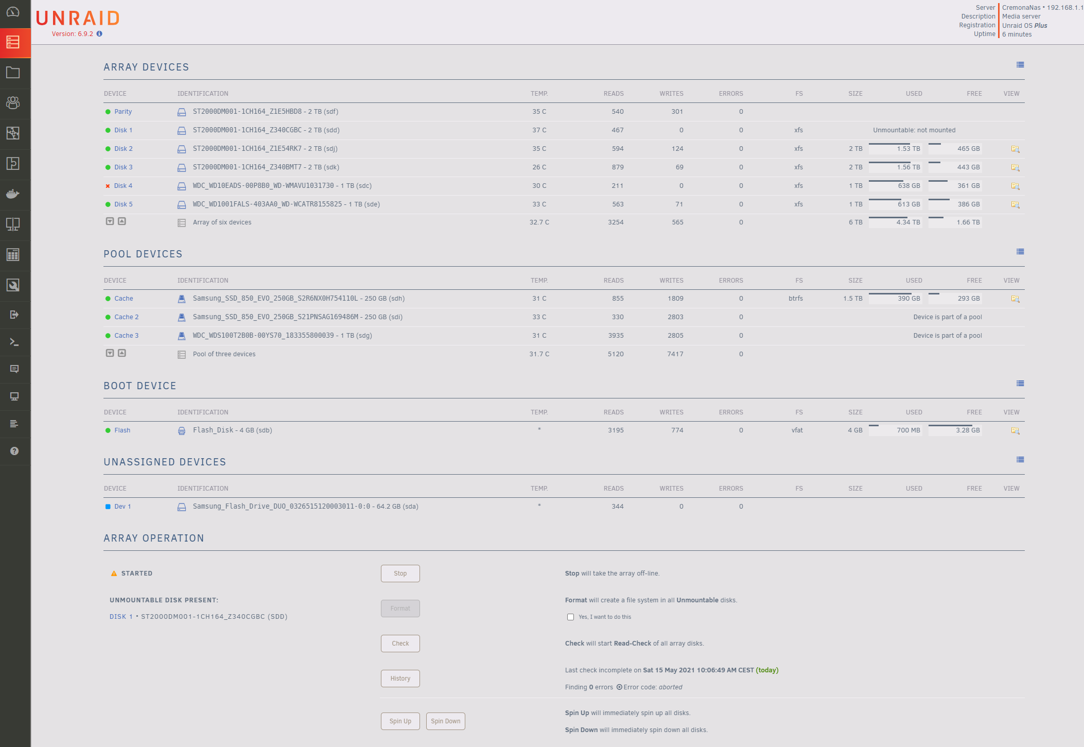

So I woke up today to two failed drives as per the below screenshot. The situation is as follows:

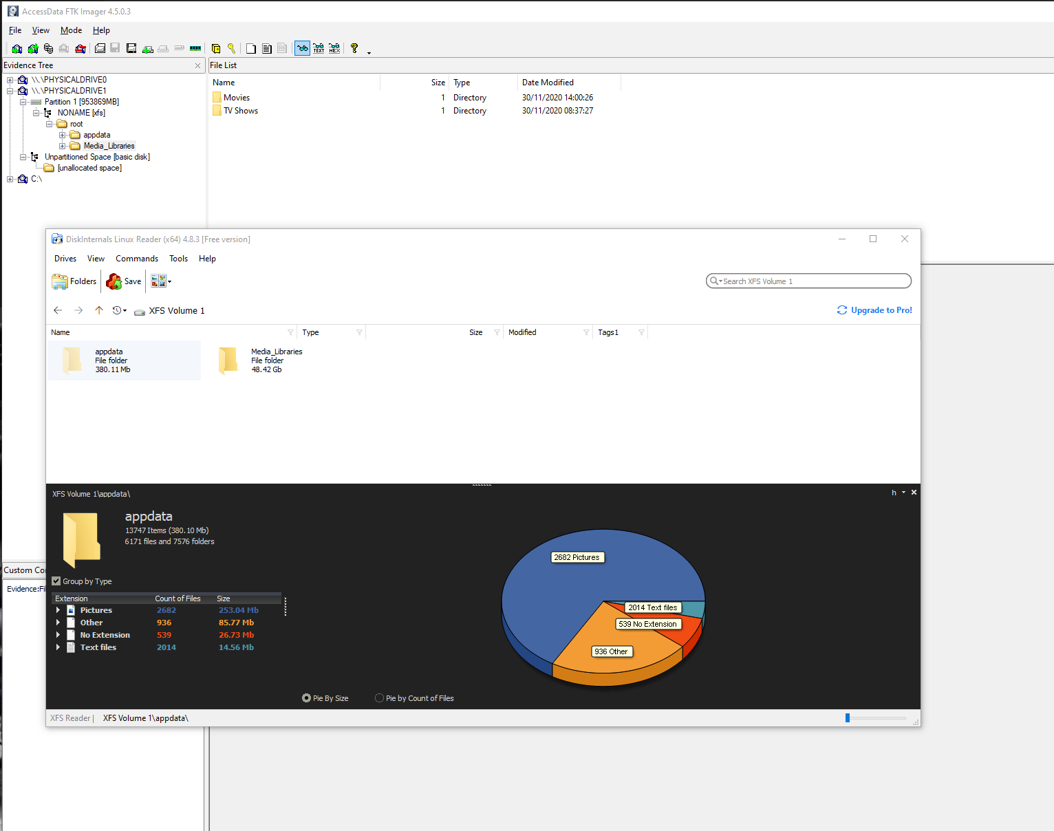

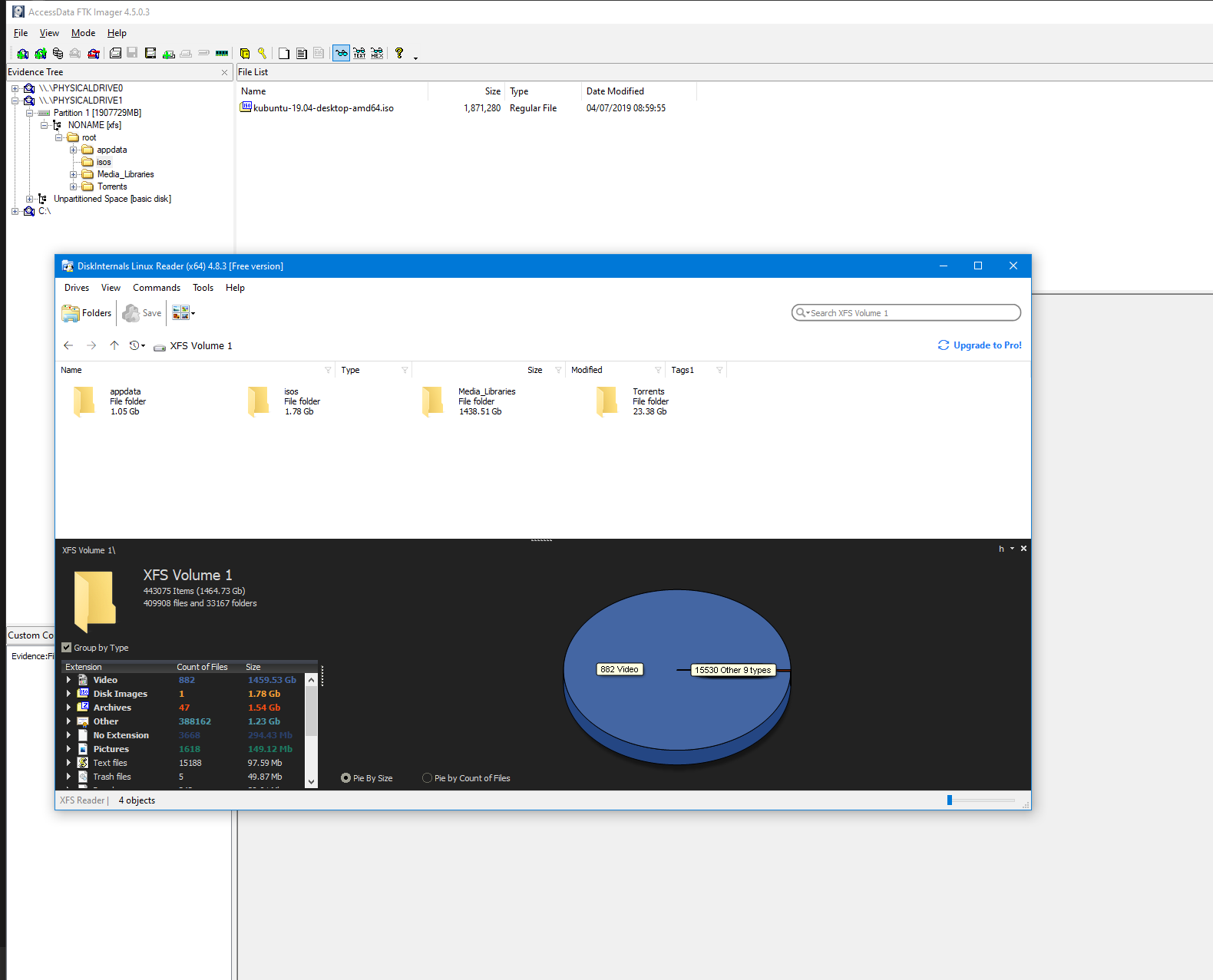

Disk 3 - marked "unmountable: not mounted: I have connected it via USB HDD dock to my windows laptop. Both FTK Imager and DiskInternals LinuxReader are able to access the drive and show me the folders and files on it, although not sure if the data is actually readable, but folder structure seems intact.
Disk 4 - Shown as failedBoth FTK and linux reader are showing me the filestructure of this drive.
Since there are two failed drives, I can't mount the array, not even in maintenance mode. So what are my options here to try and retrieve the data and rebuild the array?

Run a filesystem check on disk1, disk4 appears to be really failing, you can run an extended SMART test to confirm, if it fails replace.

Since you can see the contents of the disks on another system, copy a couple items out to spot check their viability.
If good, copy everything/clone the drive(s) to new one(s).  Now you'll at least have a copy.

Don't understand what you mean, disk1 is unmountable but enable, disk4 is disable but mounting.

Disk 1 happens to have just media files. I connected the disk directly to a windows PC and with FTK imager exported some of them, however neither media player classic nor VLC are able to playback these files.
I have now remounted everything in my unraid server and using teracopy to move everything to a local hard disk and waiting to see if this allows me to open the files this way.
Disk 4 was just added to the array but I never actually had anything stored on it if that helps.
