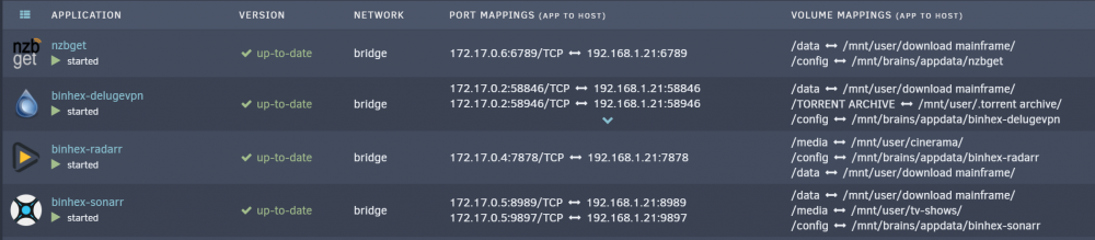

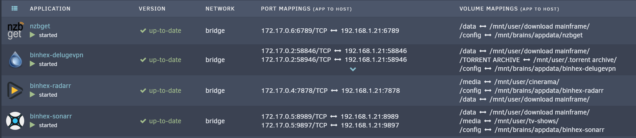

- screenshot with the mappings of Deluge, NZBget, Sonarr and Radarr in Unraid.

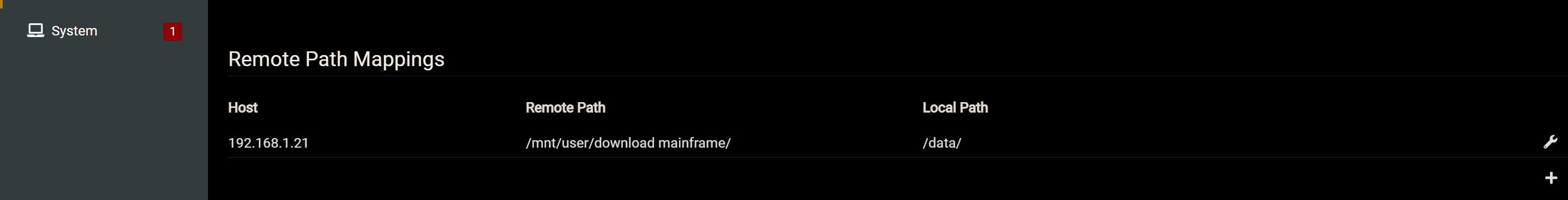

- screenshot of the Remote Path Mappings within RADARR

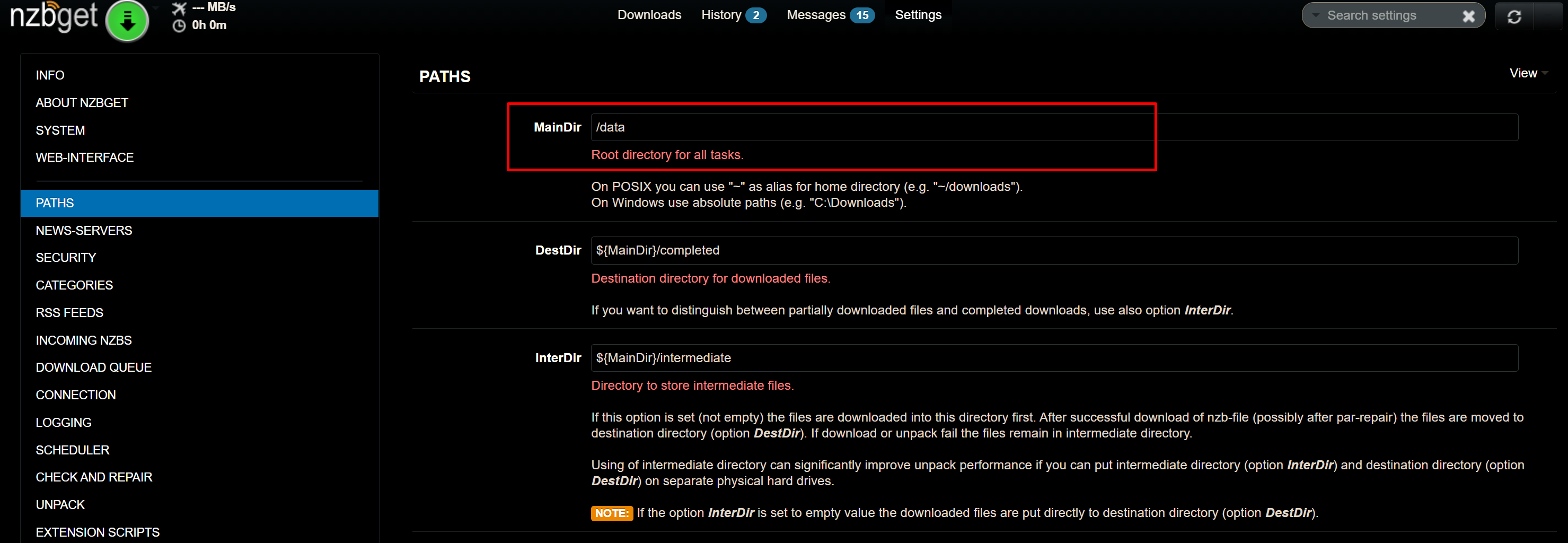

- Screenshot of the 'path settings' withing NZBget

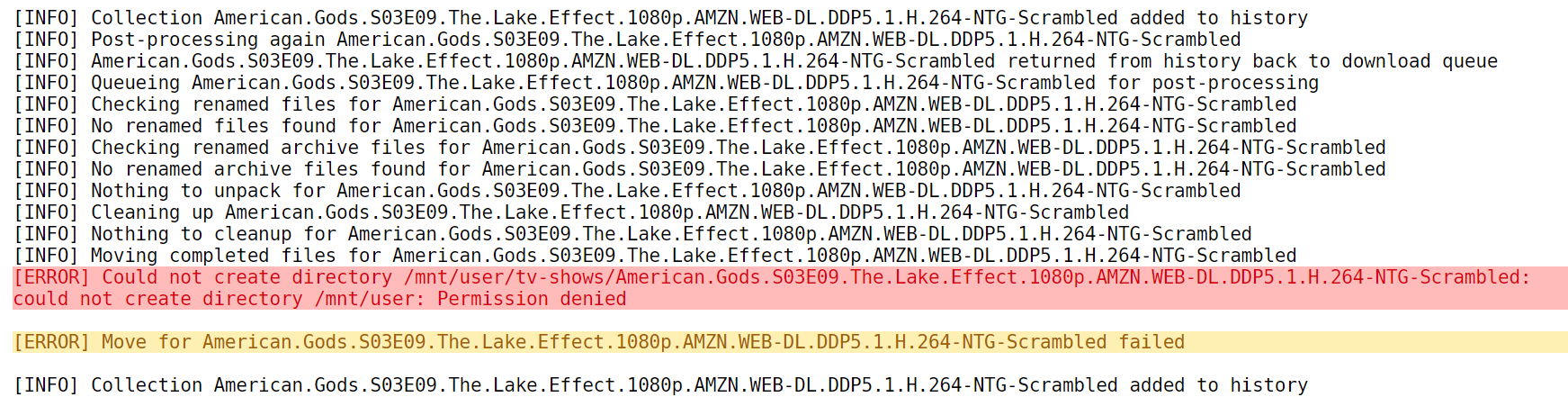

- Screenshot with an error from NZBgetlog.
NZBget is telling me there is an permission issue: could not create directory in /mnt/user: Permission Denied.

nzbget seems to be trying to write directly to your /mnt/user/tv-shows, it should be going to /mnt/user/download mainframe/completed/tv-shows where Sonarr can pick it up.
Also in nzbget/sonarr/radarr,  the default setup has /downloads already setup and you just add the path. If you changed it to /data for all of them make sure Access Mode is read/write slave.
Somewhere you have a mismatch between them. Make sure your categories are the same for each and do you really need a remote port mapping if it is all within unraid?
*If you can post a screenshot of your unraid Sonarr docker config and also one of your nzbget settings/categories screen

You never need to use remote mapping.  You only use it when it's impossible to get the paths on the template correct.
Remove the remote path mapping
16 minutes ago, FastEddieP said:
hmm without seeing other config screens....
I fully understand it now. Thank you Squid!
