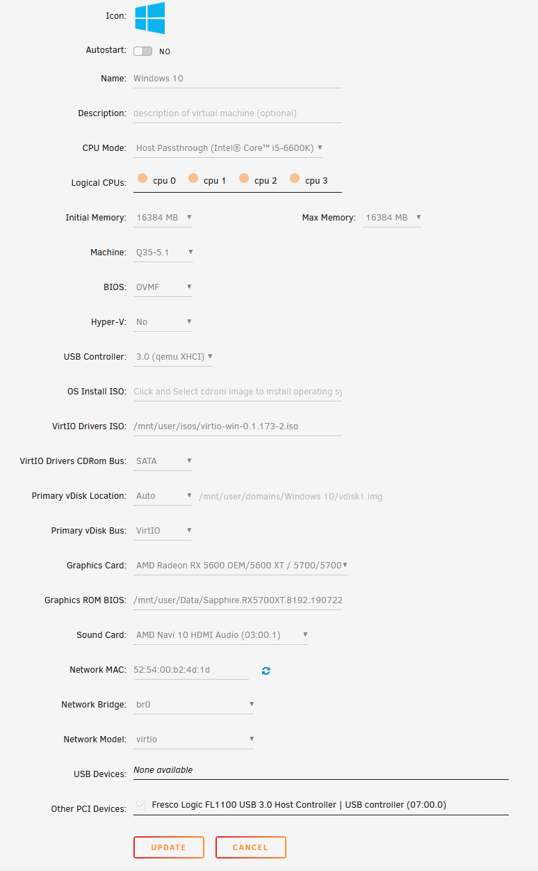

i was using my Windows 10 VM a coule of months with no problems including a passthrough 5700 XT. A TV is directrly connected to the Card using HDMI. A seperate USB Card is also being passed through.

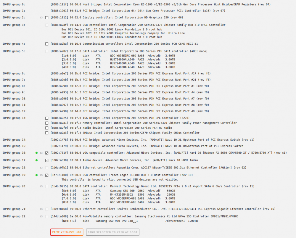

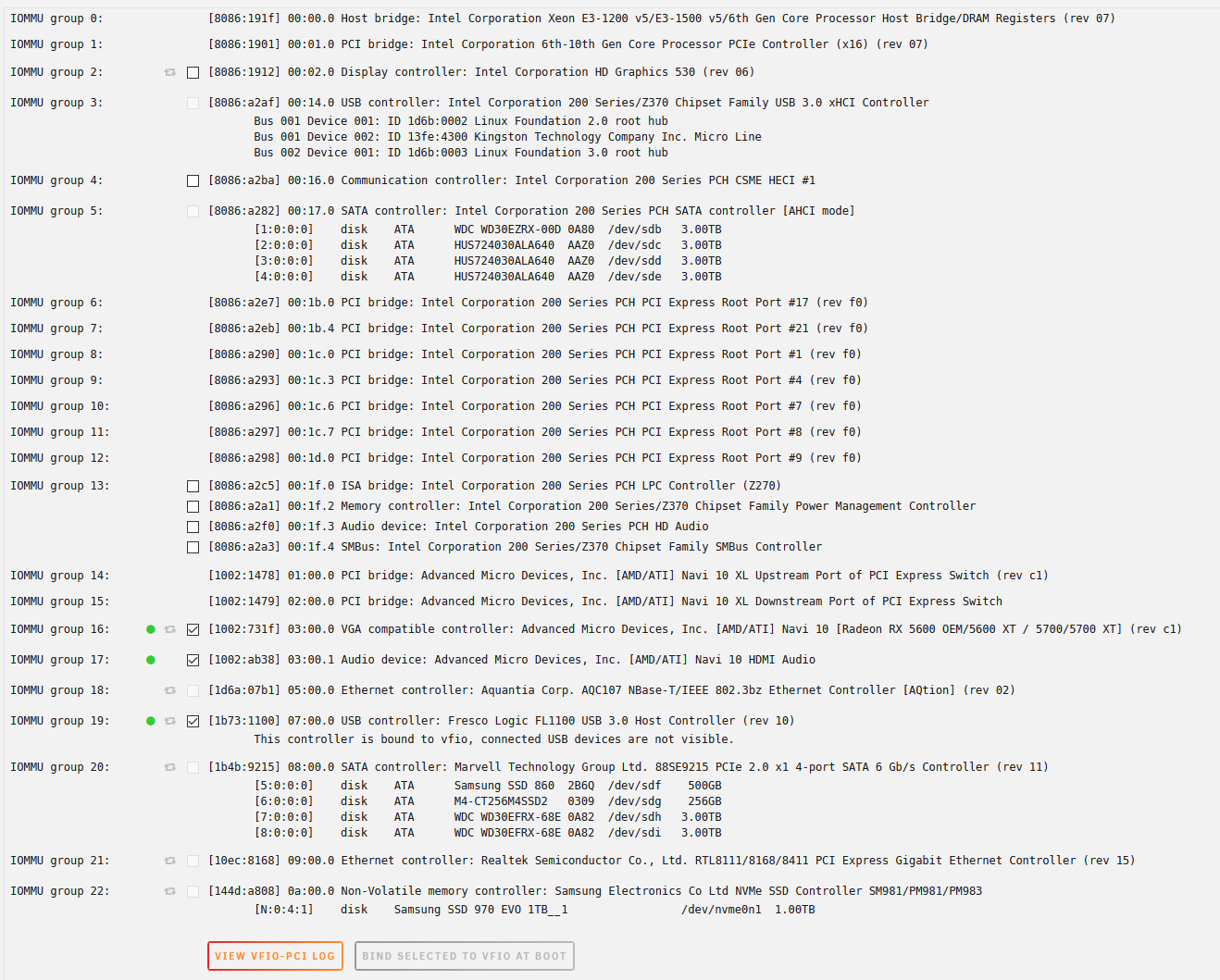

Corrently in BIOS i have iGPU / dGPU on auto. Nothing is attached to the MB's HDMI. VT-D and above 4G decoding is enabled.
The 5700 XT and its sound counterpart are selected for passthrough in IOMMU Settings.

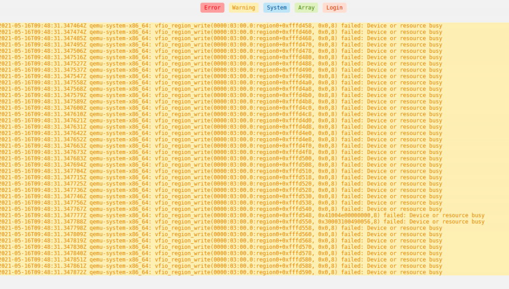

Video Output on Graphic Card showes "Tiano Core" and i can Remote desktop into it.. 5700Xt showes Error in Hardware manager..

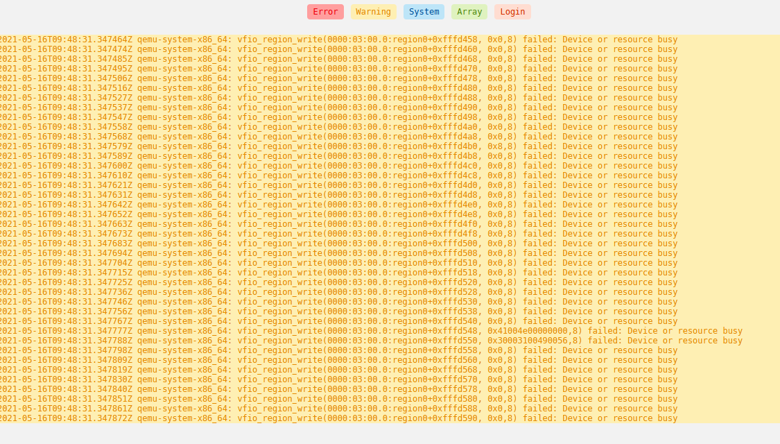

The log shows that the dgpu is used by the os so it fails to pass it through, I would change that bios setting, to have igpu as primary.
Thanks, that alone didnt help but blugging an HDMI fake donge into graphic card at least lets it show up in Windows via parsec again. I need further testing if it stays on monitor
