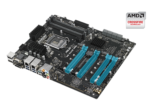

ASUS WS C246 PRO ATX Server Motherboard LGA 1151 Intel C246 (there is AsRock Rack C246 WS 8 sata CPU & 4 sata other chip)
Intel Xeon E-2288G (with iGPU can you transcode Plex and use the Video out at the same time?)
64GB ECC DDR4 (16GB x 4)
Not sure why ASUS says AMD Crossfire when it is Intel?

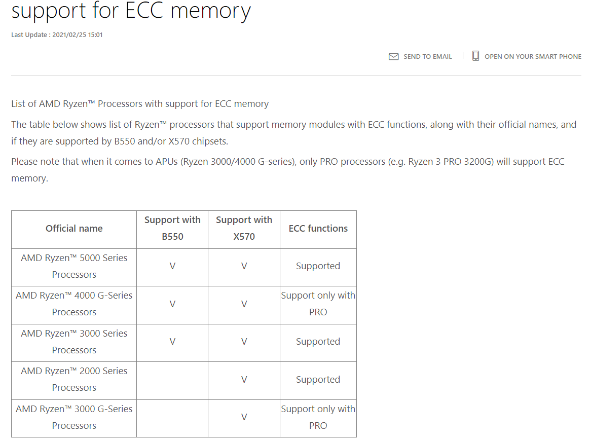

I am still lost what to get??
Was just searching the Ryzen and ECC memory and I got this from an ASUS site.
