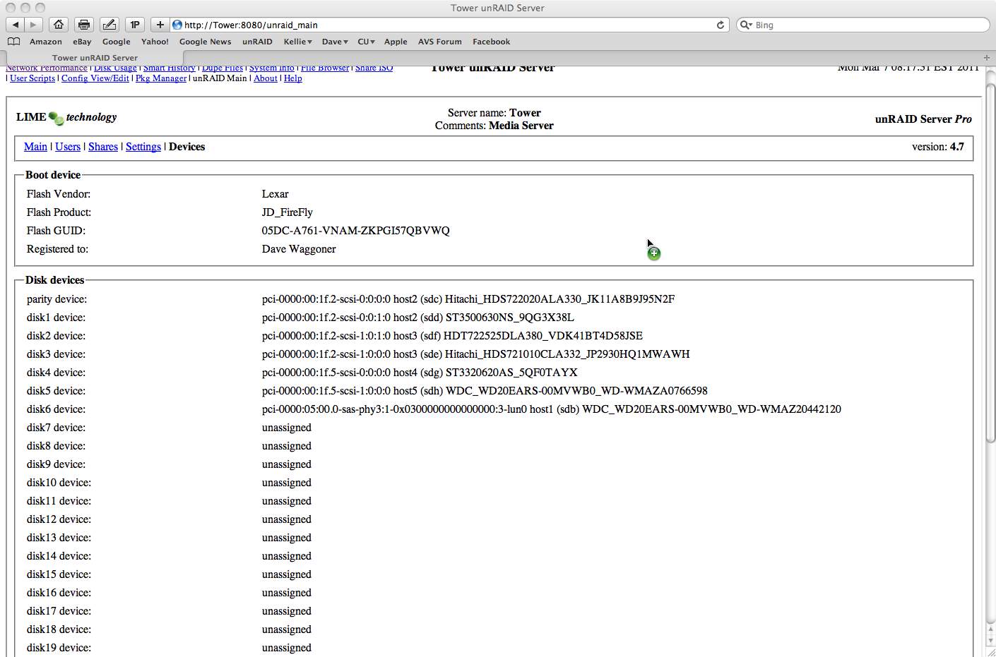

So I just need to make sure I assign them like this, right?
I just re-arranged some cabling and moved some disks around and it says PARITY is valid.  However if you look at the screenshot from above disks 5 and 6 are now actually disks 1 and 2 but unraid still shows them as 5 and 6, is there away to change this?
Just put them back on the devices page.
If you want to move the hard drives to different disks then you need to do an initconfig to reset the array.

First of all, unRaid will allow you to swap 2 disks between 2 in use slots. You just have to click a check box to start the array. Second, if you want to do wholesale rearranging, you can stop the array, rearrange the disk order, and then use the "Trust" procedure documented in the wiki.  No new parity sync required!
