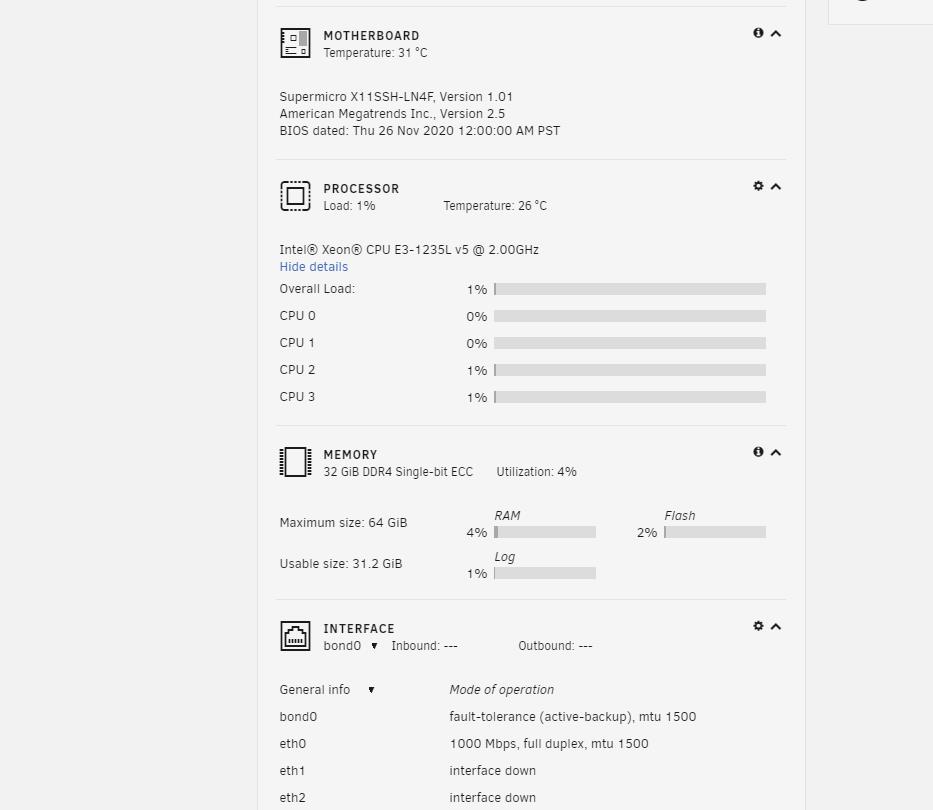

supermicro x11sh-ln4 E3 1235l V5 ECC 18G The test results is perfect!
In addition, there is another possibility:
gen8, to turn off rmrr verification, you need to add Intel IOMMU = relax rmrr in the U disk startup
Thank you for the testing results with your X11SSH-LN4F. I'm happy to learn it is working properly. This could indicate a hardware issue on my end or I might still be facing a kernel bug. I'll keep researching.
