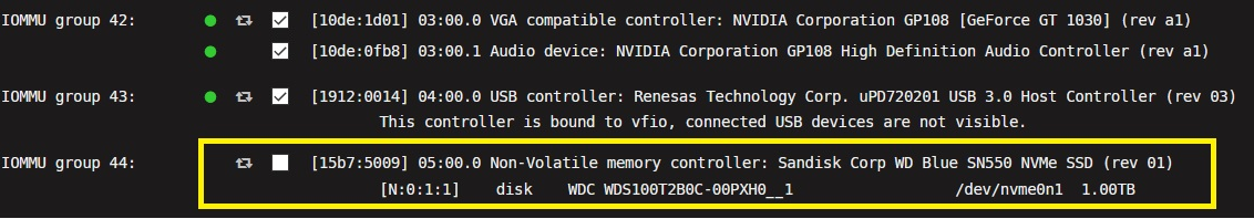

Below is a screenshot of my System Devices IOMMU list.  Inside the YELLOW box is my NVMe device. Just to confirm I understand you correctly. To successfully PassThrough my NVMe and load it with a LinuxMint.iso image I first need to apply a Checkmark and then hit the "Bind Selected to VFIO At Boot" button and reboot my server.
I then need to manually add my own version of your XML code shown below so that my VM boots correctly. What numbers shown in the YELLOW box above do I paste into your XML code below so I can make it my own?
  <boot order='1'/>
      <address type='pci' domain='0x0000' bus='0x06' slot='0x00' function='0x0'/>
Nevertheless, what is not yet clear to me is once I add my custom XML code does it cancel out the need to manually add a path to "Primary vDisk Location" parameter shown below circled in RED?  In short, it's still not clear to me where in the UnRaid OS can I see the NVMe path I need to copy and paste into the "Primary vDisk Location" parameter shown below circled in RED?

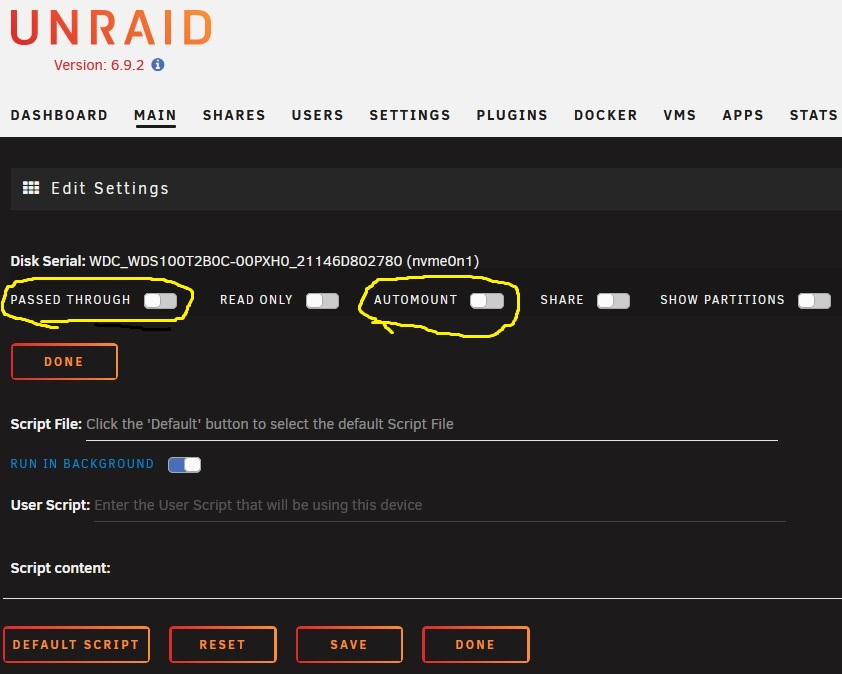

SimonF,

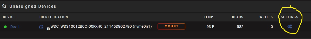

I'm not adding my NVMe device via my Unassigned Devices app therefore  the path:  /mnt/disks  does not apply.
Additionally, I'm not adding my NVMe device via a pool so the path:  /mnt/pool name  also does not apply.
The answer is I am adding my NVMe device as a passthrough to mount a LinuxMint.iso image to run as a VM.  Do you know what is the path I need to paste into the RED circled parameter shown above?

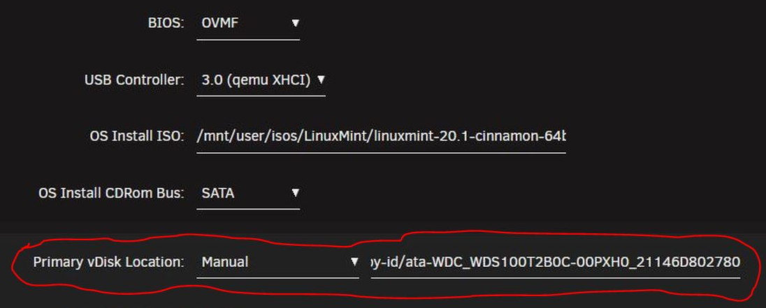

There's no need to block that device in "System Devices" or to use XML. The device is listed in that directory:
ls -lisa /dev/disk/by-id/
1.a) If you want to passthrough the complete device, copy the complete name leaving the "-partx" suffix off (if it does exist). From that build the complete path. Eg.:
 1747 0 lrwxrwxrwx 1 root root   10 May 18 07:05 ata-HGST_HUS724020ALA640_PN2181P5H1E36X -> ../../sdbp
--> /dev/disk/by-id/ata-HGST_HUS724020ALA640_PN2181P5H1E36X
1b.) If you want to passthrough a partition from that device only, copy the complete name including the "-partx" suffix. If there's no suffix, this device has no partition and you can passthrough the complete device only (see 1a.))
 1747 0 lrwxrwxrwx 1 root root   10 May 18 07:05 ata-HGST_HUS724020ALA640_PN2181P5H1E36X-part1 -> ../../sdbp1
--> /dev/disk/by-id/ata-HGST_HUS724020ALA640_PN2181P5H1E36X-part1
2.) Put the resulting path in the field you found already (shown in the image above). You can use "VirtIO" or "SATA". This has effect how the device is named in the VM (e.g. vdb vs. sdb). I use VirtIO always, but it may not work depending on the use case and the Operating Systems. "SATA" is save and should work always.
3.) If Unassigned Devices is installed, this device will be shown there too. It has an option "Mount" then. DON'T HIT THAT BUTTON! Click on the blue "Edit Device Options And Script" instead. On the page shown now, click "Passed through" and hit "Apply". This will make the "Mount" button unavailable.
That's all.
Edited by hawihoney
Hawihoney,
Thank you very much for your post.  If I compare my initial test path I posted in my very first post at the top to the example path you posted they seem to have this much of the path text in common:  "/dev/disk/by-id/ata-"
Below is a side by side comparison -
My PATH Tests:
/dev/disk/by-id/ata-WDC_WDS100T2B0C-00PXH0_21146D802780 (nvme0n1)
Your PATH Example:

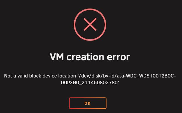

I suspect the reason I got the error shown below after hitting the CREATE button in the ADD VM form is because I hit the MOUNT button on my Unassigned Devices app for the NVMe device it shows after I performed a XFS format on it.
Nevertheless, it is good to know there is no need to apply a checkmark to IOMMU Group 44 shown above in a YELLOW box and   I will try again on Friday and hopefully by unmounting my NVMe device from my Unassigned Devices App I will not get the error shown below.

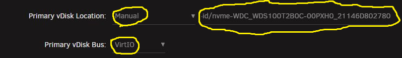

I have carried on with my troubleshooting regarding this matter and I am glad to say this problem has been solved.  Below are the steps I performed. Again, thank you to Hawihoney and everyone else who contributed to this thread.
  1. I unmounted my NVMe drive from my Unassigned Devices app. In short, my UD app now shows a "MOUNT" button for my NVMe drive.
  2. I opened my UnRaid Terminal and entered this command:  ls -lisa /dev/disk/by-id/
  3. From the list shown in the terminal I tracked down my NVMe info and then concatenated this path text string: /dev/disk/by-id/nvme-WDC_WDS100T2B0C-00PXH0_21146D87862
  4. I created a new Linux Mint VM and changed the vDisk Location parameter to "MANUAL" and pasted this path: /dev/disk/by-id/nvme-WDC_WDS100T2B0C-00PXH0_21146D87862
  5. I hit the "CREATE" button and the result was my Linux Mint OS installed onto my NVMe drive as a Virtio image.
  6. Glad to say my Linux Mint OS operates a lot faster compared to the previous configuration I was using.
That was it. No need to BIND my NVMe device in the System Devices VFIO list or make any XML edits.
Again, thank you to all for your help and I hope this thread helps out somebody in the future with a similar problem.

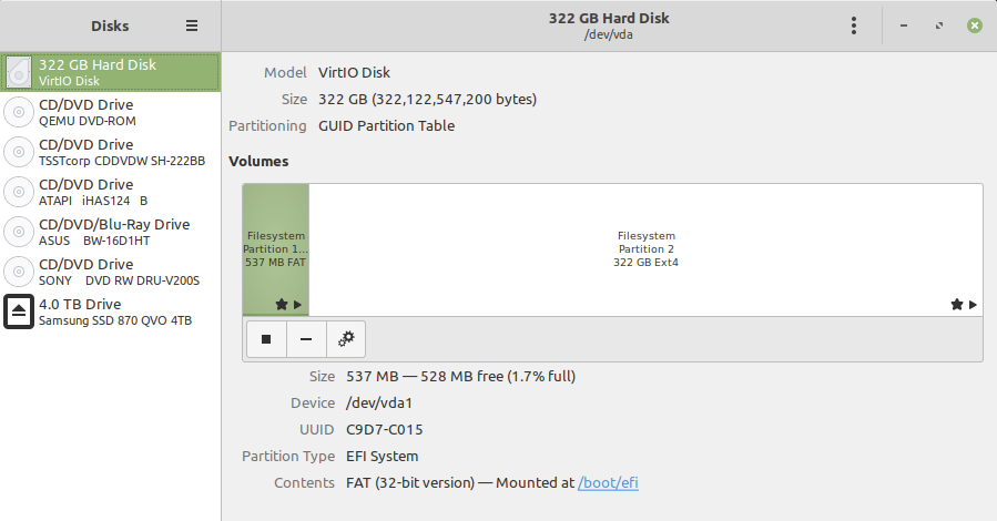

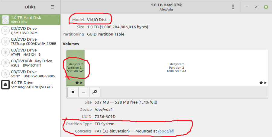

Thank you for your post.  You are correct, my goal is to have my NVMe split into three partitions so I can install Linux Mint, Windows 10 and Mac IOS to each partition. However, due to my lack of experience I think I messed it all up.  Below is a screen capture of my Linux Mint "DISKS" window which shows how my 1TB NVMe drive is currently situated with the Linux Mint OS.
I do not understand why it shows FAT 32 being that my LinuxMint ISO image I downloaded is 64bit?
That is the EFI partition: you installed Linux with ovmf bios, so you did a UEFI installation, this means that during installation you created 2 partitions: the EFI partition (formatedd as FAT32) to boot the os and the ext4 partition for the regular linux.
As shown below I selected "VirtIO" in the Create VM Form. Does that look correct to you?  How do I avoid the problem of not installing Linux Mint on a Virtio Image?
There are many ways to passthrough a "disk" to a virtual machine.
In general, a disk is attached to a controller and the controller is attached to your motherboard.
1. What you did is passing through a real disk (the whole disk, because you didn't passed through a partition "-partx"), but attached to a virtual controller (virtio in your case).
2. Another way is to passthrough only the partition to the vm (so in the manual path you need to add -partx, where x is the partition number): in this case your linux has 2 partitions, as I wrote, the EFI and the ext4, so you need to add 2 disks, one pointing to the EFI partition, with boot order 1, and the ext4
3. Another way is to pass through the controller, instead of virtualizing it, no need to add the disk(s) part to the vm, the controller is a pci device, and by passing through the controller the virtual machine will automatically see the disk attached to it.
4. Another way is to install virtual machines on virtual disks: in this case you mount the nvme drive with unassigned devices, and the whole nvme drive will be mounted in /mnt/disks; once it's mounted you can save the disk image (vdisk1.img for example) in the path on the mounted nvme drive.
In this last case you will virtualize both the disk (because it's a virtual disk image) and the controller.

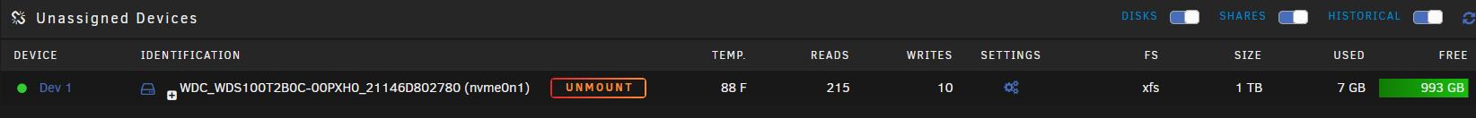

Ghost82,
Thank you for your three recent posts. I deleted my NVMe's two partitions and then formatted and mounted my NVMe using my Unassigned devices app.
Below is the terminal text I got after running the "ls /mnt/disks/" command inside my UnRaid terminal:
root@tower:~# ls /mnt/disks/
WDC_WDS100T2B0C-00PXH0_21146D802780/
root@tower:~#
Below is the LOG file my Unassigned Devices app generated. It summarizes how my NVMe is now newly formatted:
May 25 21:44:26 tower kernel: nvme0n1: p1 p2
May 25 21:45:15 tower emhttpd: WDC_WDS100T2B0C-00PXH0_21146D802780 (nvme0n1) 512 1953525168
May 25 21:45:15 tower emhttpd: read SMART /dev/nvme0n1
May 25 21:57:54 tower unassigned.devices: Removing partition '2' from disk '/dev/nvme0n1'.
May 25 21:58:26 tower unassigned.devices: Removing partition '1' from disk '/dev/nvme0n1'.
May 25 21:58:31 tower kernel: nvme0n1:
May 25 21:59:49 tower unassigned.devices: Device '/dev/nvme0n1' block size: 1953525168.
May 25 21:59:49 tower unassigned.devices: Clearing partition table of disk '/dev/nvme0n1'.
May 25 21:59:49 tower unassigned.devices: Reloading disk '/dev/nvme0n1' partition table.

Lastly, the screen capture below shows how my NVMe disk looks iike after mounting it to my Unassigned Devices app:
Just to confirm.  You explain 4 different ways to passthrough a "disk" to a virtual machine in your post above. Is your #4 description the approach you are using for my NVMe setup?
Again, thank you for your time.

Ghost82,
Just wondering if you can clarify the following. Currently I have to manually click on the Unassigned Devices "MOUNT" button before I start my VM. If I don't do this my VM gives me a path error message and fails to start.  So I looked into how I could configure my NVMe settings so it auto mounts itself.  By clicking on the blue button circled below in YELLOW the UnRaid OS shows you a DISK EDIT Settings window where I discovered  some settings I hope you can comment on.
Regarding the PASSED THROUGH slider button shown below circled in YELLOW.  Is it necessary to activate this PASS THROUGH button?   Hawihoney in his post above advises to activate this PASS THROUGH button but not sure if I should because his NVMe Install approach differs from your NVMe install approach.
Regarding the AUTOMOUNT and SHARE buttons. I am planning on activating the AUTOMOUNT button because I want the NVMe drive to automatically mount itself after my UnRaid system powers up.  And as for the SHARE button I don't plan to activate this button out of security concerns.  I look forward to reading any opinion you may have regarding these buttons shown in the screen capture below.
Lastly, the screen capture below shows my 1TB NVME correctly partitioned to 322GB.  This differs from the DISKS screen shot shown in my previous post that shows the entire 1TB drive space occupied by my Linux Mint OS.  Thanks again for your help which got me past this NVMe partition sizing problem.  I plan to repeat this partitioning process for the  Windows10 and MAC OS installs with a few changes.    Thank you for your time.
Edited by slipstream
Hi, all you need is automount set to be active.
For your case you are not passing through the nvme drive: the drive must be seen in unraid and your vm save files in a virtual disk on unraid, not on a disk on the virtual machine itself.
With the share button you share the nvme drive through smb (samba) for example. May be useful if you want to explore from the virtual machine the nvme drive; if you activate the share button and you have a bridged connection you can connect via smb from the vm to unraid and mount that nvme drive and you will see the lnxdisk.img file, or whatever file you saved inside the nvme drive.
Edited by ghost82
