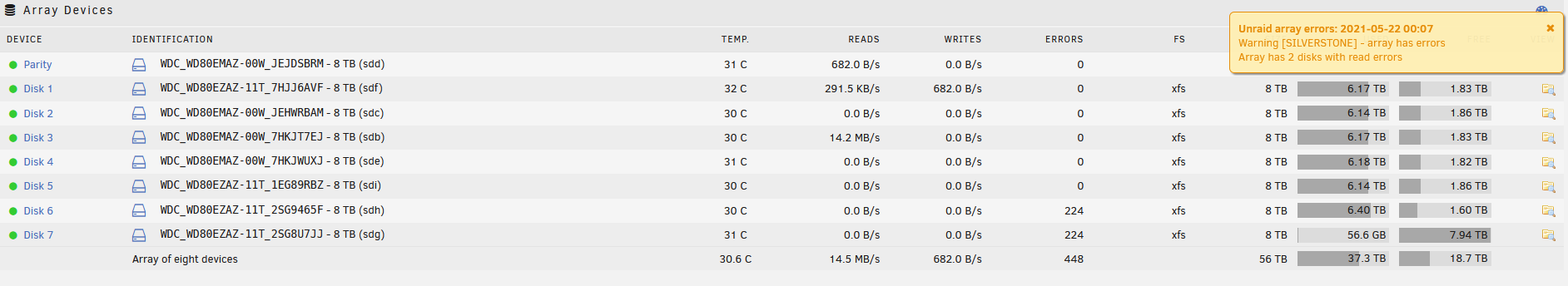

(solved again) Array has 5 disks with read errors.
As the title says.
Screen shot shows the discs, diagnostics logs included.
silverstone-diagnostics-20210518-2122.zip

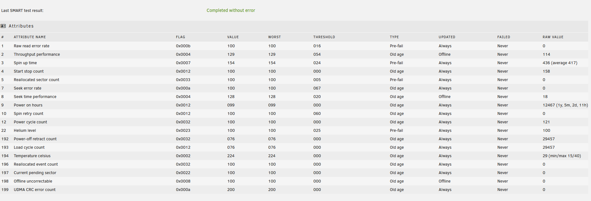

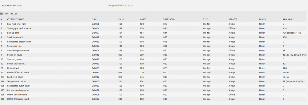

I put Unraid in maintenance mode and ran a short smart test on Disk 3 it completed with no errors.
1352393918_2021-05-18_21.35_Unraid-disk3aftershortSMARTtest.thumb.png.df086e7ef3242beca3df955b76939e9e.png

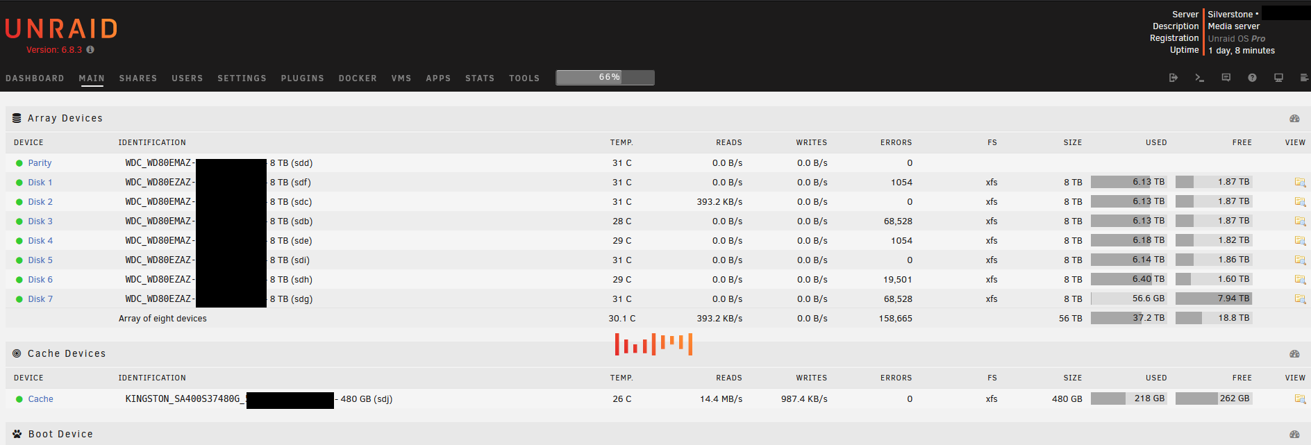

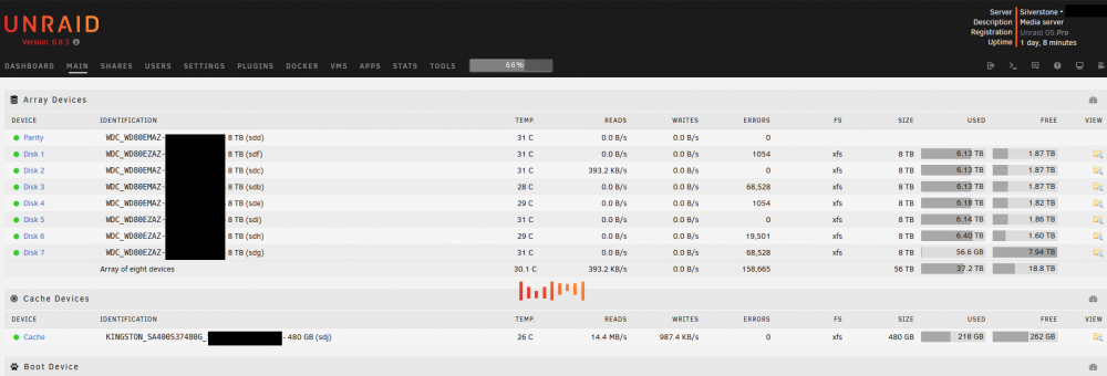

Oke it got worse i finished the Parity check with no errors and then tried to start the array normally now i have 6 unmountable Disks.
That is every Data Disk except Disk 5...
Edit: i included new diagnostics
silverstone-diagnostics-20210520-2253.zip1902219284_Schermafbeelding2021-05-20225605.thumb.png.f254e1f94bed2dddf29ecbae19b7f2d9.png

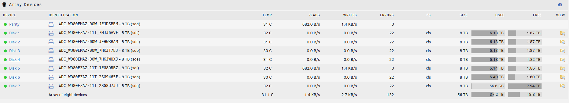

How should i handle the 22 errors that 6 Disks are reporting?
Rebooting will clear them.
