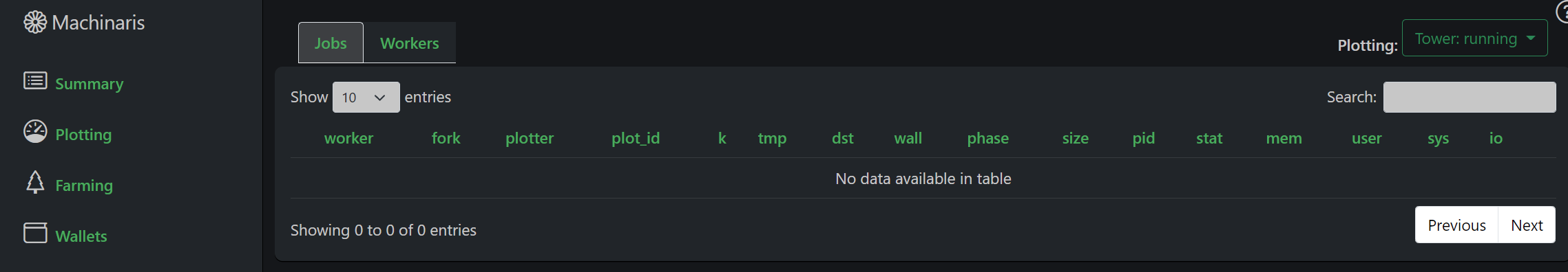

This is how Macharis looks on the plotting page, stopping and starting the container does not work, it remains in this state:
After restarting the container after 15 minutes or so the status changes to "stopped" and I am able to restart the plotter (but after one plot it will fail again)
My CPU is running on 50% load (E-2146G CPU) and my memory is at 64% utilisation (64GB)
Any idea ?

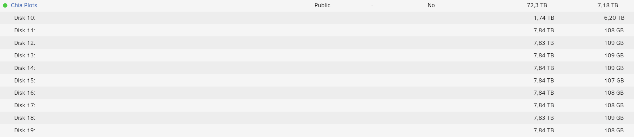

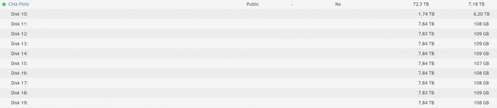

Yeah it was really super weird... Because this is the unraid forum a bit more context for the unraid people:
I had 9 8TB drives in the array only allocated to chia plots. I added a new drive to that share, another 8TB one. Plotting refused to work..
I tried messing with the minimum space and allocation method to make sure that did not work out the wrong way (although I have been working with unraid for a long time and I do not think I would have made an error there).
What worked in the end is removing all existing Chia drives out of the Chia share and keeping only the new drive, that works...
That is not an issue also since the plots are still perfectly readable and the shares are not written to while farming..

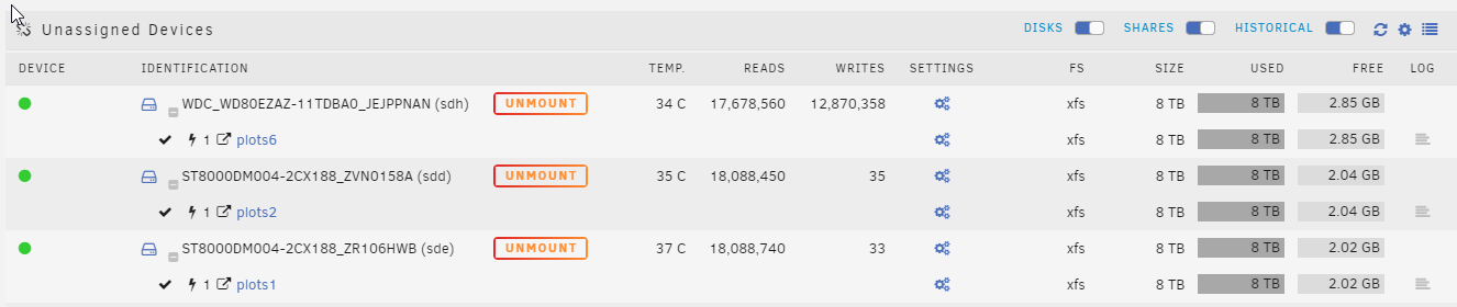

Can I pass an unassigned device/disk to machinaris to farm on?
I have started to add some external USB drives and I don't think I'm supposed to put them in the array, but i'd like to use them for farming.
If it's possible, how are they added because they won't be in a share.
thanks.
thanks.

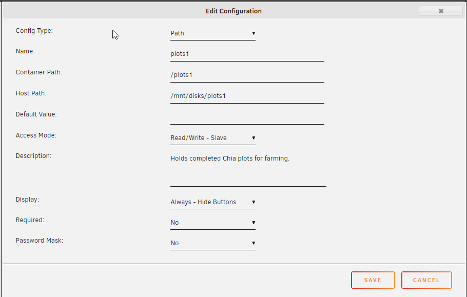

Yes, it's possible to:
1) Plugin the external drive to your Unraid tower.
2) In Unraid UI, format the drive, then mount as an Unassigned Drive.  I mounted mine at "/mnt/disks/plots1", "/mnt/disks/plots2", etc.
3) Then Unraid UI | Docker tab, Machinaris container, add Path mount like "/plots1", "plots2", etc in the container.
Screenshots from Unraid UI:
Hope this helps,
Guy

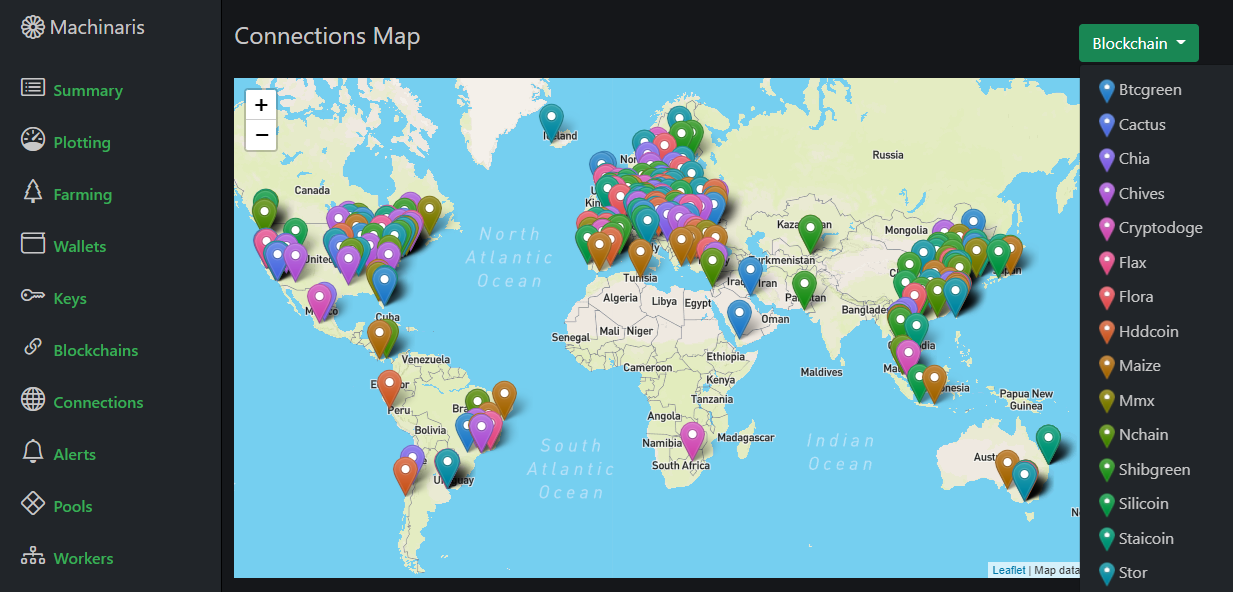

Good day! Machinaris v0.7.0 is now available.
Changes include:
 - Chia v1.3: please note reports of issues in this new Chia release...  double-check your Wallet, Payout, and Pools settings after upgrading!
 - Internationalization for locale-specific text, numbers, and currencies.  Huge thanks to @antcasq (pt_PT) and @fabriziocacicia (it_IT) for providing translations!
 - Geolocation of peer connections for each blockchain by their IP address. Optionally enabled using a free Maxmind account.
 - Silicoin - supported again as per Discord votes.
