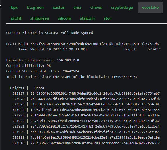

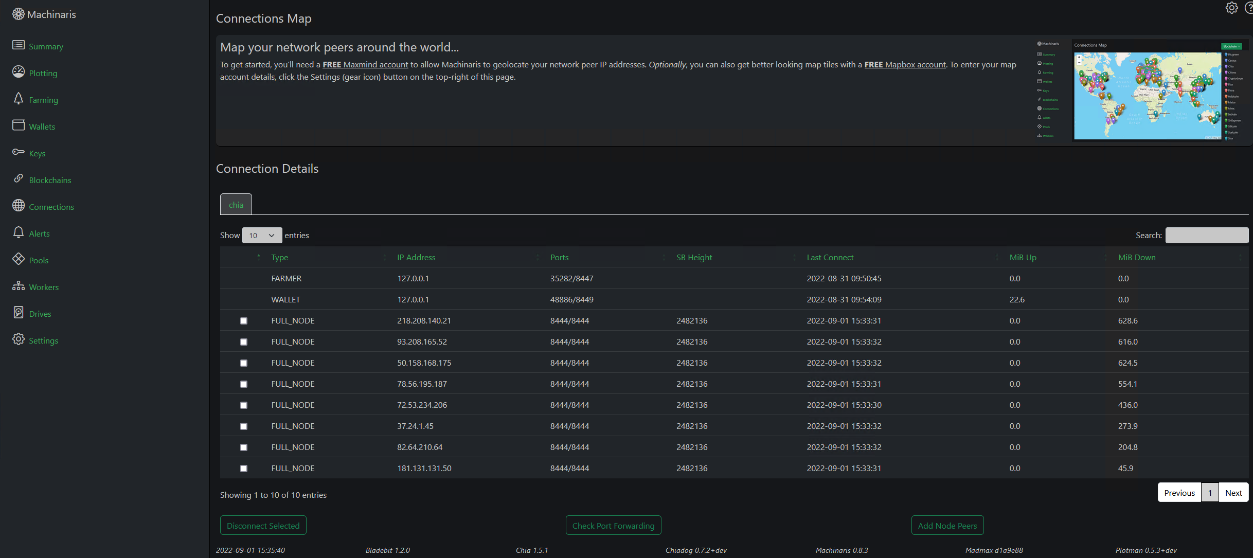

Yes, I have ecostake synced.  As a Chia fork, I think IPv4 is fine.  See attached screenshots.
Please try the v0.8.1 improved 'Add Node Peers' button on the bottom of the Connections page, for the Ecostake tab, which will automatically add about 10 peers from the AllTheBlocks list.  Hope this helps!
Adding the nodes through the button worked like a charm.
Thanks!

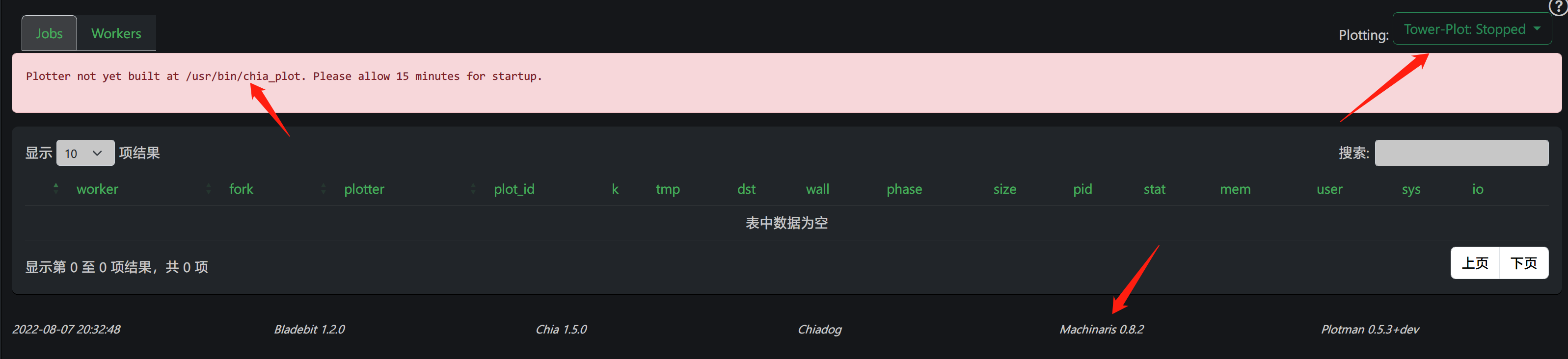

Hello,
first of all - great work and thank You very much for making such great tool :)
Now - I would like to ask for help - today I updated both my machines to latest Machinaris container, but since then I am unable to plot - both machines just say:
Plotter not yet built at /usr/bin/chia_plot. Please allow 15 minutes for startup.
One machine says this for hours now. I tried fixing the second machine - by force updating, reinstalling the container, and also by installing Machinaris in plotter-only mode as new container with fresh appdata folder. No luck :/
Before I had Unraid 6.9.2, now I tried to update to 6.10.3, did not help.
Thank You very much in advance for help!
Edited by 666sniperererer
Thanks of the kind words.  Apologies you encountered this issue with Machinaris v0.8.1 due to a global expiry yesterday of Ubuntu support for our base image.  I hope to have a fix for this available as Machinaris v0.8.2 later today.  Thanks for your patience.

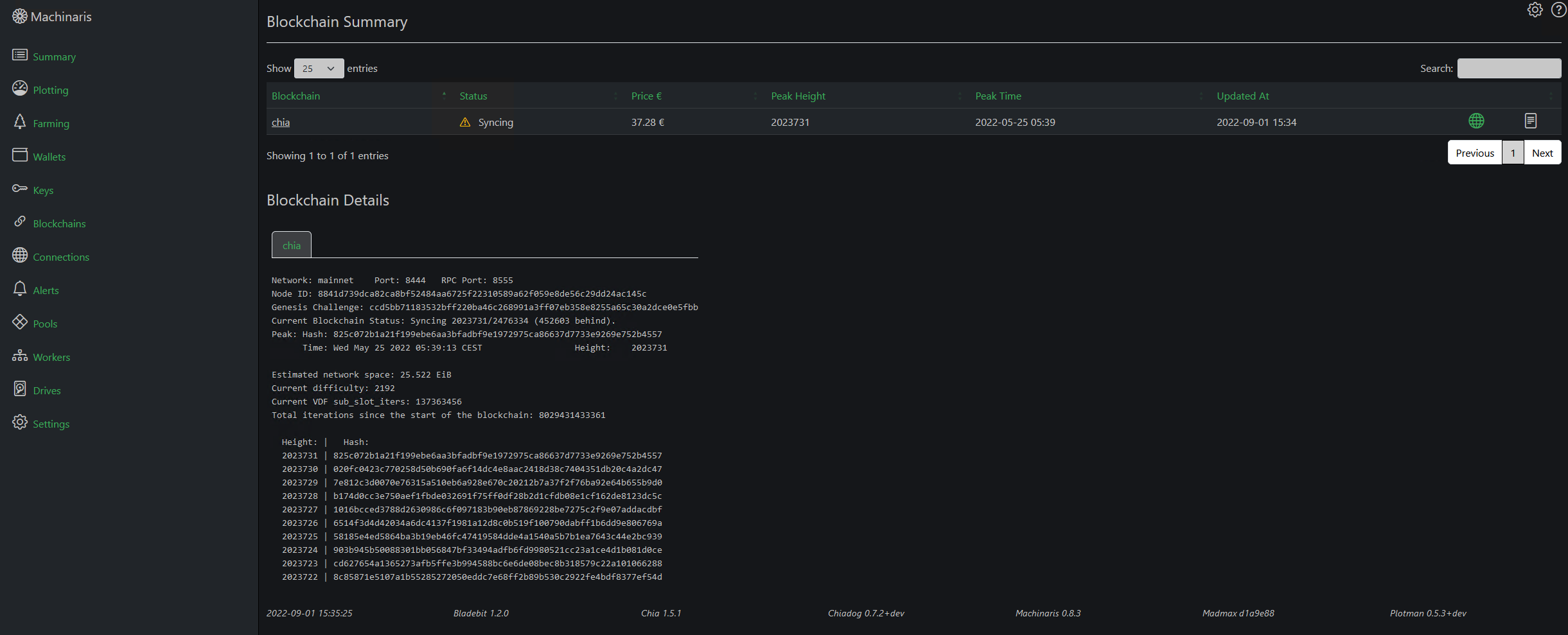

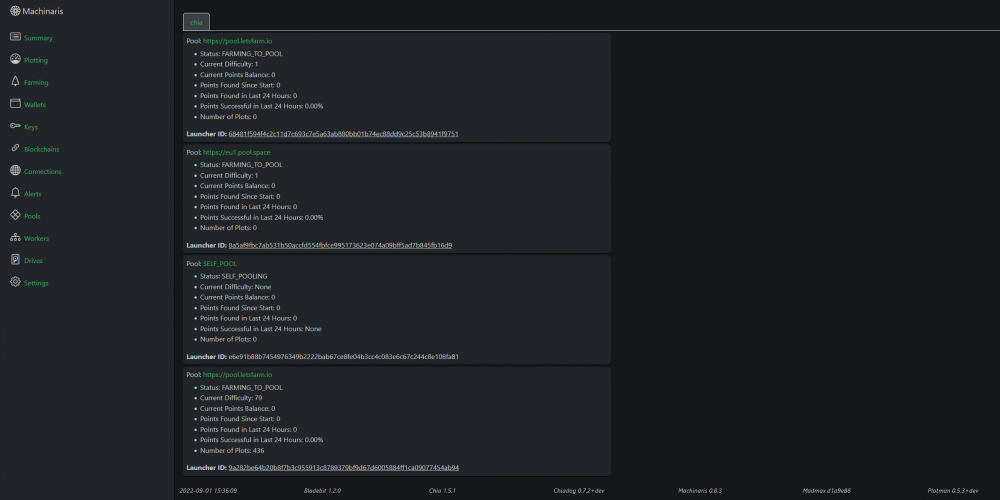

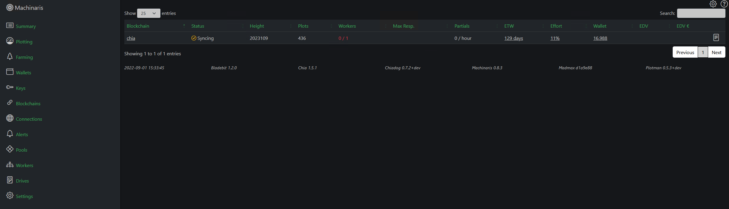

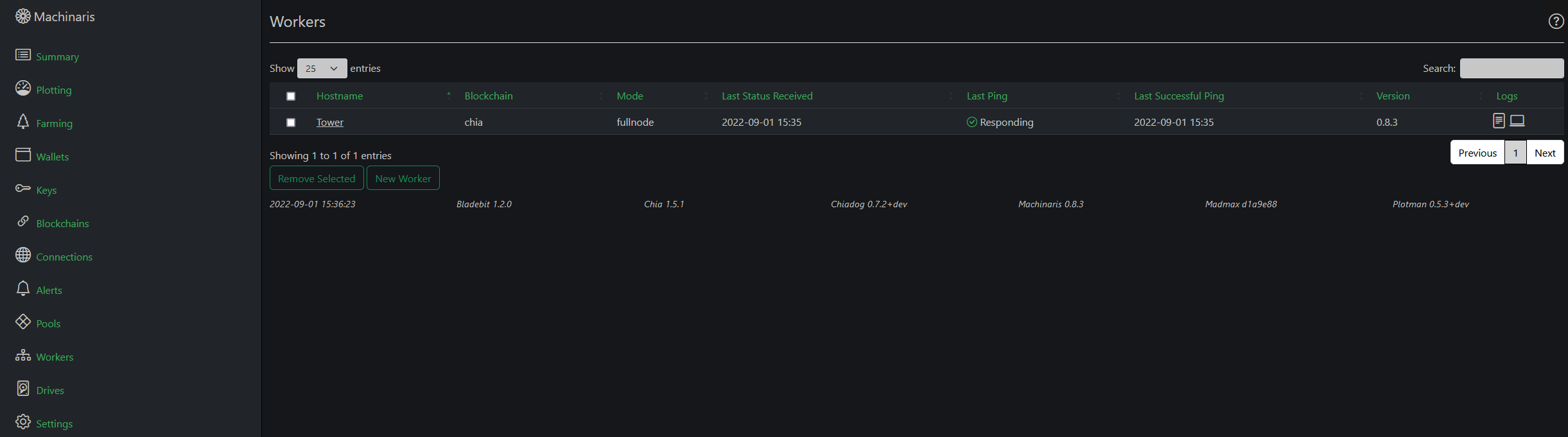

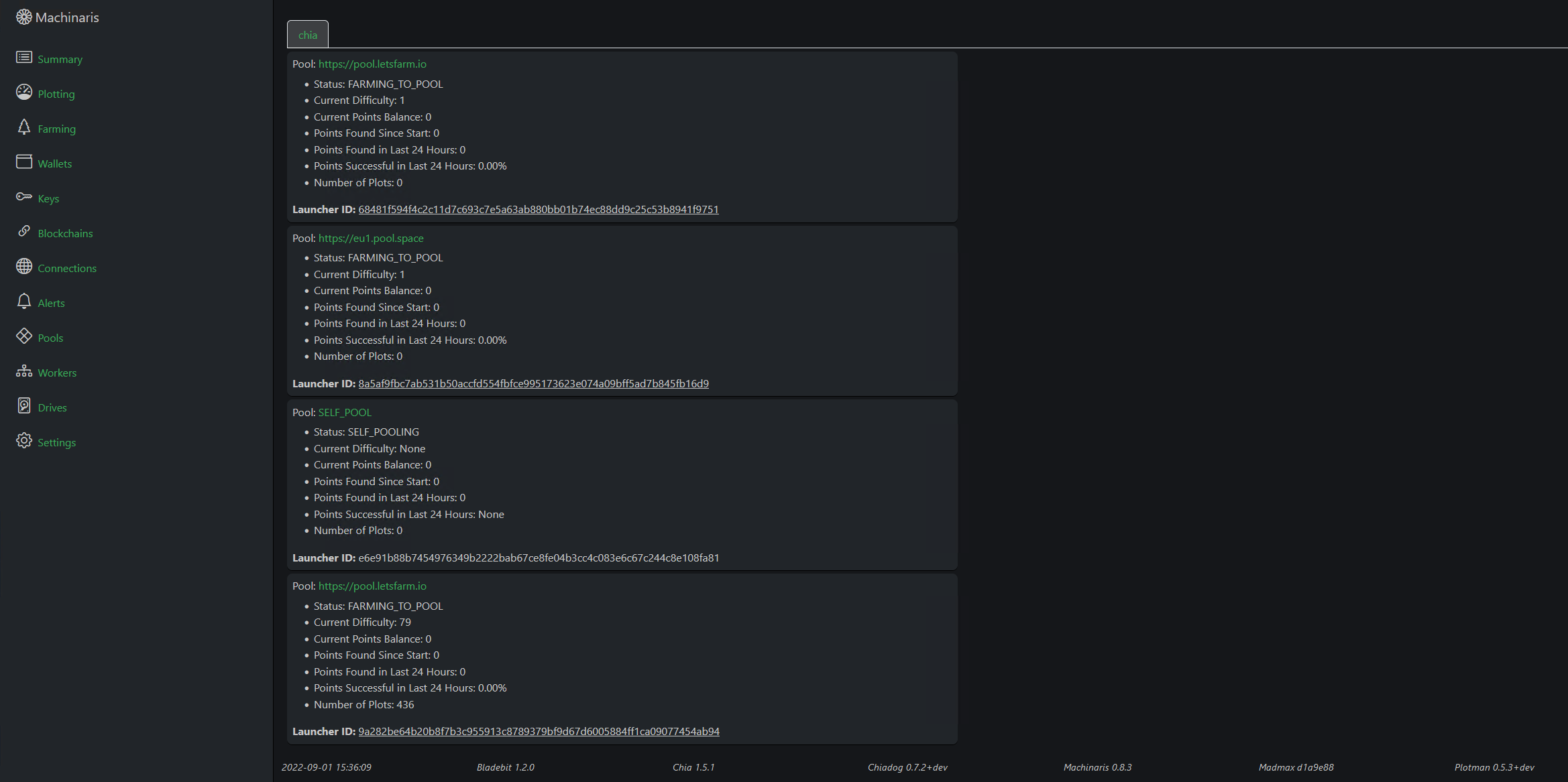

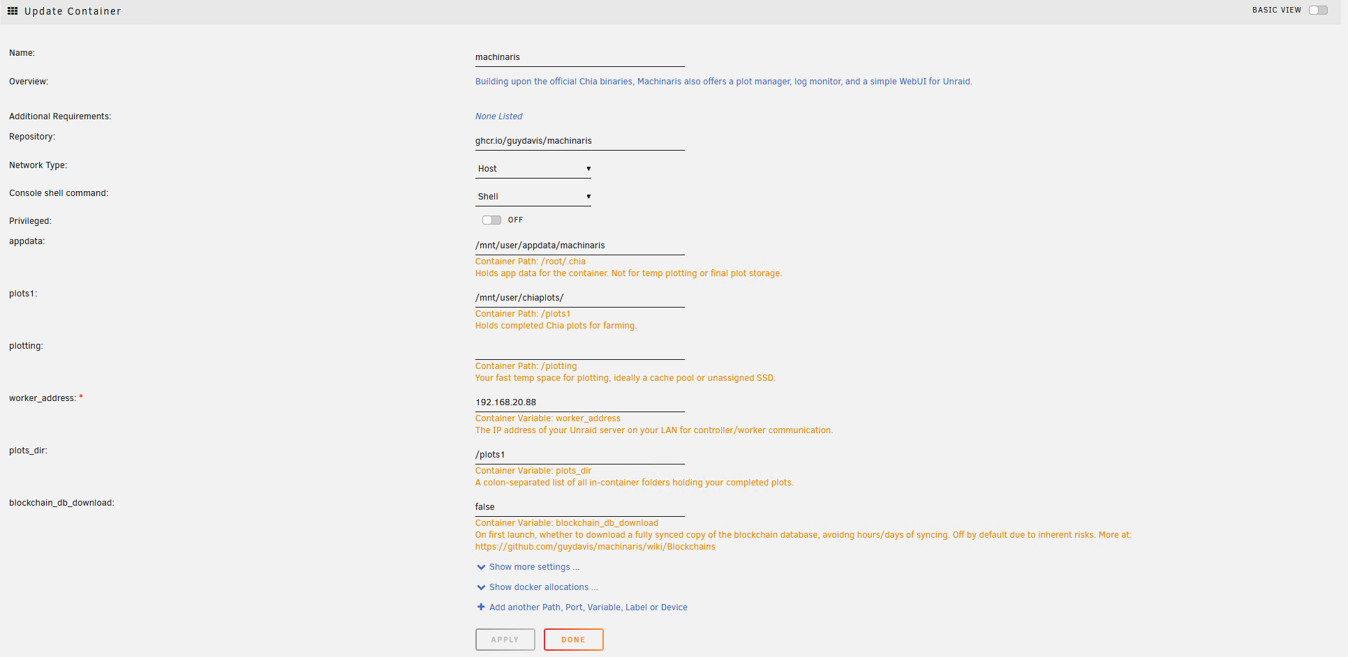

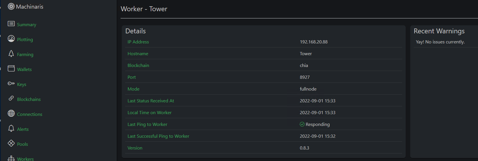

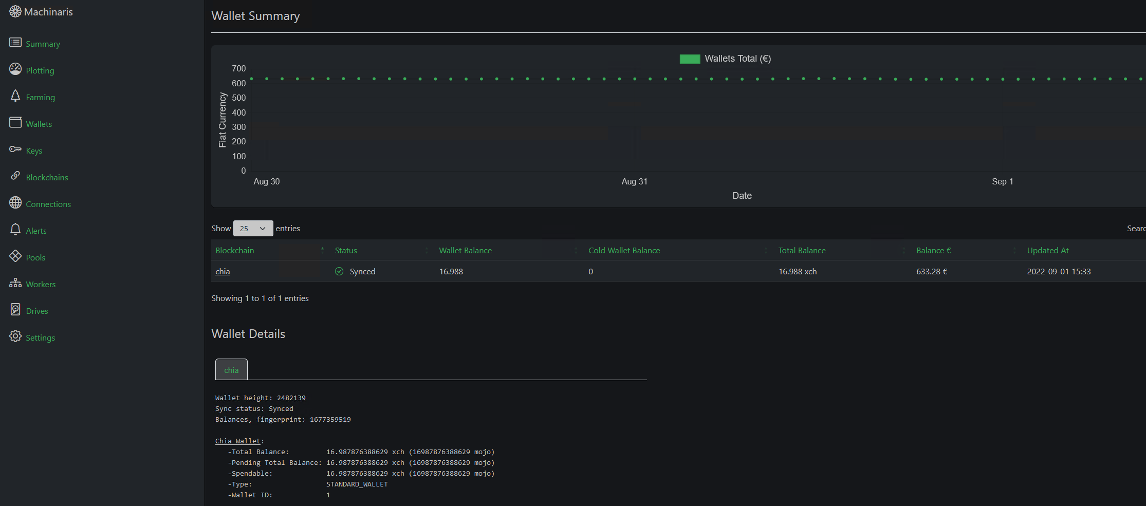

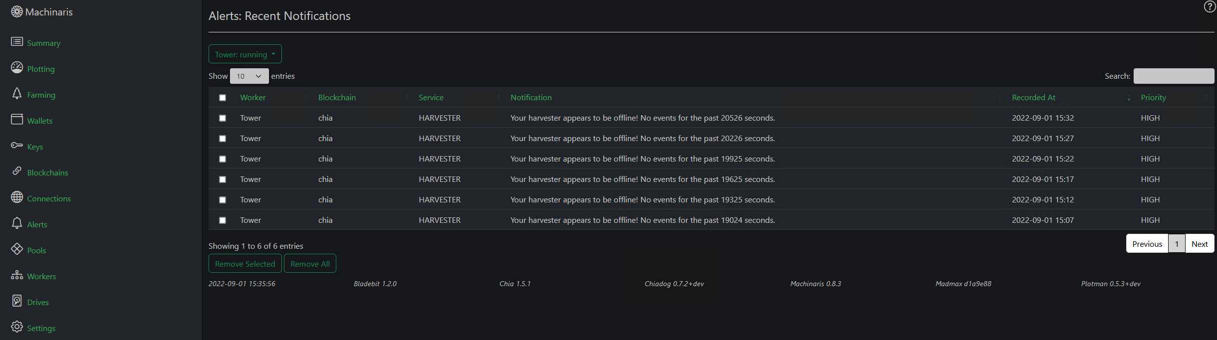

First - thanks for the docker, i tried to move my installation to an unraid setup to be more flexible, so i am copying 24 disks step by step. Machinaris was installed some days ago and sync is nearly done, wallet is already finished. But somehow the plots are recognized, the pool connection is back alive as before, but it is not farming. Harvester appears to be offline.
9.thumb.PNG.ac180a89b81235078d03bda6a7e86909.PNG8.thumb.PNG.10e7ff0314e7b29973dc48d3a8051832.PNG7.thumb.PNG.b18c59a6da642afb54d8ab3d09b590c2.PNG6.thumb.PNG.31396c7326d933982a766334b12a7923.PNG5.thumb.PNG.6201c64384f3eff170b35b2cee6ecf1c.PNG4.thumb.PNG.cb0f75e1fb9a5860573d64e4b7388983.PNG3.thumb.PNG.81eff097fdff8a8ea8097937ecb243a2.PNG2.thumb.PNG.fd6703b10a112d91043770fa37602447.PNG1.thumb.PNG.3d8d6462f359e8ee8929df91922d990a.PNG
7.thumb.PNG.b18c59a6da642afb54d8ab3d09b590c2.PNG5.thumb.PNG.6201c64384f3eff170b35b2cee6ecf1c.PNG
Hi, welcome to Machinaris!  Everything looks good, however your Chia fullnode is still syncing the blockchain.  From your screenshot, the peak height of the blockchain is back in May of this year.  Hopefully, the fullnode progresses quickly to the current time.  At that point, your fullnode will start farming and you will no longer receive "Harvester offline" alerts.  Hope this helps!
