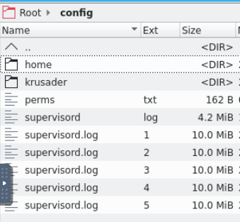

Squid told me, in Krusader "The only thing Unraid related is /media, /UNASSIGNED, /FLASH, /config".
I think I should not touch UNASSIGNED or FLASH.
In config I see this, should I delete it all?

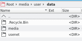

In media/user/  I have all my shares, but the only share that gave me the trouble described in this subject was the "data" share with all my movies and tv shows in the "media" folder you see here:
So can I delete it from Krusader, or should I delete it from Unraid Web UI for Shares?  Which way deletes it most completely, so it does not leave config remnants or other hidden remnants, if any?
