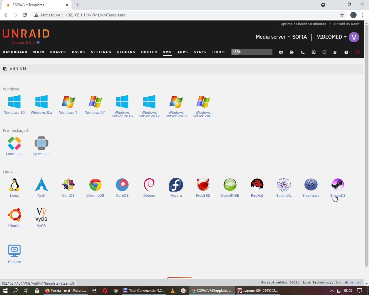

I'm really new to UNRAID.
Can you please tell me exactly what to do?
I used TAB VMS
ADD VM
CUSTOM
I typed the code into the XML window

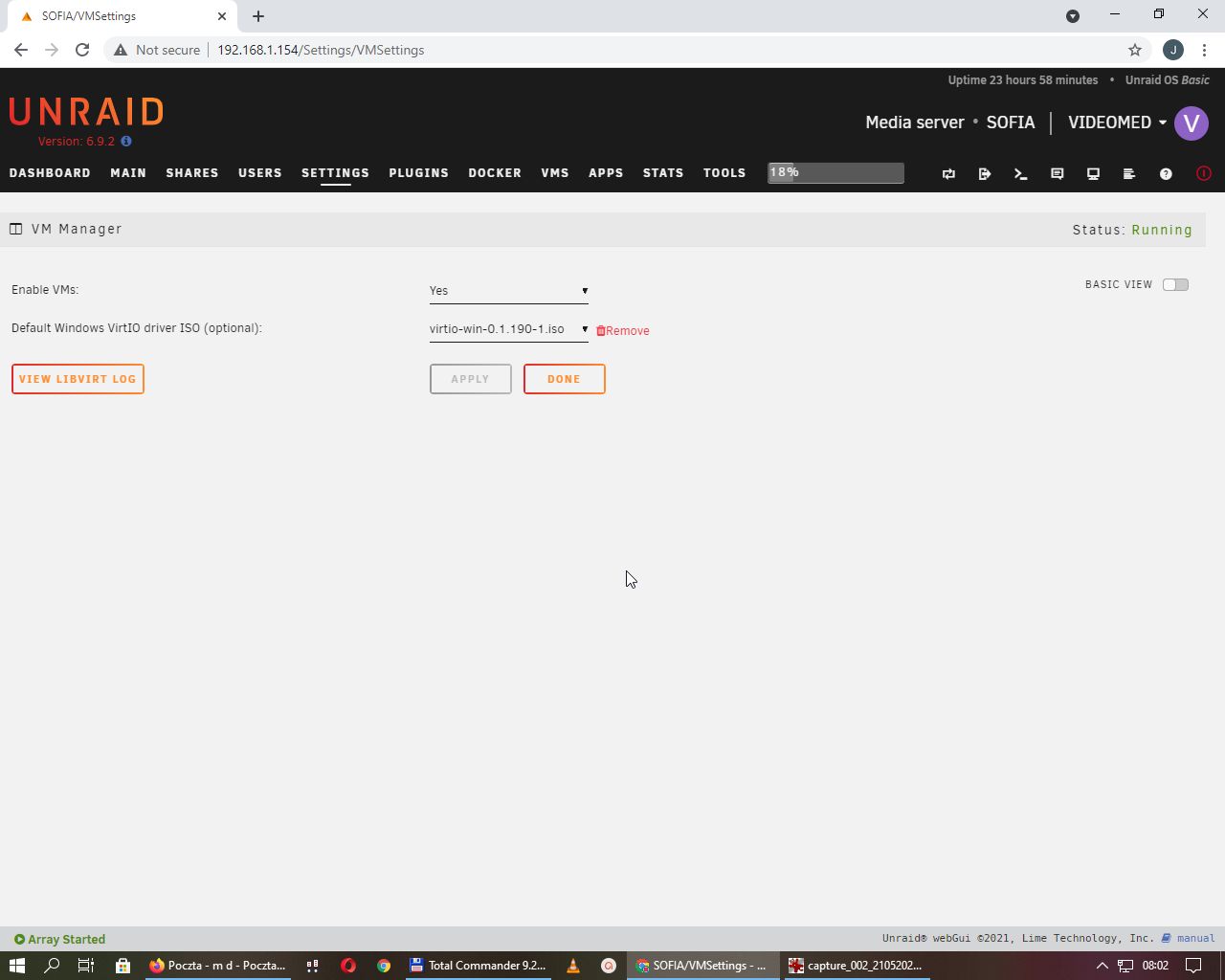

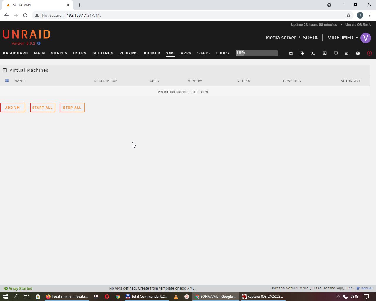

As I already wrote, I do not have a VM installed
my server screenshots are attached.
Please help me on how to move VM to UnRAID.
Ok, try to follow this video, from minute 7:34 to 10:50
Choose the Linux or Ubuntu template instead of windows 10
Do not set the OS install cdrom
Choose VNC as graphics
Do not select a sound card (none), or select the onboard audio (do not choose hdmi audio)
Do not check any usb device
Uncheck start vm after creation
Click create

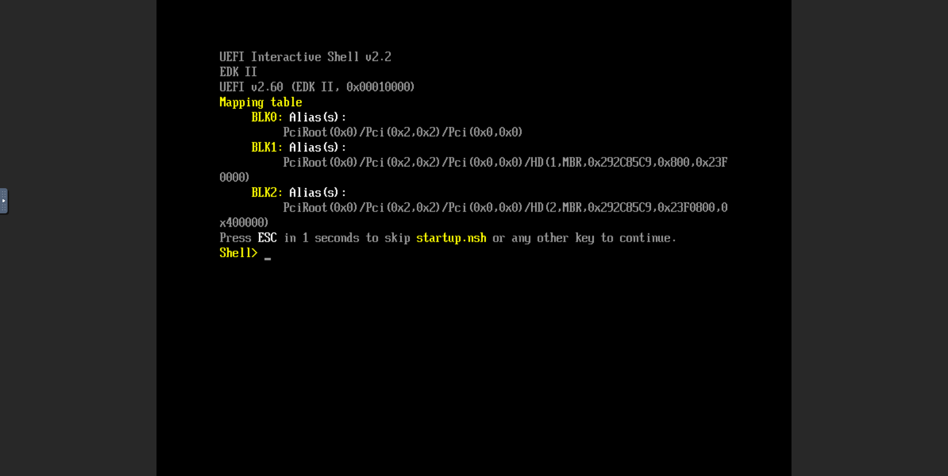

I modified the xml file but the machine does not start
My bad I didn't paste the link to the video...anyway happy to see that you found the xml.
Try to create a new vm, but this time choose i440fx instead of q35 and seabios instead of ovmf.
Or q35 + seabios.
Then open again the new xml and modify the disk section as you did before.
I cannot see the EFI partition in your screenshot of the uefi shell, so maybe the legacy bios seabios can boot that disk.
Edited by ghost82
