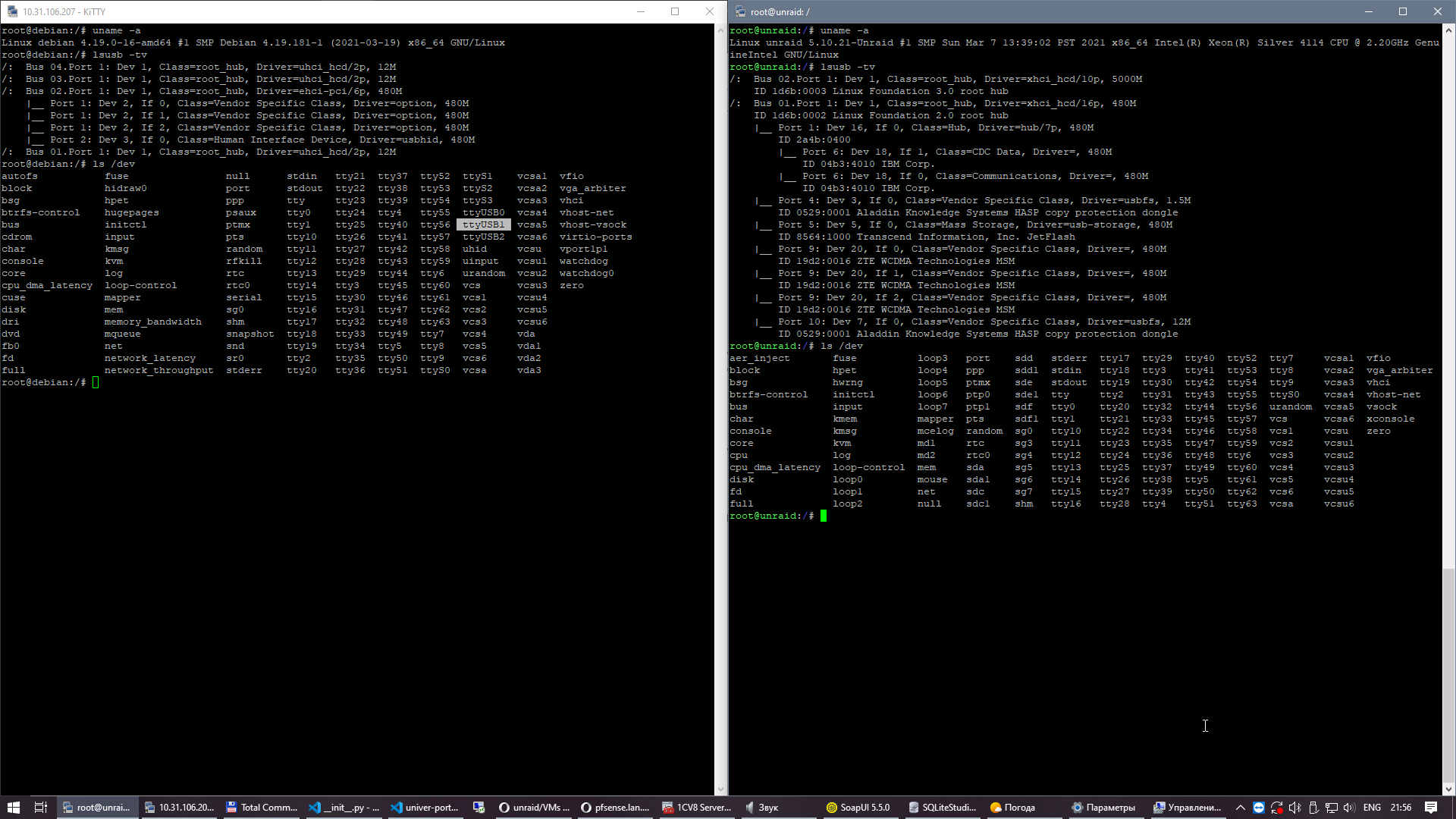

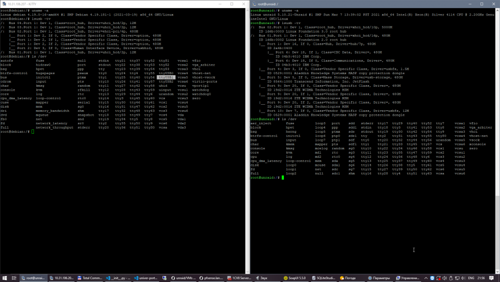

May 19, 20215 yr Author 2 hours ago, SimonF said: Do you not get a ttyacm0 or similar in /dev/ Exactly. Look at the attached screenshot. Left side - fresh install of Debian VM running inside Unraid with forwarded USB modem. Right side - bare Unraid (Debian VM is shutdown). On the left side modem is detected and I can use it with "screen /dev/usbTTY1" ATI Manufacturer: ZTE CORPORATION Model: MF180 Revision: BD_P671A1V1.0.3B12 IMEI: *************** +GCAP: +CGSM,+FCLASS,+DS OK On the right side I do not have any usbTTY, ttyacm0 or anything similar. As you can see it have "Driver=option" on the left and "Driver=" on the right Edited May 19, 20215 yr by WhiteAls
May 19, 20215 yr Looks like the kernel needs the following for that device. CONFIG_PCI CONFIG_USB CONFIG_USB_SERIAL CONFIG_USB_SERIAL_OPTION Current Unraid Compile option is root@Tower:/usr/src/linux-5.10.21-Unraid# cat .config | grep USB_SERIAL_OPTION # CONFIG_USB_SERIAL_OPTION is not set It may be that creates a module that could be created as a plugin.
