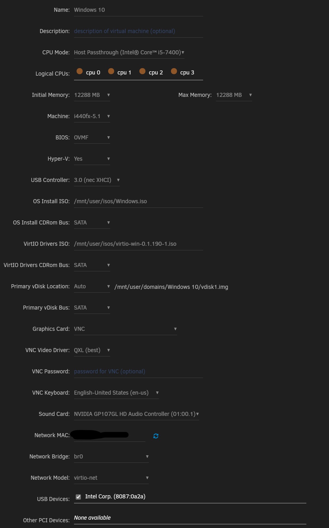

I've got a GTX 1050Ti in my server, and I've remotely installed a Windows 10 VM on it. I can VNC into it just fine, however it doesn't detect my GPU in Device Manager at all. Under 'Display Adapters', it only shows 'Red Hat QXL Controller'.
It seems this is actively preventing me from logging in via Parsec, because it gives me an error saying something like 'rendering failed on host machine'.
When I try to download and install the Nvidia drivers, it says 'the graphics driver could not find compatible graphics hardware'.
The way I understand it, is that by selecting the GPU in the VM settings, it means I'm choosing to physically pass through the signal through HDMI to a monitor - but I don't want to do this. I only want to access the machine remotely through Parsec or Steam. FYI, I also use the GPU as a transcoder for my Plex docker, so I want both the VM and Unraid to be able to access it.
I've attached my VM config. Any help?

Anyway, for your case, you are not passing through the video gpu so the os cannot see it; strange that it let you to boot with the only audio part passed through.
For the other question from skot4th you cannot use gpu and vnc in the same setup (through libvirt); set a gpu passthrough and install vnc in the guest.
How can a guest os use a gpu if it's not attached to it?
If you don't want to use the gpu with a monitor attached pass through the gpu and use a dummy plug.
Edited by ghost82

Consider libvirt the same as unraid, when you create a vm do not set vnc, but do a gpu passthrough (to passthrough the gpu you need to set both the video part and the hdmi audio part (which you are already passing through) ; once you boot with a monitor attached to it, download the vnc server installer and install it into the guest (the guest is your virtual machine, windows 10 or any other os).
A dummi plug is something like a usb pendrive, but instead of having a usb connector it has an hdmi connector, or dp, or vga: search "hdmi dummy plug" on google to find some images.
This device will allow your os to detect the gpu even if there is no real monitor attached: the device is in fact a monitor emulator, so you can have all the benefits of the gpu without attaching a monitor.
Once you have your dummi plug attached to the gpu and the vnc server installed, you can detach your monitor, and vnc to that virtual machine, which will have video acceleration now, because the os can now see the gpu.
Edited by ghost82

OHH! So you mean to install the VNC server in Windows, not Unraid?
And to pass through the GPU to the dummy plug, I'll need to have a real monitor connected first?
yes
Yes let's say it is, in real you are passing through the gpu to your virtual machine, not the dummy plug, anyway I think you understood.
Yes, you need a monitor only for the setup, or maybe you can install with vnc server set in unraid, download and install the vnc server in windows, shutdown the virtual machine, modify the video of the virtual machine from vnc to gpu (video and audio) passthrough, attach the hdmi (or whatever plug you need) dummy plug, and connect via vnc and install the video drivers.
Anyway, I would consider to have a monitor in case of troubles during setup.
One more thing, I don't think this can be done, at least use the same gpu at the same time by unraid and the vm: once the gpu is passed through to a vm, it's like the host (unraid) doesn't see it anymore.
Moreover, I would not assign all the 4 cores to the vm: your cpu has 4 cores, but unraid needs some power to run the vm, in this case I would assign 2 cores for the vm.
Edited by ghost82
Can I run a separate GPU for Plex?
Sure
