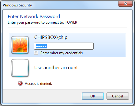

I created a shared folder and assigned it "private" level security.  I created a user (name and PW all lower case, no special chars) and gave that user read/write permission.  When trying to access the share from a Win7 machine, I get a request for credentials.  I enter the correct name/PW, but am denied access.  I have triple-checked my spelling.  Any thoughts?
Using unraid pro 5.0b4.  Win7 "access denied" login window attached.  Relevant section of log below.

Between rebooting the server and rebooting the desktop for other reasons, it now works.  Don't know which did the trick.
